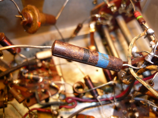

There are so far no caps mounted under the cans that I've found. cleaned the am/fm switch no change, still intermittent. I've added a picture of a resistor for Id it reads 6 ohms I think it should be 60? Baffled because the fm works great. I will check out more cans Friday.

Am I right on the resistor above? there is no listing for a 6 ohm in the parts list?
