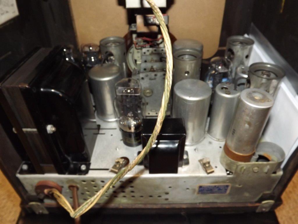

Hey Jamie, do you have a higher res version of the 118 under-chassis photo? I am working on the same chassis and it would be useful as a reference of a relatively untouched original.
Sure do. ... I am afraid to post a full sized image here because it messes up the forum. How can I get it to you?, .. If you need close ups of certain areas, let me know. So far, all I've done to mine is replace the electrolytic caps and stuffed two bakelite blocks.

The chassis is exceptionally clean. There are eleven bakelite blocks (if I counted correctly), a bypass can with 4 caps in it, and three electrolytics in two cans. Not a terrible job, but not easy either. All of the tubes, with the exception of the 80, seem to be original Philco tubes and they all tested better than good.
So far, I've cleaned and lubricated all of the normal stuff. Tested tubes. Replaced electrolytics and restuffed two blocks. I've got the bypass can disconnected and I'm trying to decide if I will restuff it, or replace it with a terminal strip. It will need some new rubber under the tuning cap and on the corners of the chassis. Hopefully the shadowmeter coil is good. We will see, and I will keep everyone updated. Icon_thumbup

Just a little update... I finally got through all of the capacitors and resistors... She's singing like a bird!!!! Icon_biggrin
I've got an issue with the volume control, as it is still a little scratchy and cuts out at low volume. I think I need to clean it up a little.
The GREAT news is the shadow meter!! It worked like a champ as soon as I fired up the set!!.. All I had to do was adjust the light bulb clamp a little to center the shadow!!! Icon_thumbup How is that for luck??
With a little more work, I will have the chassis back in the cabinet. It sure does sound sweet. This thing is LOUD too!

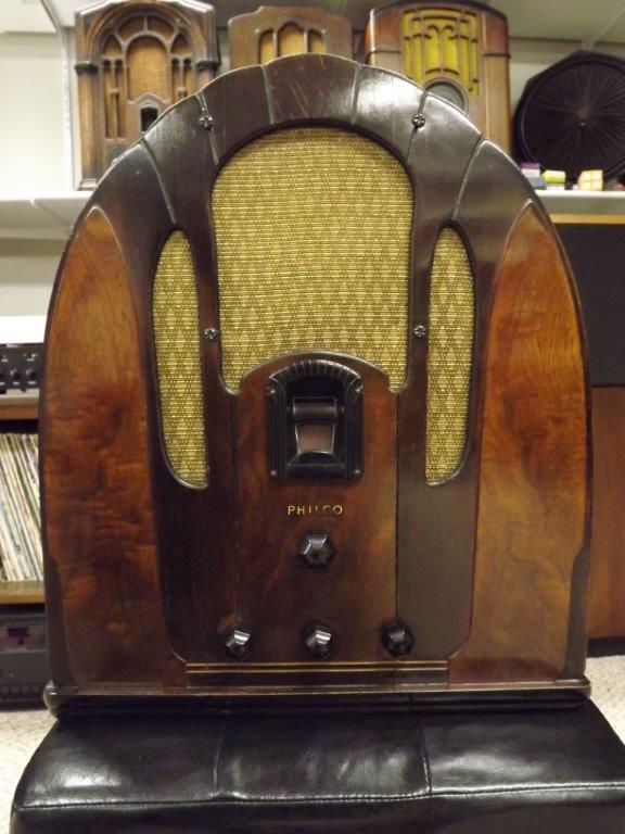

I received a 118 cathedral for Christmas and finished the chassis a few days ago and must say this is a fantastic radio that is very sensitive and has excellent sound quality, with out a doubt one of the nicer radio's I have. If I can figure out how to post a picture I will as the cabinet is in great condition as well.

OK, just having supper and then I will go take a couple pics and give it a try. Mine is all back together so will try to get a clear shot of the chassis. Sadly on the chassis one of the original filter caps is missing but as soon as I get a chance to go to my storage locker I think I have some that will do the trick.
Gregb
OK, here are the pics I HOPE.
Gregb
Wow! What a nice radio! I think yours might even be cleaner than mine.
I don't know about that, the 118MX looks pretty sweet as well and I would be proud to have it my collection.
