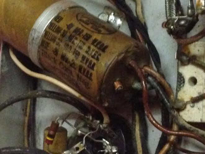

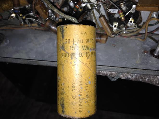

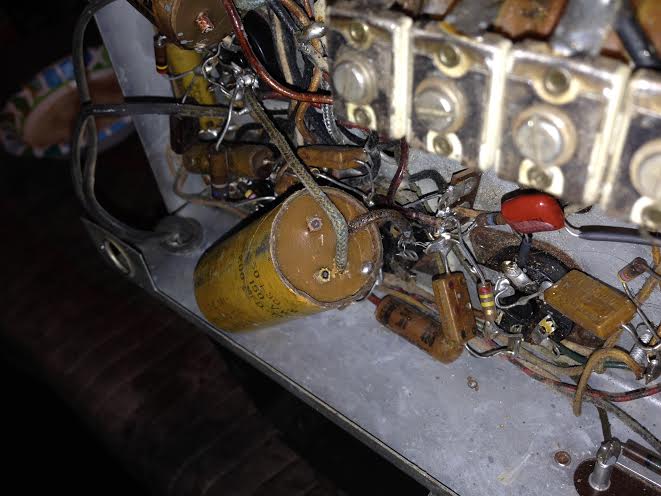

I am working on the electrolytics of my halli S-38.
There is one ecap that is 5 leads with red 40 yel 30 yel 30 blue 20 and blk neg?
The piece was obviously changed and one wire is cut off so only 4 go somewhere. I got 4 caps to replace them but:
where do they go?
The other one is a 50+30 with 4 leads but again 2 leads are cut off so I got an 80 but which goes where?
Is only 50 being used? or only 30?
And what is the 200 mfd 15vw at the bottom?
Is that another ecap?
Im not sure since it does not match the schematics.
Schematics here:
http://www.nostalgiaair.org/PagesByModel...008862.pdf
Here are pics:

Hi Kirk:
If you look in the parts list they have provided with the schematic it shows a four section cap for C29,C31,C32, and C33 which is the e-cap your are trying to replace. It also tells you which value goes in each position. Once you have that figured then we will try connecting it up.
Gregb
Posts: 4,106
Threads: 310
Joined: Nov 2013
City: Kings Park NY
Ok so here are the lead connections for the 40 30 30 20:
Red goes to a terminal strip
green goes to pin 5 of 35L6 (could be the blue wire?)
orange goes to pin 4 of 35L6(could be the yellow wire?)
Blk goes to another terminal strip
Other Orange or yellow is cut off
As for the 50+30:
Blk? with orange in it goes to same terminal strip as red 40
green goes to pin 4 of 35z5
Last 2 leads are cut off.
I cant follow the lines of the schematic sooooo.....
