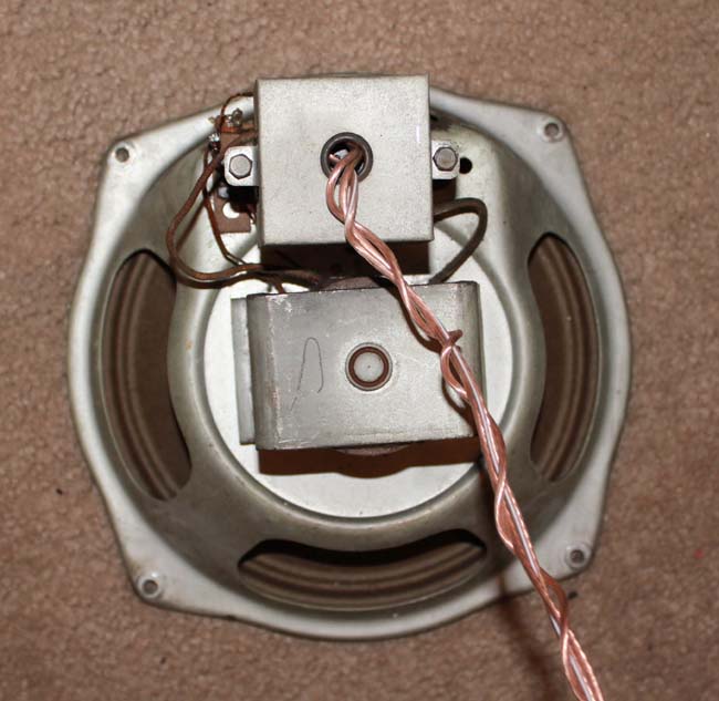

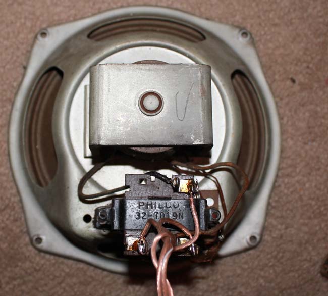

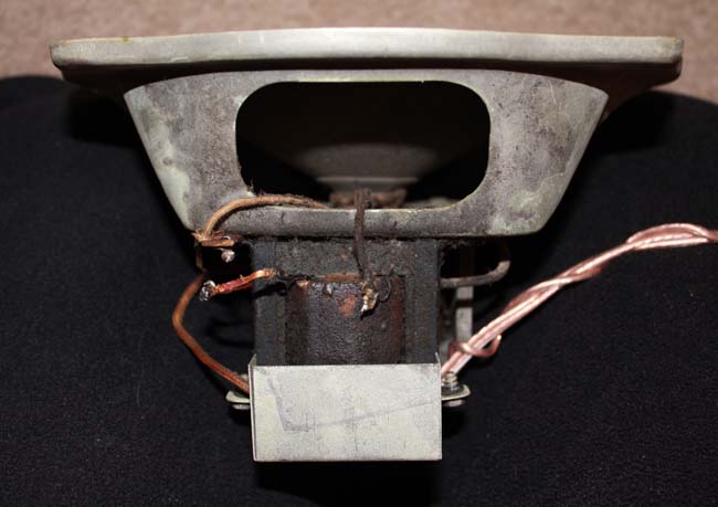

The speaker in the radio is the speaker that came in it when I purchased it. I do not know if it is the original speaker though. How would I know if it has a hum bucking coil? What do I look for? I can post a photo of the back of the speaker if needed. It looks like a typical 1930's Philco speaker. I can't see a part number on it.
(This post was last modified: 01-27-2014, 07:00 PM by Jamie.)
Yes, do post the photos, and look for extra wires coming out of field coil or a turn of wire going around the field coil or somewhere around the field coil central post or even better, see if the output of the audio transformer solder DIRECTLY to the voice coil or there is an extra solder lug or anything that one of the transformer's output first go to and only THEN goes to teh second lug of the voice coil.

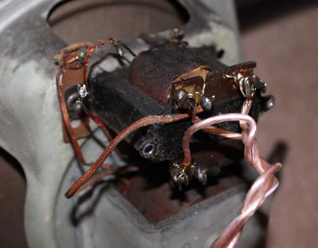

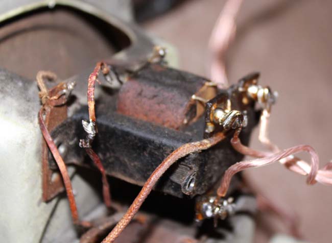

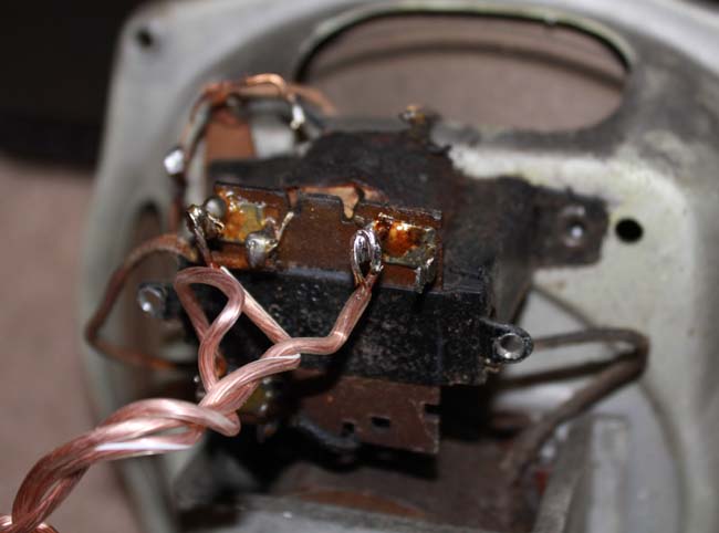

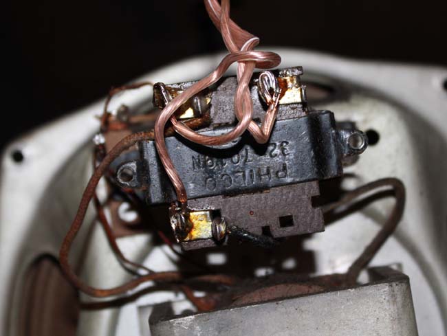

This speaker had an accessory pillow speaker attached when I bought this radio. I removed it, and soldered the leads together. I just mention this to explain the repaired wiring...
There is a part number on the transformer and it matches the number on the schematic parts list, which makes me think this is the original speaker for the radio.
The pics #2 and 4 seem to suggest there is a hum-bucking coil there.
If you look at the #4 you will see how the left output of the transformer (seems to be a piece of copper mesh or wire that attaches to the transformer output's black wire) instead of going directly to the voice coil contact (the solder post) goes inside the field coil, and then returns to solder to the voice coil (the mentioned solder post's pin).
This is the hum bucking coil.
Actually the very last picture in the second post (pic #7) also shows it well.

Those two flat looking wires going to the underside of the field coil are the hum buck leads.

Ok, so... any suggestions? I am planning to swap the speaker wires, but decided to first wait and see what you guys say.
Which speaker wires?
Does the bucking coil soldering to the voice coil look original or was it changed?
You could try to reverse the bucking coil's ends, see if it exacerbate the hum or reduces it.

Earlier in this thread, Raliegh suggested reversing the speaker leads. I hadn't decided which ones to reverse, I was going to look at the schematic and try to figure it out before attempting it.
All of the soldering on the speaker looks original, except for the place where I removed a switch. Someone had added a pillow speaker to the radio. They also added a switch by cutting a wire in the original speaker (I think this is the hum bucking wire?). It looked like the pillow speaker was always active, but you could switch on/off the original speaker. I removed the switch and soldered the wire back together.
The repair is circled in red..
