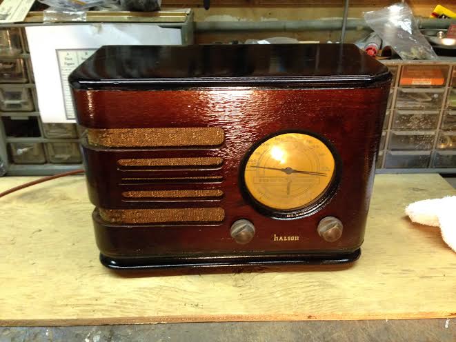

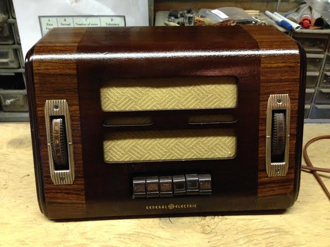

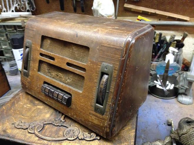

OldRestorer, I'm by no means a expert particularly on finish. Yours look great other than the small radio which appears to be in need of grain filler. In general the toning on your radios don't seem to match color wise with the "before". I recognize that they may not have been original finishes or may have darkened in some cases over time. Pictures and lighting will change things. Specifically the Philco 84 seems very dark compared to the before. Again, I don't know squat but you asked for opinions. The console looks very nice but then again, maybe a little "light". No toner? Nice finish and looks great.

Yes the 84 is actually lighter but the pic was dark. I did not go by the original finishes 100%. I used online comparisons to figure out the best finish to match the factory. The 640 is toned perfect brown and medium walnut. the flash may have made it look lighter but I honestly don't remember what it looks like since it is at the other house. I had to go darker on the Halson due to the multiple veneer repairs and water stains on the cabinet. I really wish I had grain filled the front but live and learn. As for the zenith, I hate light walnut, lol

What do you use for grain filler and where do you get it? I recently reworked a Farnsworth and I'm not overly happy with the cabinet work due to all of the grain 'divots'. Will probably end up re-doing that at some point, but need to know where to get the right stuff for the job.

I think he uses Mohawk grain filler. I have also heard constantine's grain filler is good too.

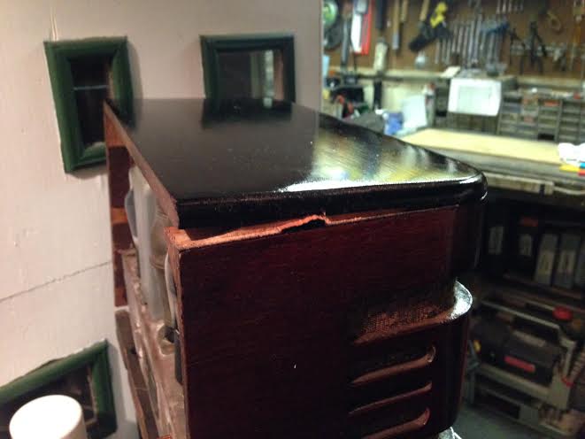

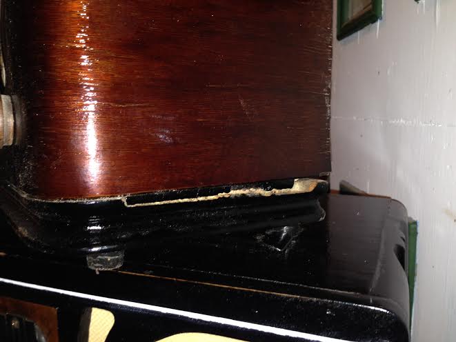

Well, With it falling and breaking right after I put it all back together I will re strip and grain fill.
Ugh......almost hurts to look at it.

The GE sides match the middle strip and look very nice. the Halson picture was right before it fell so When i am done stripping, gluing, grain filling, retoning, adding new decal and clearing I will repost.
