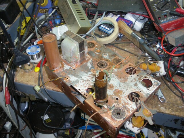

The electrolysis process only uses baking or washing soda. It is my favorite method for derusting engine blocks and such. I did strip some painted sheet metal and the paint peeled off in sheets.

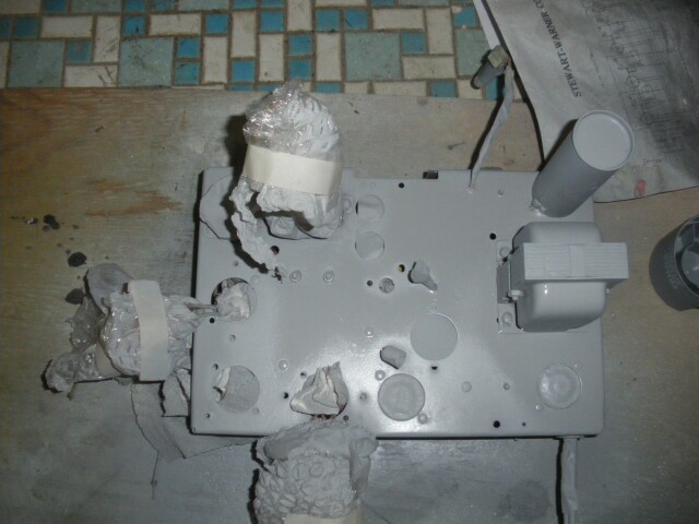

I've gotten about as much of the old paint off as I can. Tomorrow: sanding.
I removed the tuner and two of the tube sockets/shield bases. I couldn't remove the LO coil because the connector wanted to spin when I tried to remove the nut.
Much of what is still visible in the pic is the old hammertone that was under all that ugly carp.
After sanding/masking, I should be able to lay the first coat of primer. I'll leave that to set overnight, and likely until Sunday evening before applying the second coat and then the stainless steel topcoats. I'll try to post pics of each stage.
I also fired up my new ultrasonic cleaner for the first time. I soaked the tuner and several miscellaneous nuts and washers. Nothing got what you would call clean and shiny, but it did do wonders for the operation of the tuner (I had no idea that had a reduction gear!).

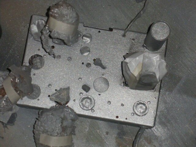

Changed my painting schedule a bit, because the primer dried pretty fast.
Here is the last pic before laying the primer.
First of two coats of primer.
After primer, I painted the transformer shell black. A bit of overspray, but I figured that the stainless steel paint would cover that up. Not quite...
I'll likely leave this to set overnight, and most of tomorrow, before starting to reassemble the set.

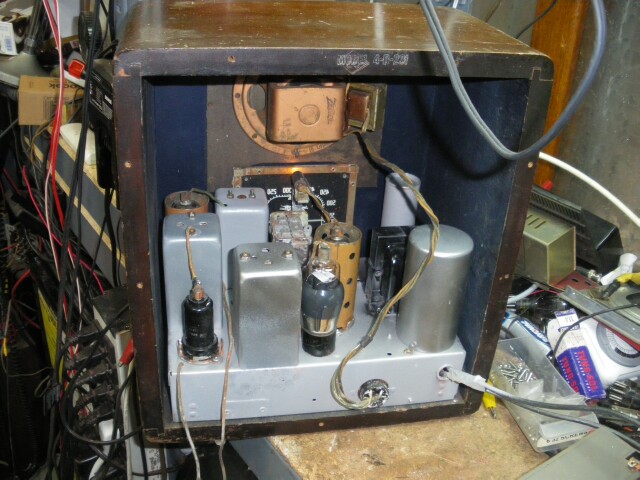

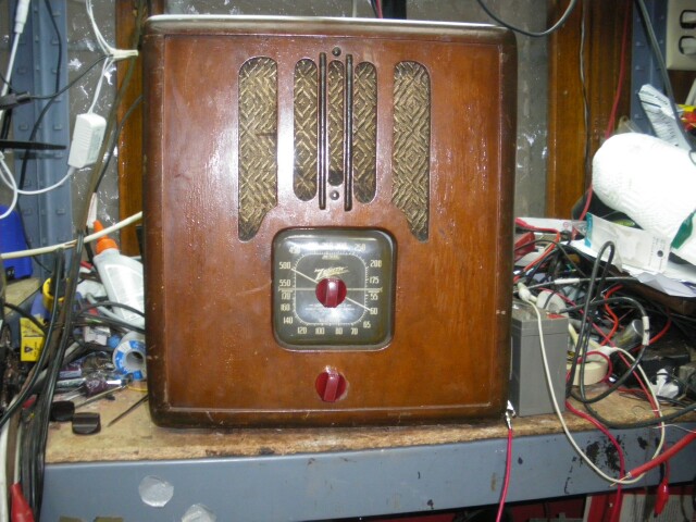

Well, it's finished, at least very very close. The chassis is done, and reassembled. Amazingly, I didn't even have to realign it, everything was still perfect. I'm very happy.
Only thing I still need to deal with is that the insert on one of the original Zenith knobs got lost somehow. I have these that are the very same knob, but a different color. (Unless, of course, the ones on the radio weren't originals, either). Ah, I just found repros of the proper knobs at Renovated Radios, and ordered them.
As I said, I'm not sure I'll bother with redoing the cabinet. It's got some minor blemishes, but not bad.
