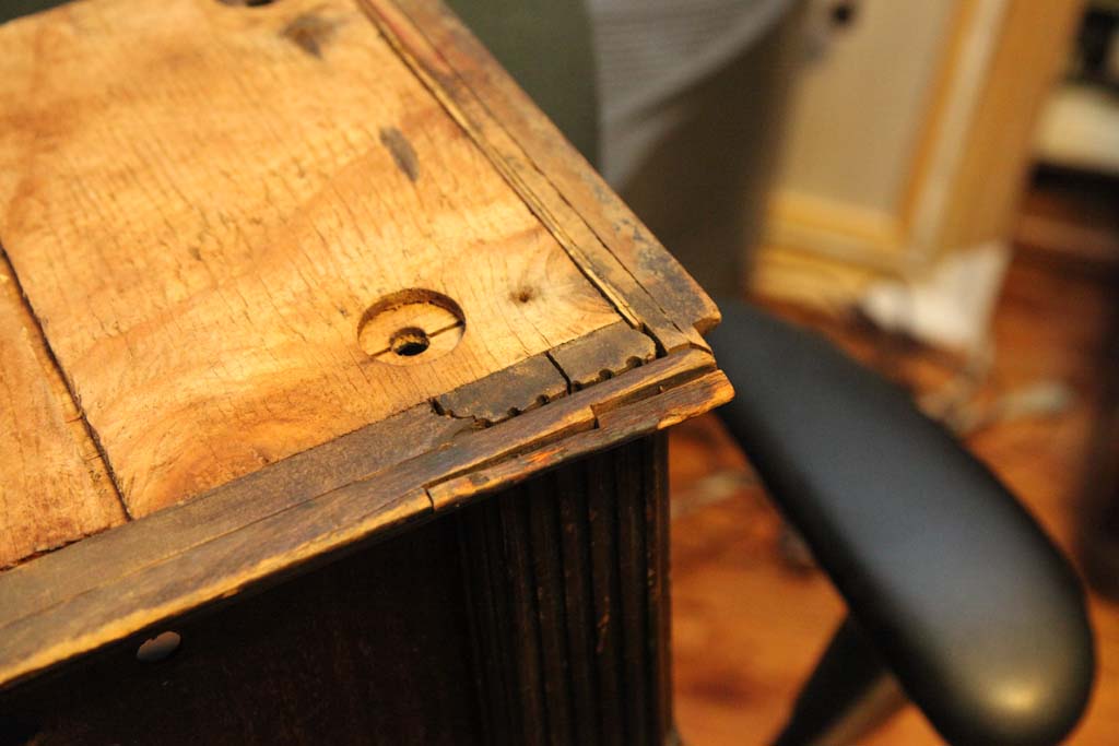

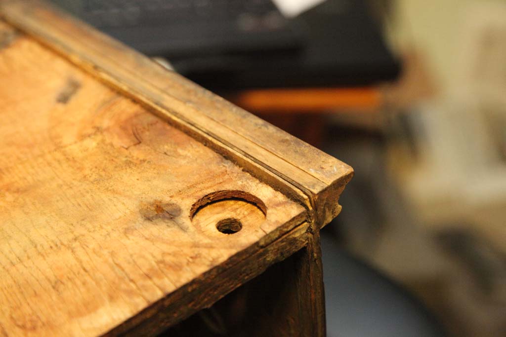

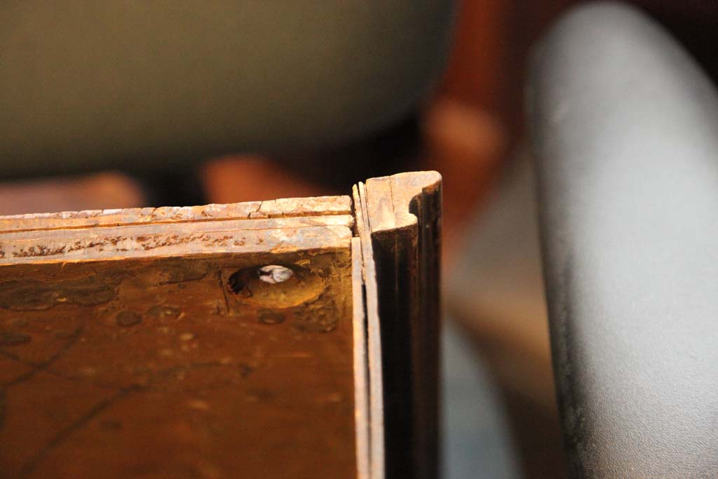

There is something asymmetrical about the sides of the cabinet at the bottom.
The photos of the bottom are taken with the very bottom sheet taken off after I removed the tacks - there was no glue.
Notice the inner side lining sheet well-aligned on this side of the cabinet.
Not so aligned here - goes in between the outer siding and the base.
So it gets closer to the bottom.
As the result the bottom is inclined on this side.
Whereas on the other it is leveled.
So before I glue anything I'd like to understand how to even it out.
I tried to apply an effort to pull the bottom down and to release that inner side sheet - no, it wouldn't move, Any stronger effort I felt would just rip the bottom out. Could it be someone tended to the cabinet and glued and tacked everything this way?

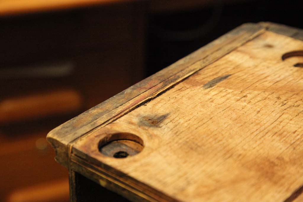

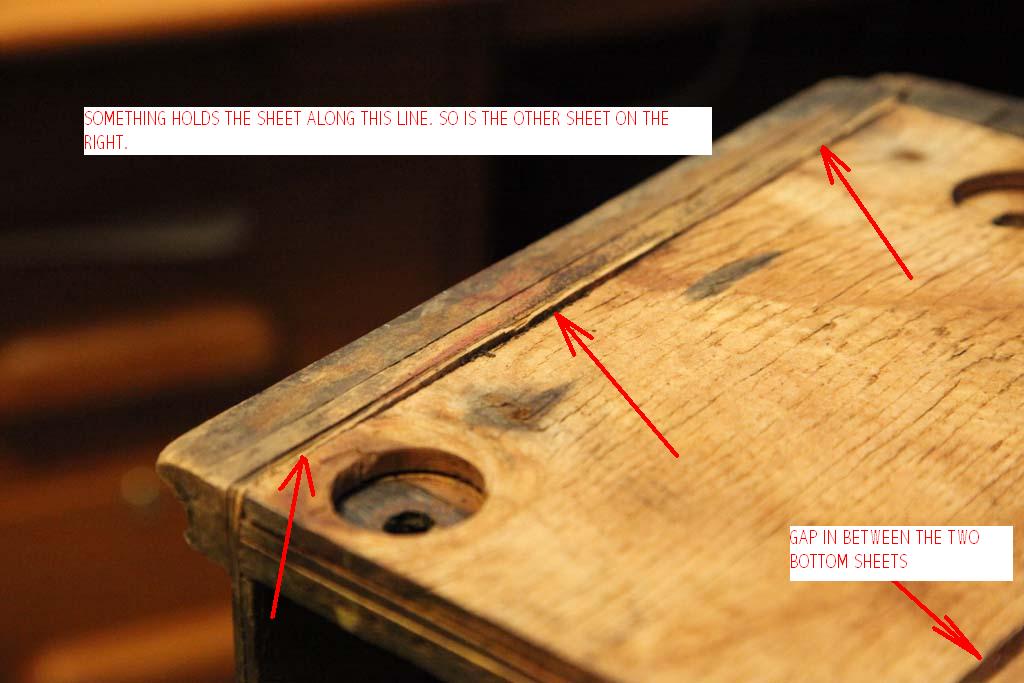

Also the bottom sheets you see on the last two photos, they do not have any glue holding them in between them and the base either. However at the edges something holds these two sheets (the bottom sheet left now is two pieces, you could kinda see a part of the gap between them on the last photo at the right bottom corner) and does not let them just come off and reveal the base.
On your first picture is obviously the way both sides should be. The other side needs taken off and put back just like the first picture. It looks like the 2nd side was warped from the bottom getting pushed in to far. That is one reason why I thought you ight want to take the bottom off completely and straighten it out all by itself , then when you put it back in you can get it in the right position on both sides. If you dont see any nails/staples holding it in then it must be glued somehow. I think I would try prying apart very slowly and carefully until you can tell for sure how it is connected together. Is there a channel that the bottom is sliding into? I cant tell.

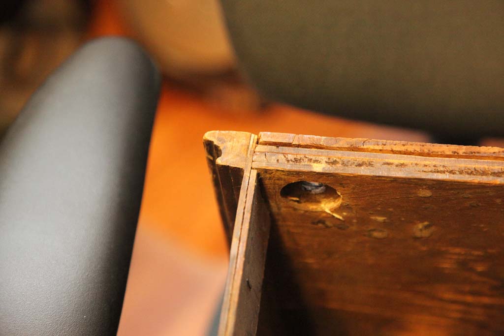

There are nails under the trim molding, which extend through the side into the bottom panel. To remove the nails, you have to remove the molding strip first. The molding has its own set of nails plus glue.

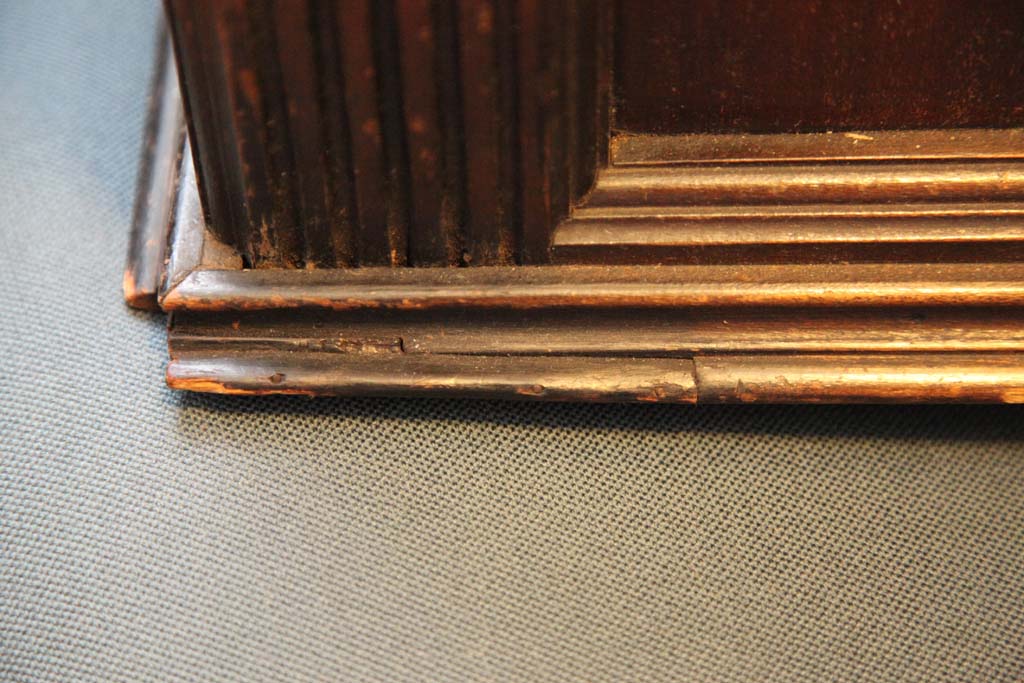

Yes there seem to be finishing nails. Though these I am not sure were not put there for other reason than holding the pieces together....which BTW all the more reason to change these two pieces of trim, where the corner is cut.
The nails can be seen here.
Here it is from the top.
Also the nails' caps are seen.
Might be good to replace the trim on all 3 sides, they would match each other well then. What do you think?
Probably makes sense; after all the trim is the only part that is really damaged here.
