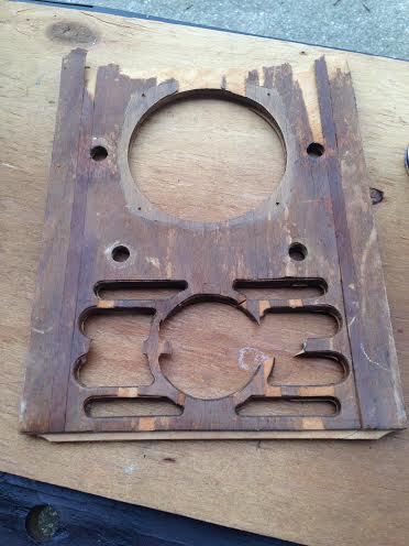

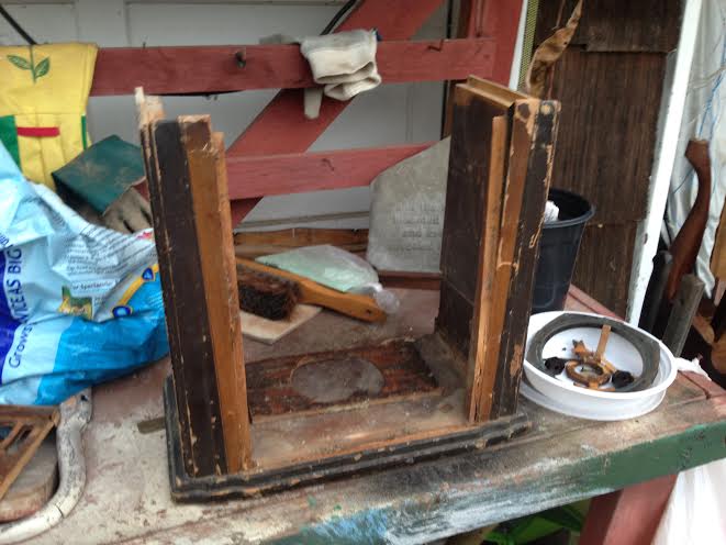

I got to working on the cabinet today and pulled apart the cabinet. next is to cut a new front from 1/4 A/B ply.
Geez Kirk, you sure don't waste any time!
