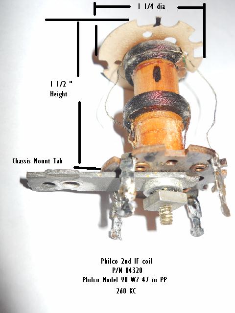

Sorry missed that you tried already, try pulling one or two turns off the coil and try resoldering.
Gregb
If while taking the turns off the wire proves brittle, even if you could resolder - don't.
Started unwinding the Primary, Had to remove 65 inches of it to get to good wire. Looks like something maybe the Tape made the wire rot. The Primary has 53 dc ohms the Secondary has 56 dc ohms
Re-soldered to lugs. Got nothing to loose will reinstall and see what I have.
Gary has a bunch of 262 Coils that would trim to 260, just finding one to fit in Original can is the task
sent Gary a Pic of original.

I have a replacement IF coming for the 2nd IF

As long as the primary has continuity now difference of 3 ohms DC resistance should not effect the inductance enough that you can't adjust the IF to 260 kc. In fact they may have been mismatched to begin with, either through accepted margins of error or because they wanted a step up between the primary and the secondary windings. I would try re-using the original IF coil if you can, and save the new one as a spare.

Used the Original IF transformer. Had it in and out 4 times
Repaired break in Primary
The Secondary checked good with ohm meter 53 ohms but would not work in radio, Cleaned wire around rivet and soldered it. That did it

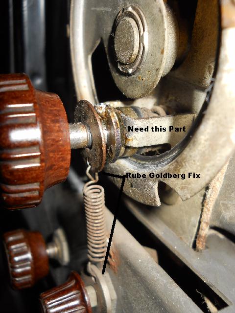

Dial Tuning is sloppy. Part shown in Pic is worn out and allows dial to drift.
I need the Part Pictured and marked .
Thank You
Will post in WTB also
I have both 70 and 90 having zones where it is slipping. Guess it is quite a common problem for this type mechanism. I found out that moving the dial just a little along the axis helps it but you have to make sure it does not rub against the escutcheon.
Another thing, the grease tends to accumulate there and makes for less friction, so those need to be degrease.
Honestly, I do not remember this spring-pulled washer in either my 70 or 90. I wonder if they added that (or it was a home repair remedy) to increase the pressure of that rim onto that groove. I am not sure it is a factory solution - hadn't seen it before.
Mine is not slipping. The part marked has worn egged shape so allows Dial to shift.
I need the part shown and marked as such.
The added spring and washers are the result of last owners attempt at a fix.
Replacing the Part marked with a good one, I believe a 1/4 dia bore will solve my problem
