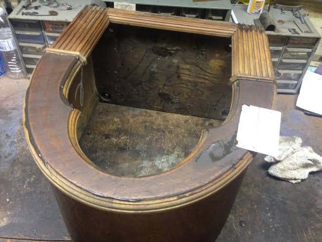

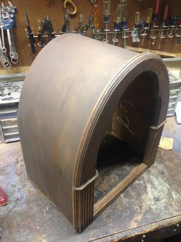

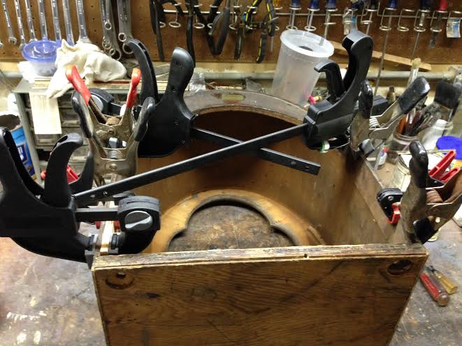

Today I unclamped the base and it is nice and strong. If I dropped it off the 2nd floor it would survive. well, the base would...
I glued and clamped all the separations from the arch and the sides and tomorrow I will sand to remove any excess glue and grain fill the arch and molding on the front.

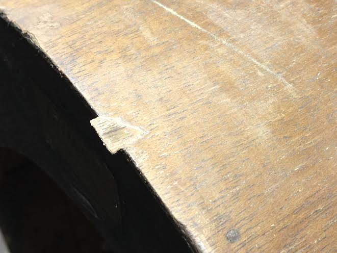

Unclamped the cabinet for the final time. I was going to grain fill but I found a veneer issue I didn't want to leave.

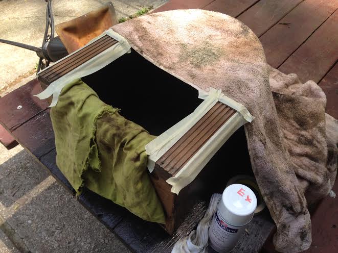

Toning day,

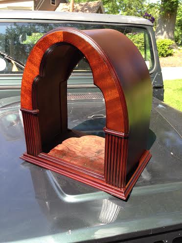

Taped off the columns and toned the inside grooves Ex Dk Walnut.
Then toned the entire cabinet with a medium walnut. I want to let the lacquer set for a day so I can sand the cabinet before clear. Too much dander in the air and the finish is not smooth.

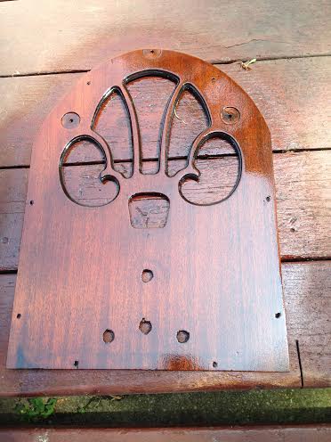

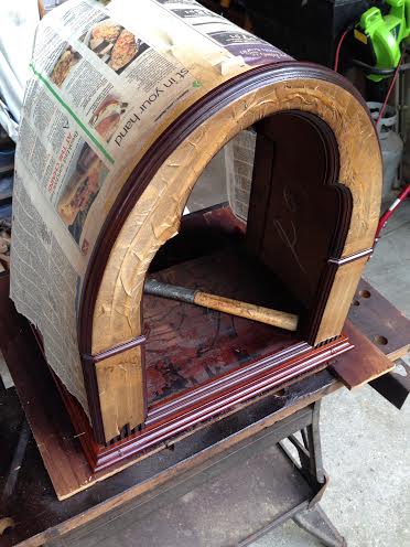

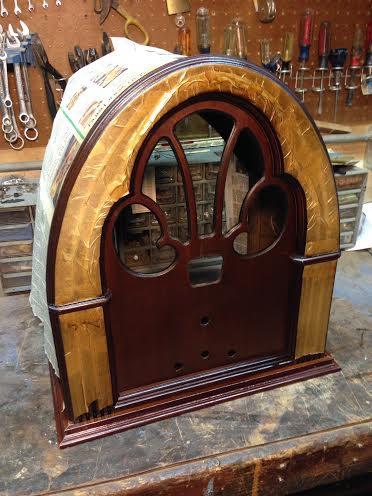

Today was rebuilding day. I took the freshly toned molding and attached it back on to the cabinet with the original nails and added some glue. I filled any crevices and the countersunk nail holes and tomorrow I will finish toning the trim, Put the face back in and clear clear clear...
In about a week I will finish sand and wax her up.

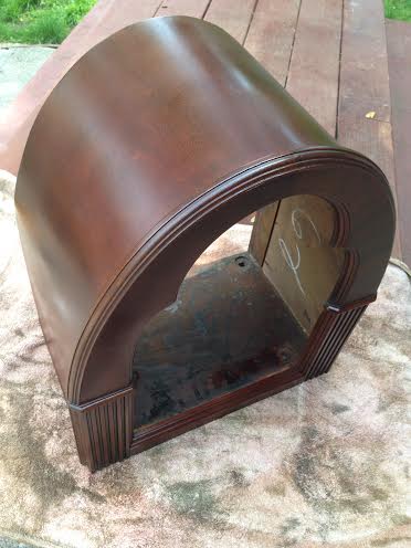

Finished toning and Untaped to reveal pulled up finish and perfect brown seeped under the tape. Have to strip and re-start.
Bad Perfect Brown! Bad!
Ok I finally got it right. Icon_crazy

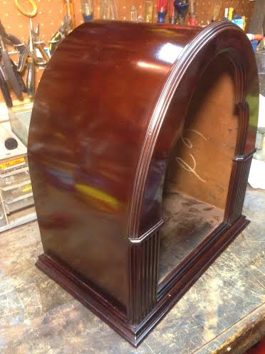

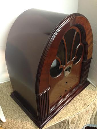

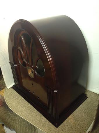

I toned the front and then cleared 6 good coats. Sanded 400-2000 and will wait a day or so for the cabinet finish to harden. Then I will Apply some pumice and rub out the cabinet. Since it is a high gloss finish I will rub it out again with lemon oil and then wax her.
And you people were serious when you told me that I could do all this!
I would probably retire by the time I finished it.

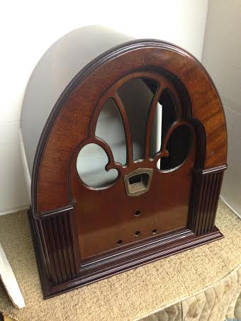

Well I buffed her out with oil and cloth and then added 6 coats of wax.
I re-assembled her and now to let the wax harden for a week or so.
