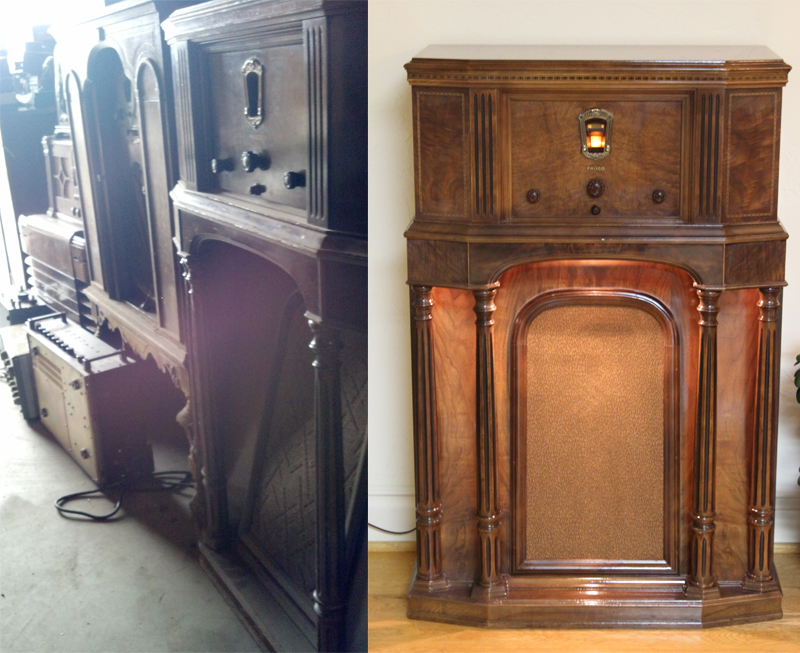

I just finished this "before and after" Picture for our slide show. Actually shows the radio "as found".
It was no small job, getting it out of there. The "path" through the "stuff" was only about as wide as the radio after moving a "few" things.
Its a beauty Russ!!
Icon_clapIcon_clapIcon_clap
Russ, Is the light coming out from the cabinet a factory light or an add on? I have never seen this radio in person before. You did a beautiful job with it. I would like it in my kitchen also.
It is a factory light. You must remember to remove the light bulb before pulling the chassis out, or you will need a new bulb.
