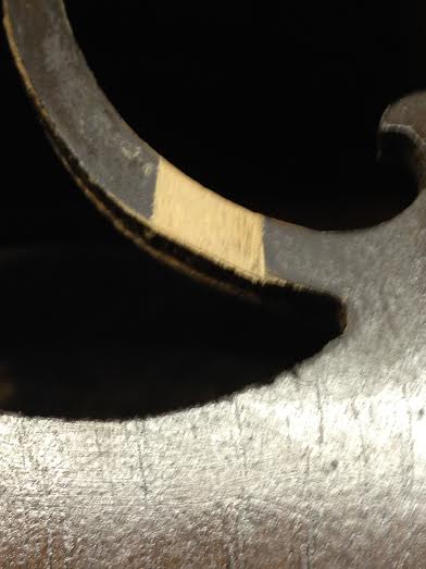

Finally got the veneering done on the face.

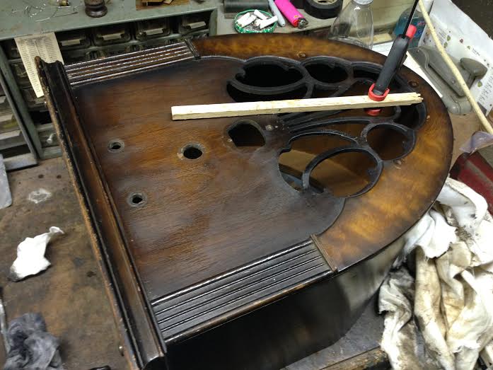

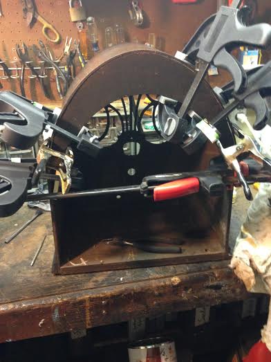

Today I matched the veneer, colored the inside grill wood, and started gluing the major separation obf the back arch.

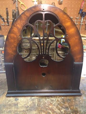

Besides the grill work and the molding, this is the one that will be most original. I have matched most of the issues and fixed the veneer but some old repairs could not be fixed perfectly due to major gluing. Of course this is the one that is most special to you..... I will try my best Mike and if it is not up to standards I will buy an airbrush kit and redo the entire cabinet. UMMM After I learn to airbrush. Icon_mrgreen

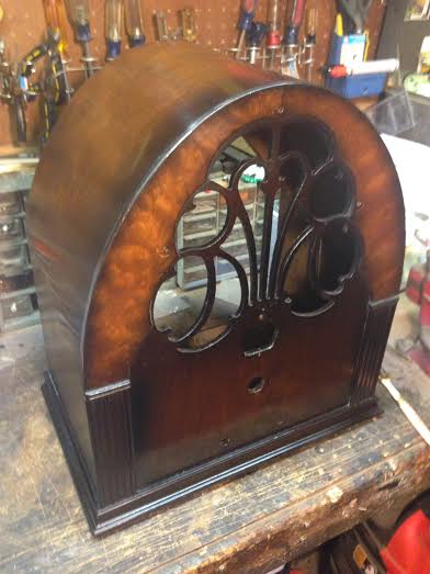

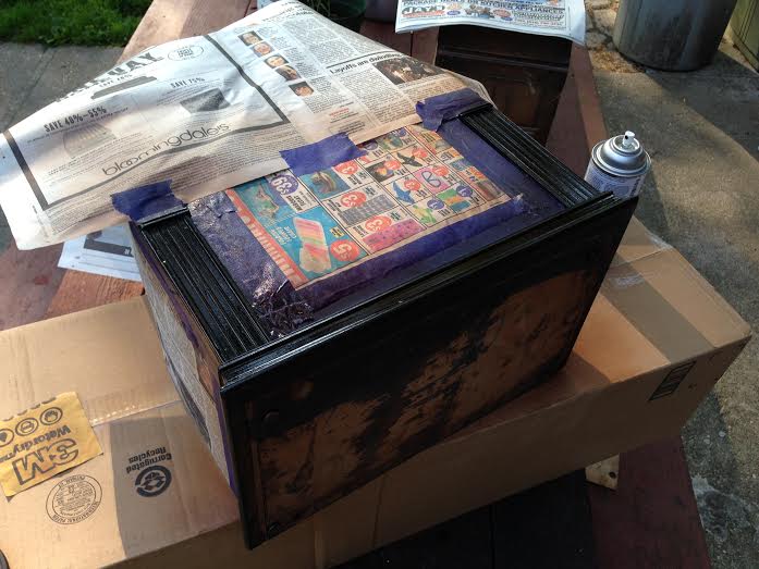

Taped, toned, cleared!
Now to wait 2 weeks to buff everything out.

I think you can replicate your arch face with succesive applications of a lacquer toner. As you add a coat, it will get slightly darker and you stop when you get the shade you want.
Yes Art, but this is Mikes and I don't want to test my skills on his radio.
Do I scare ya? Good! Icon_twistedIcon_mrgreen
Done!
