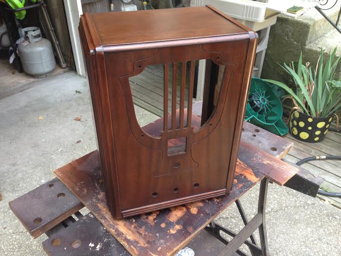

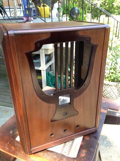

Toning day 2
That looks nice!

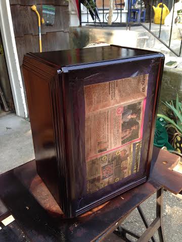

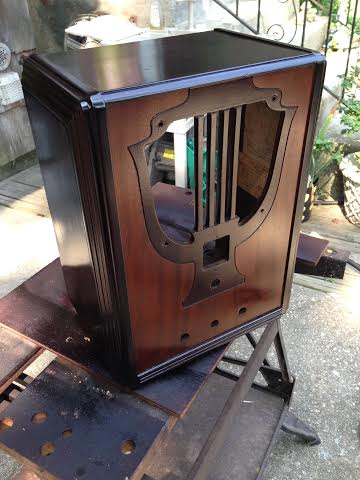

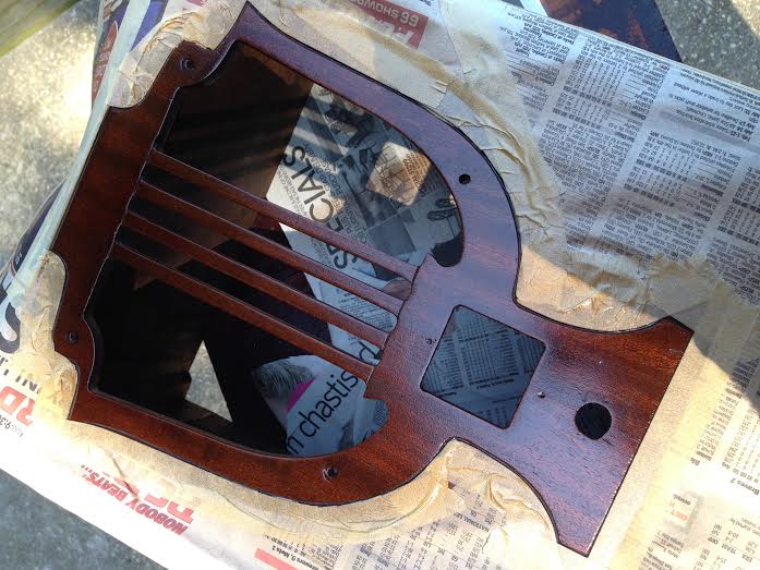

Ok toning the rest today.
Tomorrow I will add some clear, then add the decal and clear the rest.
Then it is 2 weeks of curing before I can sand and sand and sand, then rottenstone and rub out the finish.

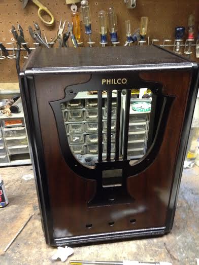

Finished adding the decal and cleared the cabinet this morning.
Now to wait 2 weeks to buff everything out.
Kirk, you ruined it...you used the wrong decal! Icon_thumbdown
You should have used DCL-PH8. This is the proper decal for all 1932-1936 and some early 1937 Philco cabinets.
http://www.radiodaze.com/product/6049.aspx
Yes I wanted to say...it is a smaller decal that should be used.
Well,
I looked online and those are the ones I see.
I guess I'll have to remove it. ugh!
