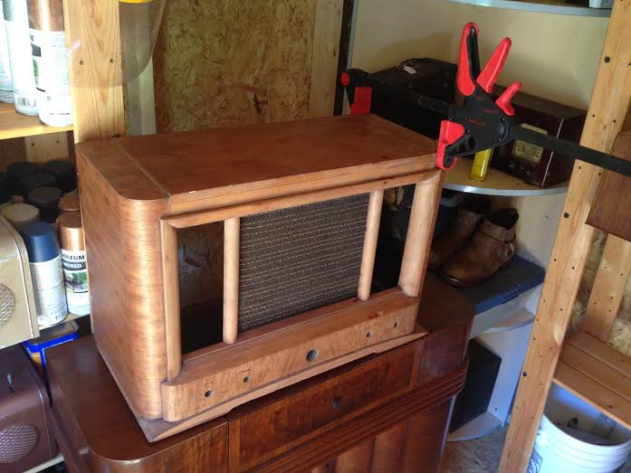

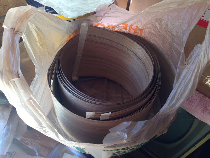

Just pulled the sucker down and started prepping the cabinet for new veneer. Some loose seams so gonna fix those before. I just opened the box I got from Steve and oh boy, I said I needed 3 strips, not 3 8 footers, lol.
I owe you Steve
Glued clamped and waiting for tomorrow.
