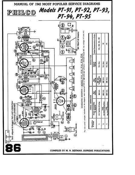

Here's schematic.  Looks like someone subbed a PM speaker and used old output transformer.  Unplug set, scratch a 9 v battery arainst primary of output transformer and you should hear a click.  Next, replace the filter capacitors at very least before powering up again.

The first thing I did was replace the caps and resistors and I got the click from the speaker and 9v battery.
