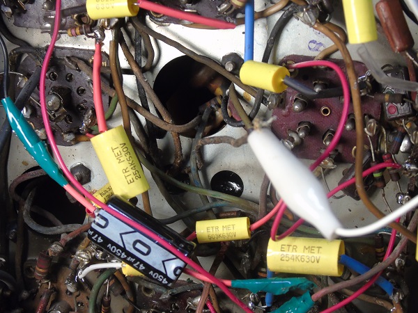

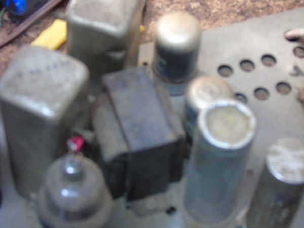

(11-08-2016, 05:01 AM)the picker Wrote:  I looked at the radio and if I connect the 15 uf to the positive side of 40 uf cap I have 4 wires left 1 the green speaker wire ;2 the one that goes to resistor 77 and on to the power transformer; 3 another wire that goes to what looks like a small power transformer in the middle of the chassis ;and 4 a red wire that goes to a terminal lug that has a brown green orange resistor attached and red wire that goes to the if transformer and a wire that goes to the power transformer in the middle of the chassis
< 1 the green speaker wire
The schematic doesn't indicate the wire color, but measure the resistance from it to chassis and if it is about 800 ohms connect it to the - side of the 15uf cap.
<2 the one that goes to resistor 77 and on to the power transformer
<3 another wire that goes to what looks like a small power transformer in the middle of the chassis
Don't know I can't see it from here. Take a pic of this sm pt top and bottom and we'll figure it out.
<4 a red wire that goes to a terminal lug that has a brown green orange resistor
http://www.camradio.net/resistors.html
Looks to be #16 15,000 ohm resistor @2w. It connects to the
+ side of either the 15 or 40 uf cap, it's the same connection.

the wire with the white clip on is the wire it goes through one of the two small holes that goes to this unit I am talking about thanks

Well I can't find your little transformer anywhere on the schematic, parts list or chassis diagram. It looks like a choke which would be connected in the p/s but not sure where. Maybe a service bulletin on it depending on the chassis run number. Ron or Chuck may have some insight on this issue.
As for you wire that is connected to the spkr measure the resistance from it to pin 2 of either of the 42 tubes. Show pic of where this wire is and is connected at the spkr.
The wire w/the clip looks to be the hv feed for the second IF transformer. Should be a white sez the schematic. Measure the resistance from it to pin 2 of the 7A7 tube. If it is the hv lead it will show a low resistance like 20 ohms or so. If it is then it connects to the + side of the 47uf cap.

Ok let me take another stab at it. That wire w/ the white clip lead on it looked like it was coming out of the 2nd IF transformer but now i see it's coming next to the IF transformer. So it looks like there are 3 or 4 coming out of the black transformer. Would these wires be connected to pins 2 and or 3 of the 42 tubes???
