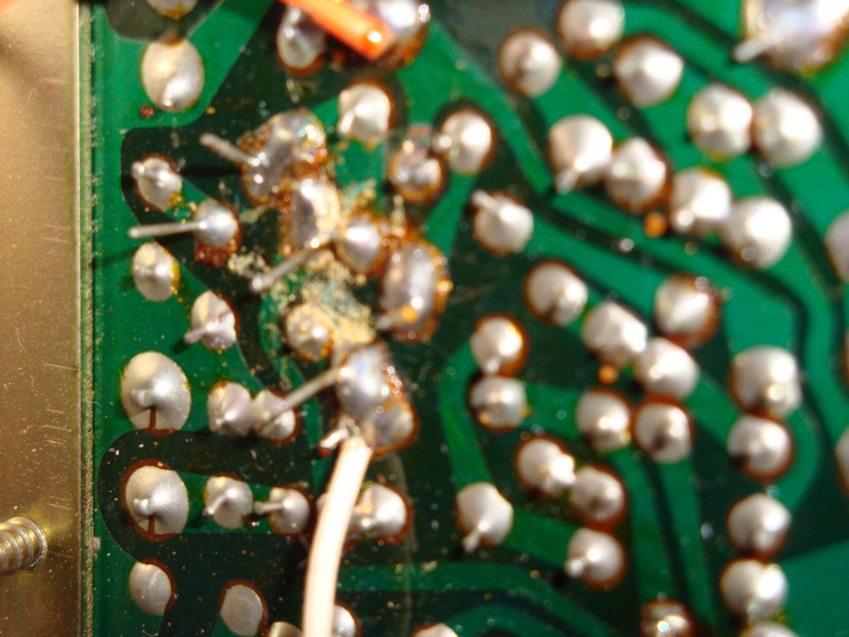

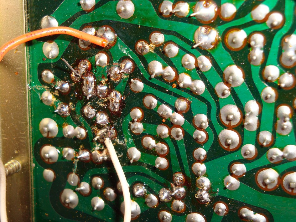

Re: TR701 - I would not be surprised at all that it is bad. You should see the poor, poor soldering job on it and TR702. TR701 is the one that even has solder blobs on top of the PC board (opposite side of the traces and solder pads). What was this so-called "repairman" thinking by doing that?

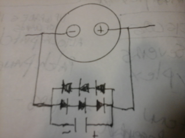

All you need is some 1N4007 rectifier diodes placed in reverse parallel and connected across the input wire from the knob to ground. Something like this from another posting here where the diodes were recommended to protect a VTVM meter movement.
[Image: http://philcoradio.com/phorum/attachment.php?aid=11799]
Wait on installing the diodes until you get the circuit working properly first, as they may reduce the sensitivity somewhat and it would be good to compare with the diodes in and out of the circuit.

I wanted you folks to see the sloppy job that had been done previously by someone who replaced TR701 and 702:
[Image: http://www.philcoradio.com/images/phorum/STA225_027.jpg]
[Image: http://www.philcoradio.com/images/phorum/STA225_028.jpg]
Wire leads not trimmed, and those solder blobs on the leads of TR701...strange.

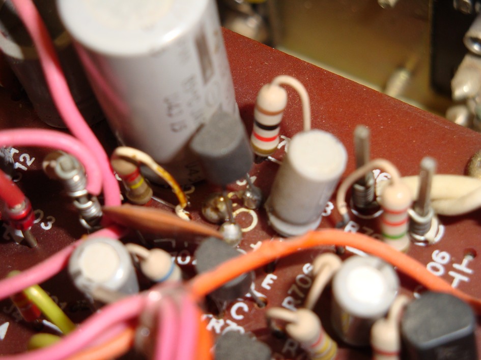

Here's my replacement work under the PC board - I used less solder and tried to be neater in my work, including trimming excess lead lengths.
[Image: http://www.philcoradio.com/images/phorum/STA225_029.jpg]
If you look closely in the picture, you will notice one lead that is not soldered or trimmed - the emitter of TR701.
There's a story that goes along with that...
I did this work, which did not take very long.
I then tried the receiver out.
The Auto Magic still wasn't working correctly - the meter still remained green when I touched the tuning knob!
So...
Having returned upstairs to my home office to post the last three pictures I have posted in this thread, I noticed that unsoldered lead in this last photo just above.
I returned to the basement workbench, plugged the soldering station back in, waited a few minutes, and set out to solder that unsoldered transistor lead.
The pad where the emitter lead should have been soldered promptly came off. Not the entire trace, just that pad. Probably too much heat was used on it by the sloppy repairman previously, damaging it. Fortunately the emitter lead was more than long enough to go to the other component in that short trace, so I merely cut the lead long enough to extend to the next point in the short trace and soldered it at that point.
