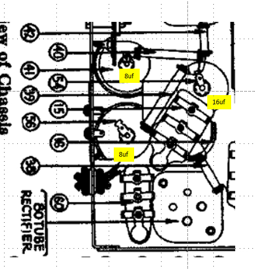

(02-08-2017, 08:54 PM)keith49vj3 Wrote:  Just to be sure, you're getting 1100 ohms when you test your field coil by putting your ohmmeter across the positive terminals of the two 8uf caps?
Keith
If you can get ac hum from touching the cap of the 75 then the choke is conducting. If not there wouldn't be any HV throughout the chassis except for at the filament of the 80.
#32
Terry, the reason I asked that question is that it would be easy to hook the field coil between the 8 and 16uf cap rather than between the 8uf caps.  I have no idea if you would get hum that way.  On two of my 610's these caps were in different positions than shown in the manual (and these  were unrestored  originals).  I restuffed them one at a time, put them into the radio and was really  confused when tracing the wiring.  Here's the cap placement that was on two of my radios (I need to check the third).  Parts 54 and 41 were reversed.
Keith

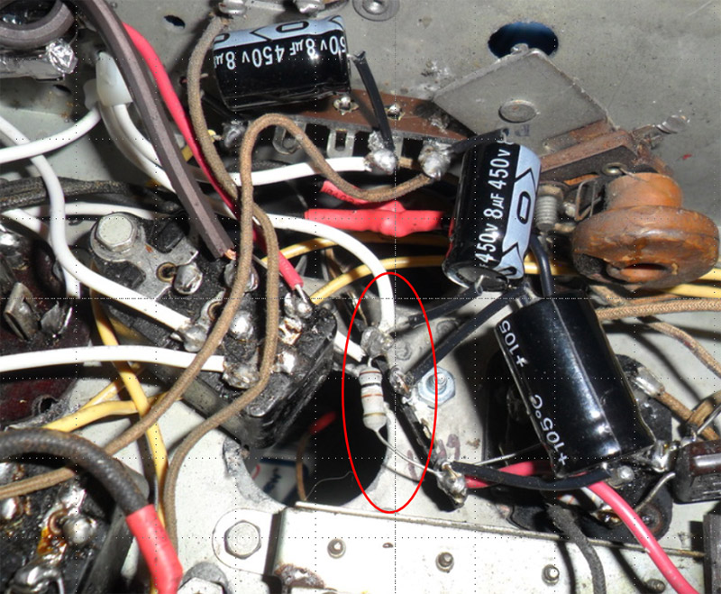

Well, I must have done something wrong the first and second time checking the field coil. It was ohming at a little over 1100 and now it is showing at the number below.
[Image: http://i1036.photobucket.com/albums/a446...6r6fgl.jpg]
I posted a picture of the electrolytics so you could check how it is wired.
[Image: http://i1036.photobucket.com/albums/a446...b6wang.jpg]
#36
It's hard to tell without labels on your photo.  Are the speaker leads that go to the field coil  white?  Is that a 100ohm resistor going between the positive of the 8uf cap and the positive of the 16uf cap?
Keith
#37
If the circled resistor  is a 10K you've got the value right but it needs to be a 3W resistor.  Since mine is on my bench I can take resistance readings from  each tube pin to ground and we can compare mine to the readings you get.

Yes it is a 10k resistor and the speaker wires are white. Probably not to standards. I did miss the fact that I should have a 3 watt here though. Also I just learned how to put pictures on here and I will try to find out how to label them too. If you have info on how to do that I am absorbing everything you guys send. By the way, I work 3rd shift 4 days on and 3 days off. My days on are 14 to 18 hours long so if I don't answer right away, that is why. I will do resistance readings and post them Saturday evening. I understand that this with the speaker unplugged, right?
(02-13-2017, 09:13 PM)keith49vj3 Wrote:  It's hard to tell without labels on your photo.  Are the speaker leads that go to the field coil  white?  Is that a 100ohm resistor going between the positive of the 8uf cap and the positive of the 16uf cap?
