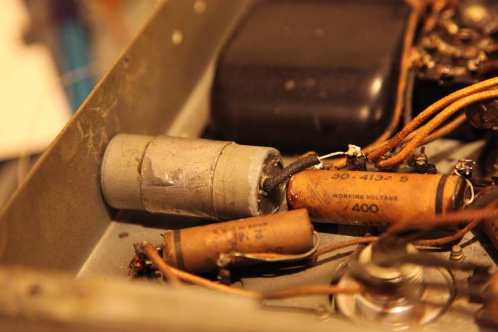

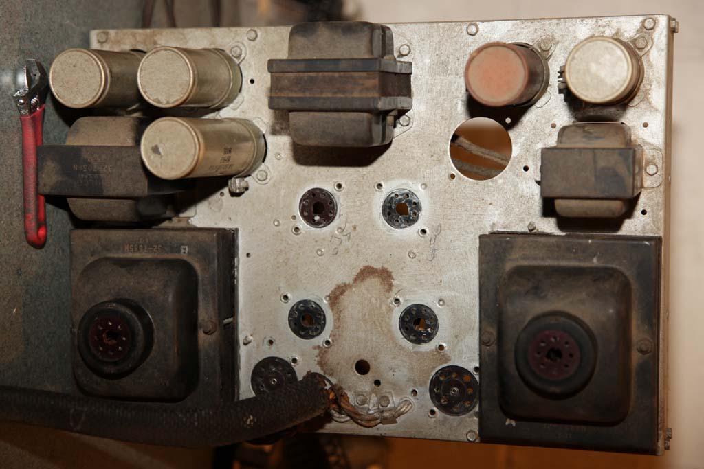

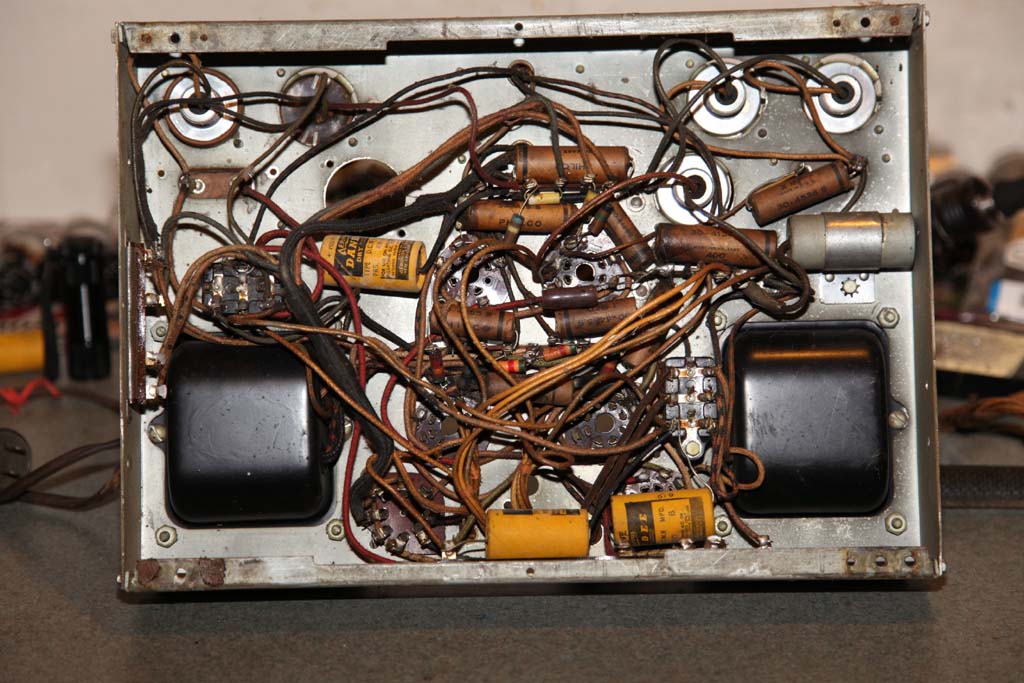

The Power / Audio Amp chassis is on the bench now.
Same deal, whoever owned it at some point painted it with aluminum paint using a brush.
Plus the caps are not original, obviously, with one seem to be missing (will find out when the sch comes from Chuck). And some  substitutes are axial under-chassis jobs/
Some Candohm; at least one I checked, the shorter one, seems OK; will know with the sch.
I also extracted the sole aluminum can cap from the main chassis.

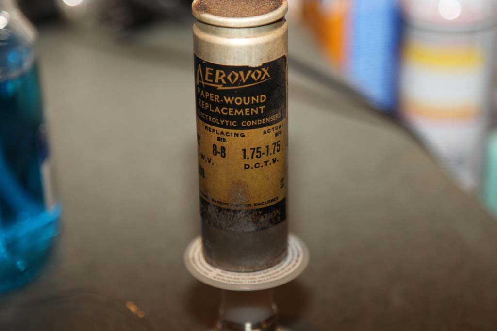

Here's something I don't get from the label; maybe someone knows why:
The label says "Replacing mfd: 8 - 8", which is understood, replacing a dual 8uF cap. But then it says "Actual Mfd - 1.75- 1.75" which tells me it is a dual 1.75uF cap. (BTW still measure 3-3uF).
What does that mean?

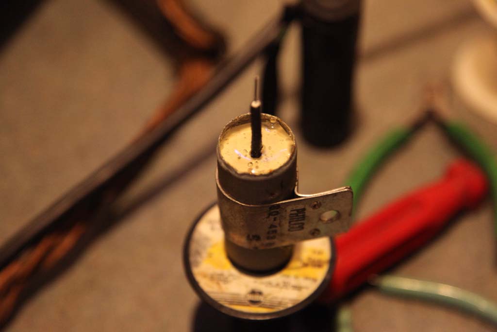

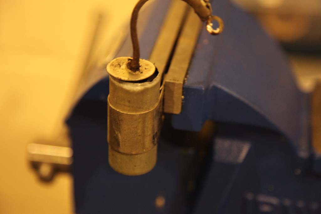

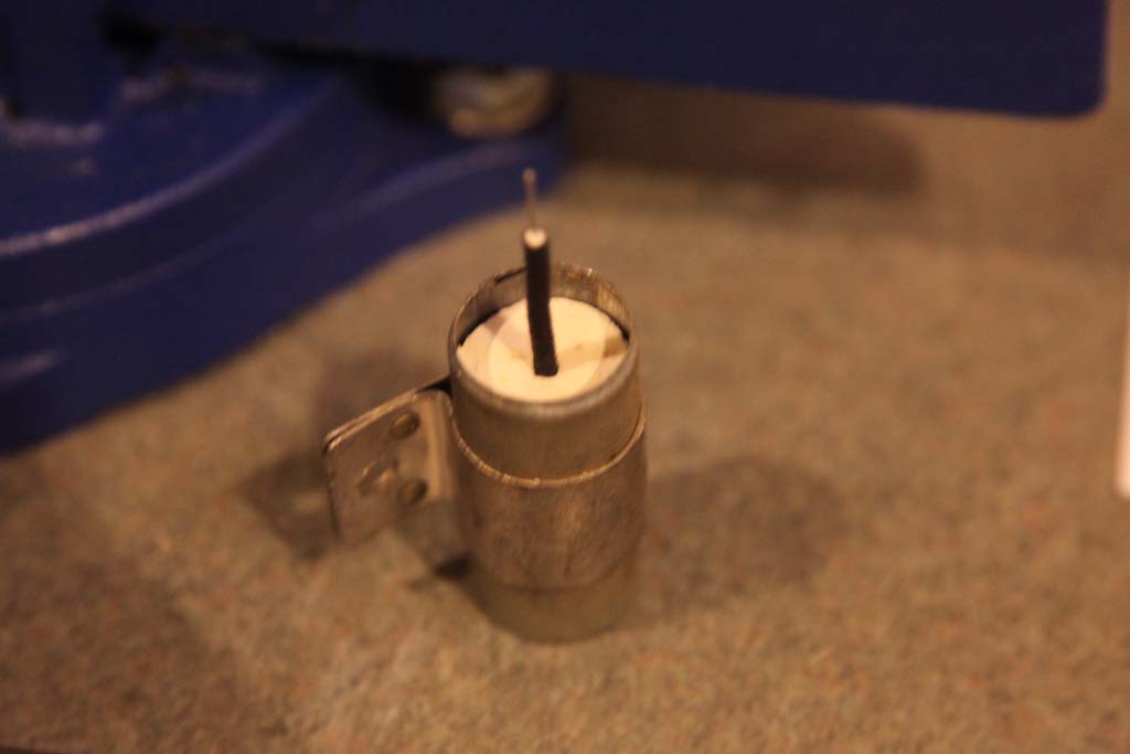

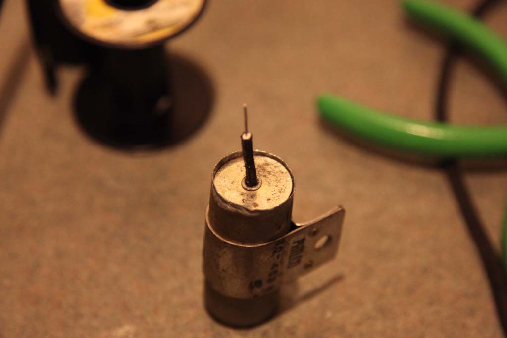

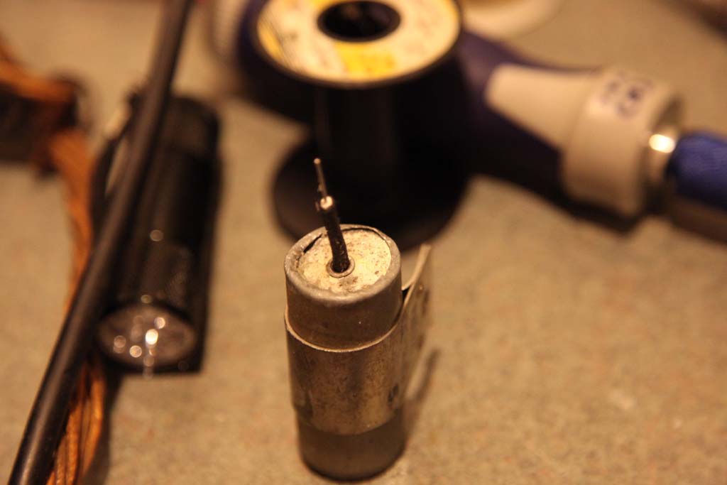

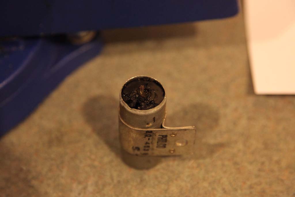

Then came what I thought would be the worst: the tubular metall shell 1uF cap for  the tweeters.

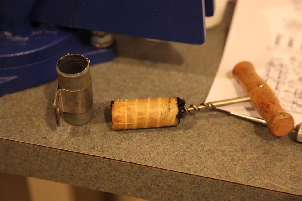

I used cutters to start unrolling the edge, proceeding with needle nose pliers, then pulled the metal cover and used a corkscrew to extract the tarred roll. It came out very easy with no heat.

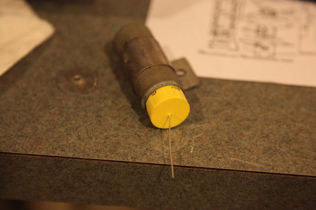

After that I put a polyester audio cap I happened to have around, which also fitted the size ideally,  inside, potted the top, put the cover back and replaced it in the chassis. Whew.
Here I put a paper circular piece to keep the molten plastic from hurting the cap.

Regarding the 1.75 - 1.75 uF cap: I'm afraid I have no clue on that. I might hazard a guess and say that perhaps this was a World War II replacement when parts were scarce and repairmen were limited on what they could use for replacements? Again, that is just a guess.

About the electrolytic: I would support that theory but the Aerovox put it on the label which is weird, at least. It almost looks like "our microfarads are better than other people's microfarads and so our replacement ratio is 1:5 as our farads simply perform better".

More pics:
Potted
Cover's in
Closed (well, I lack proper tool so it is not exactly beautiful)
In citu

Yesterday finished the tubular caps.
Remaining: the electrolytic caps, one on the main chassis and a bunch on the Power/Audio chassis. One is missing, so is the clamp. I might have a clamp, though not sure it can be properly riveted to the chassis.
