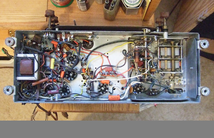

I did some preliminary ohmmeter checks in the B+ circuitry and found no shorts and the electrolytics slowly charged up. Tomorrow I plan to do an AC power on test and make a few more measurements, while watching for any possible smoke!
All of the essential paper-wax-foil capacitors have been changed. I had planned to change the two AC input .01 filter capacitors, but discovered I had used up all the ones I thought I had, so I stopped to order some more from a supplier. I may get lucky and receive those by the end of this week. For now I will operate the set with the OEM capacitors. They check OK for now.
One thing more that I need to do before applying power tomorrow is to check all the tubes. No point in applying power if one has a short in it! I suspect however that they are OK except some may have low emission after so many years. You never know though. The Philco 40-201 I restored had all of its original tubes except for one and it worked quite well for signal pulling power etc. after I got the paper caps, some resistors and rubber wiring replaced. It will be interesting to see how this one compares to the 1940 model. The RF loop antenna on this set is a much lower impedance than the one that was in the 40-201.

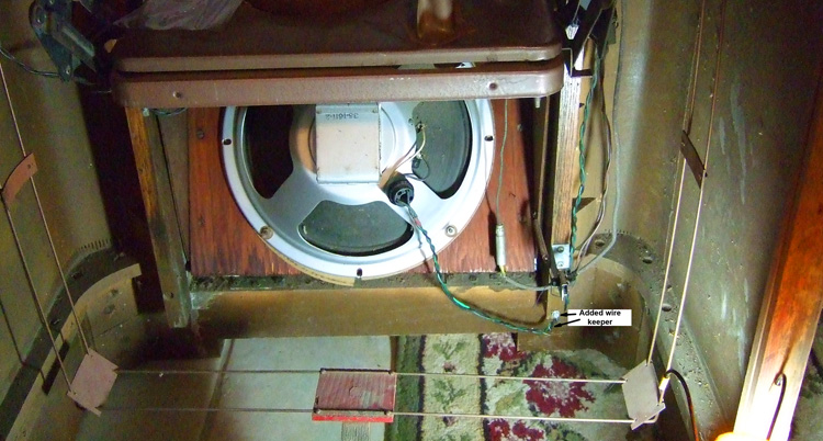

I also repaired the two speaker leads where the arms of the changer mounting had cut them. When the chassis goes back into the cabinet the lead dress of these wires will have to be watched and secured in such a way that the brackets and levers associated with the changer compartment do not cut them again.

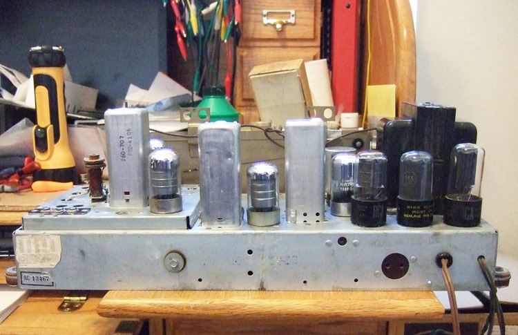

This morning I did do a check of all the tubes. All checked OK except for the 6J5, which in this set was a metal tube. The 6J5 had no emission whatsoever! The tube did get warm, but just no emission. I had another 6J5 that checked good from an E H Scott 800B tuner parts chassis. I installed that tube so that the audio section would have some chance to work.
Now for the checks on the power transformer, 5Y3, 300 ohm resistor in the B+ and the AC measurements:
AC input voltage this morning was 123VAC.
Measuring at pin 4 and 6 of the 5Y3 socket, tube removed, 705VAC
Measuring ground to pin 4 of 5Y3 socket, tube removed, 352VAC
Measuring ground to pin 6 of 5Y3 socket, tube removed, 352VAC
Measuring pin 4 to 6 of the 5Y3 socket, tube installed, 690VAC
Measuring Gnd to pin 4 of the 5Y3 socket, tube installed, 345VAC
Measuring Gnd to pin 6 of the 5Y3 socket, tube installed, 345VAC
Measuring at 5Y3 cathode, tube installed, 31VAC and +337VDC
Measuring at the first Electrolytic filter section, +311VDC
The 300 ohm resistor is hot but not smoking and although I would not want to keep my finger on it, it is well within the capability of the 5W resistor I installed.

Here are a couple of pictures of the chassis;

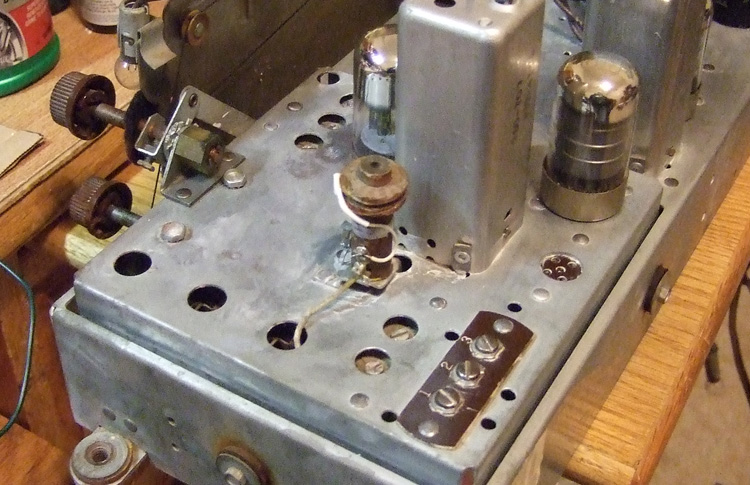

Bad news! The RF antenna input coil is open between the tap from above ground to the top of the coil. The lower part of the winding is OK, but mice have chewed the wires to the top lug completely away. Looks like the top section should measure about 1.6 ohms while the lower section should measure about 0.2 ohms. I don't have a coil like this on hand. I will have to see if I can find something to replace it.

I was lucky that I was able to fish out the end of the wire the mice had chewed apart and by careful re-tinning of the lead I established continuity again, then used a very fine insulated wire from one of the very small audio cables often seen used for connection to phonograph cartridge connections. It is about 28AWG stranded wire with a white insulation cover. That matches with the white wire coming up to the solder lug on the bottom of the transformer. I used the smallest size of white heat-shrink tubing to protect the completed connection and shrunk that, then added a couple of small drops of clear plastic glue to stabilize the end of the wire at the winding of the transformer.

I found the break in the wire of the antenna transformer by connecting one lead of the ohmmeter to the center tap lug on the bottom of the coil form, then using the other meter lead to move along the circumference of the top winding. I could hit a certain spot and establish continuity. I began to work on that spot with my finger nail and also a scribe and eventually managed to break away some of the original glue that held the end of the winding to the rest of that coil section. I wound up with about 3/8" of lead to work with. I used a small white wire from very small shielded audio cable to make the connection to the end of the exposed wire after first tinning the end until the litz wire insulation was burned back enough to tin about 1/16" of the wire. The other end of the wire was attached to the solder lug on the coil form that the white wire from under the chassis was attached to and soldered. I used some magic mending tape to secure the new white wire to the coil form body and then shrunk the white heat-shrink tubing I had slid over the small white wire. Next some clear plastic glue was used to stabilize the soldered wire to wire end at the coil. Here is a picture of the repaired coil.

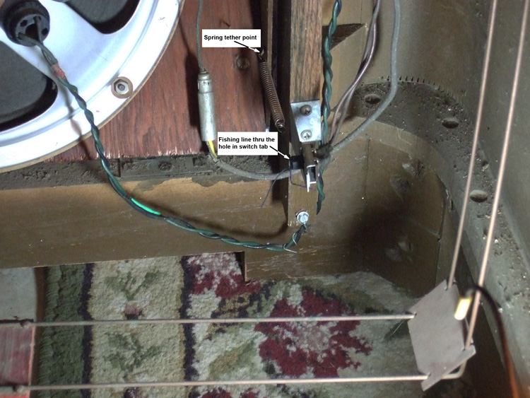

I was able to determine how the lamp for the record changer compartment works. Near the bottom left pivot for the record changer door, there is a small metal tab with a hole in the end of it. A steel coil spring has one end looped through the hole in the metal tab. The spring loaded switch on right angle steel bracket mounts on the stationary wooden rib near the same height as the metal tab with the coil spring on it. The handle/tab of the switch must be closest or facing the changer, not facing the left side of the cabinet. The switch handle or tab has a small hole drilled through it. A piece of dial cord or fishing cord of small size is passed through the hole in the switch handle/tab while its other end is fastened to the free end of the coil spring. Then the end passed through the hole in the spring-loaded switch tab is drawn tight enough to eliminate slack when the record changer door is shut. Then tie the cord with the slack removed at the switch handle/tab securely. Cut the excess of cord off but not so short that it might come loose. A small dot of model airplane cement will stabilize the knot at both the switch and the end attached to the coil spring.
The hole in the switch handle/tab is small and you may not even notice it unless you look closely. On this radio, the string or cord used had broken loose from the switch and I had taken everything apart without knowing how it was put together by the manufacturer. I found it necessary to clean out the hole in the handle/tab with a small wire before I was able to pass a new piece of fishing line through it, which is what I used to connect to the spring on the changer door.
I added a small steel wire with a screw near the bottom of the stationary wooden rib of the left side of the cabinet (viewed from the front) in order to wrap the wire around the speaker wires so that they are kept taut and away from the scissor levers of the record changer door and the rotating loop antenna. This way the wires will not get caught in the door or tangle with the loop antenna. I noticed a few staples in several places on that side and believe that something was used originally to keep the wires and cables organized to avoid problems with movement of the changer door and the loop antenna rotation. Whatever was there originally was gone before I ever saw the radio.
Now when the record changer door is opened, the light for the compartment comes on as it should and goes off when the door is closed.

I mentioned in my last post about the speaker and phono compartment lamp wire lead dress in the cabinet. The speaker wires had been cut in two because they got caught between some of the steel levers associated with the phono compartment tilt-out feature. When I reinstalled the radio chassis in the cabinet I dressed the phono compartment lamp wires and the speaker wires in such a way that I could keep them away from the steel levers and the rotating AM Loop Antenna. There are some openings at the sides of the radio chassis mounting shelf in the cabinet which are at the leading edge and approximately the center on each side of that mounting shelf. I passed both sets of wires through the front opening on the left side of the cabinet (viewed from the front). I attached the lamp and its wires to the post at the middle above the tilt-out-door and the rest of that wire includes the spring loaded switch (which mounts near the bottom pivot point of the tilt-out door) was fastened at the position where it was originally secured. I repaired the broken/missing dial cord attached to the spring loaded switch using some braided nylon fishing cord. Here are some pictures of that area of the cabinet.
