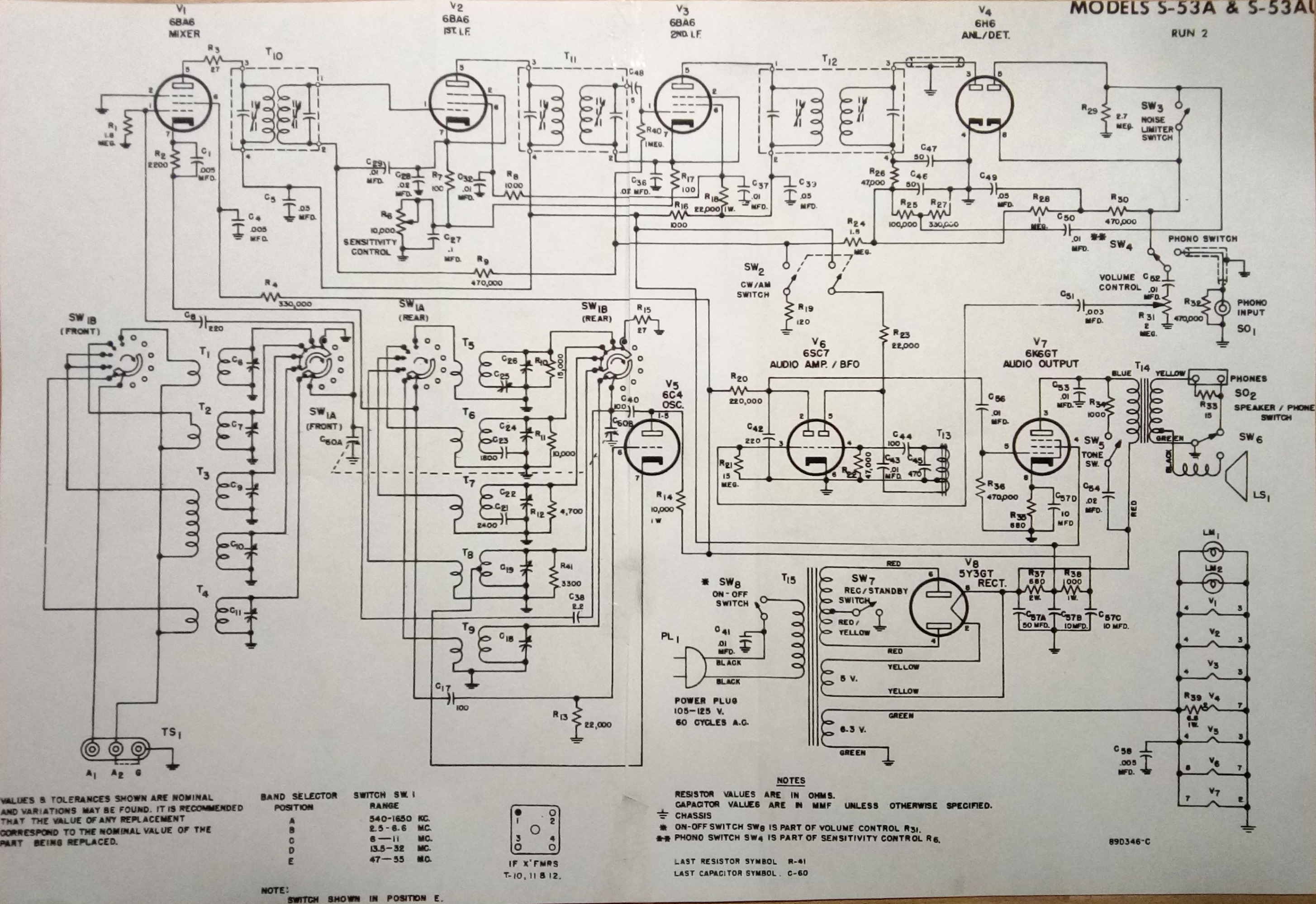

Here is a much better schematic easier on the eyes.
the reference to the IF is incorrect, along the bottom postion 3 & 4 need swapped to represent visually matching how its installed.

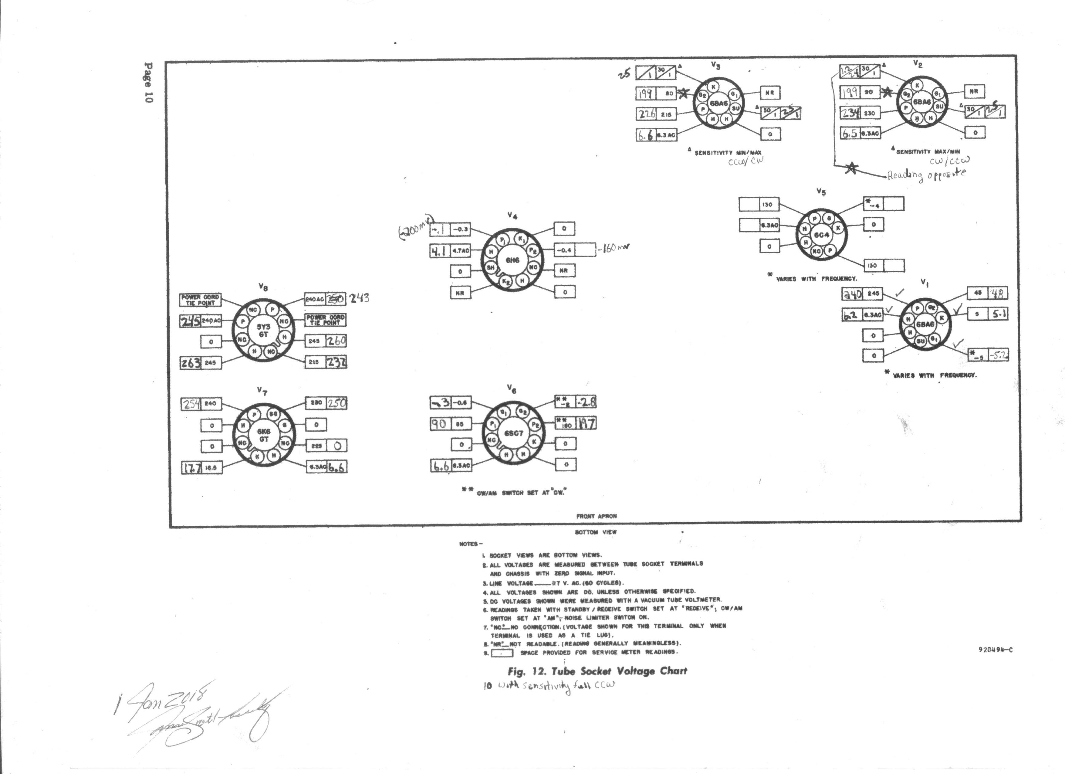

here are my voltage readings setting the chassis up per the instructions.
A STAR means large problem areas.
also, my sensitity tests seemed backwards but i dont think i need to focus on that right now.
see picture
#36
with the sensitivity knob rotated the other way fully ccw, my problem areas fall close to what the table tells me i need to meausre so..... i guess these areas marked with a star are not a problem after all.

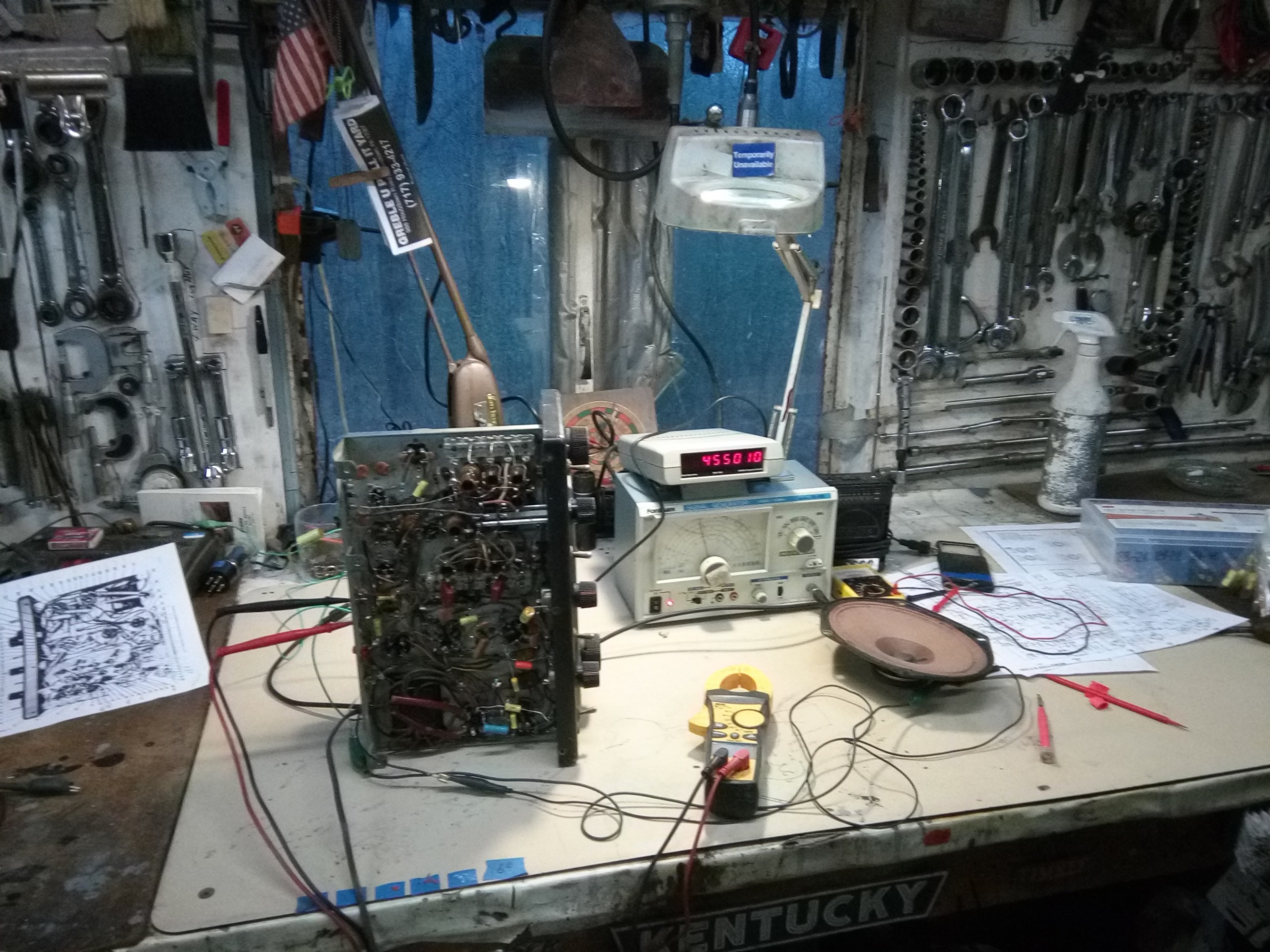

I just settled on purchase of a siggen and a freqgen on ebay.
Fordham SG-490 Wide Band Signal Generator 0 KHz -150 MHz
Global Specialties MAX-100A 100MHz Frequency Counter
#44
I think i need to replace the two remaining IF caps and here is progress so far.
tell me if you think i am right ,  i barely know what i am doing here, this is OJT to me.
I open both tuning caps
I add a .1uf cap but have no idea what they mean by adding it to the high side of the tuning cap so i assumed it meant wherei have it now.
i inject the 455kc
over the past few days i have fiddled with the IF's slug adjustments so much they were totally jacked up.
I finally was able to adjust the IF slugs to get decent volume out but by ear its feeling more like 50%.
I use to be complaining about 20% volume with the knob at max so this feels like progress to me.
I peaked these three IF's (six slugs) by ear but since i suspect my ear is not good enough,,,,,next i added in my meter to the headphone jack and selected headphones.
I started over again peaking the IF's to max millivolt readings.
This helped get me to where i am now, the vol knob is at max but the sound by ear tells me the radio suffers from some degree of low volume.

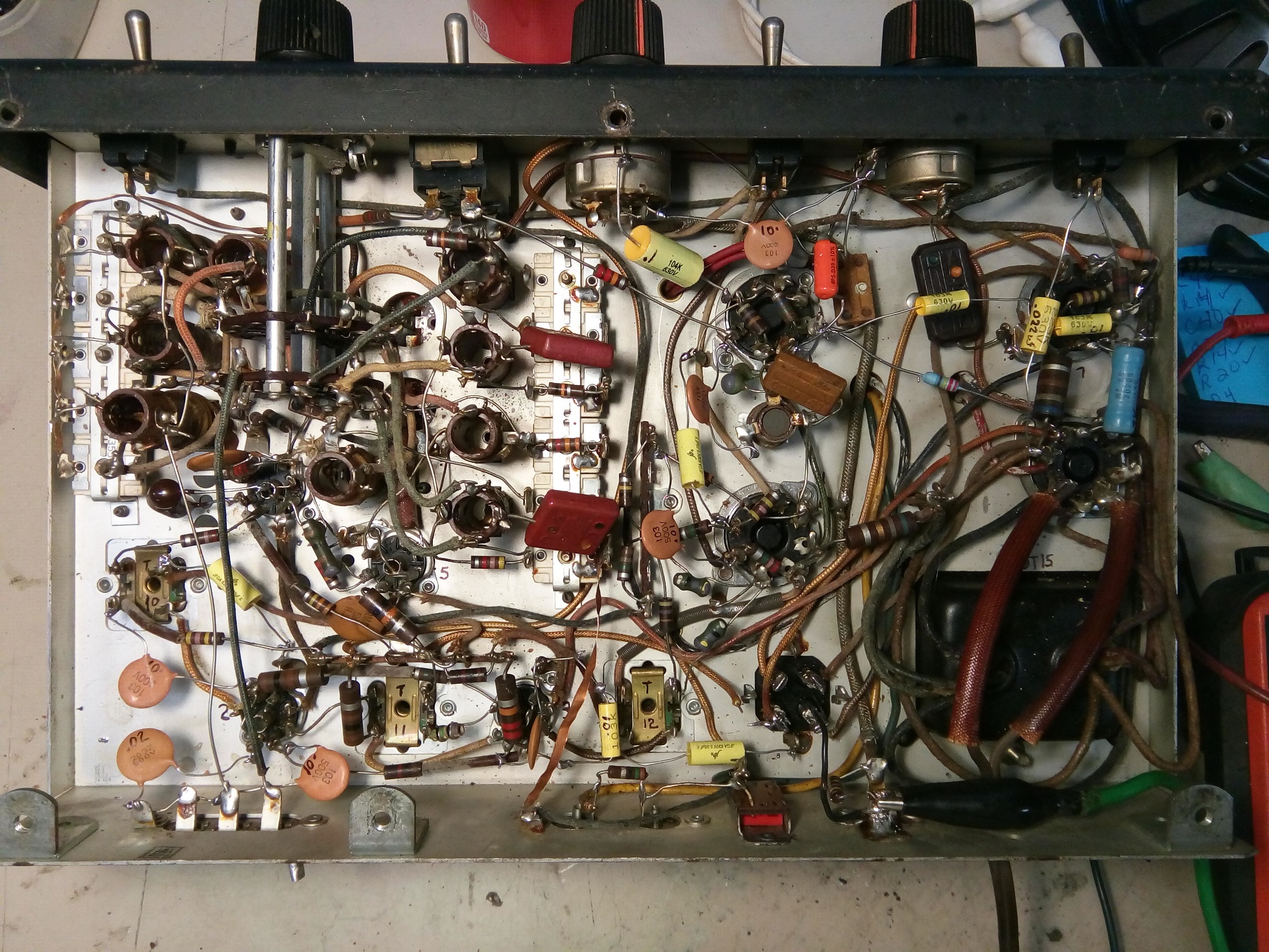

also,
could i have abused where i installed ceramic caps?
i just heard that ceramic (flat round coin shaped) caps should never be installed in an oscilator circuit.
when i got rid of my wax caps, i installed what i had which to this point was a combo of the yellow one and the ceramics.
could this be part of my issue?
here is a pic of the busy end,, to show the qty of yellow caps vs disc caps
