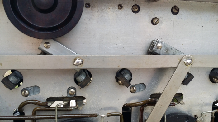

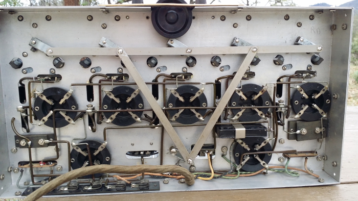

I have a pile of scrap metal. I found a piece of aluminum U channel from which I cut out those arms. They must be all the same or the linkage binds. ALSO, be vey careful in moving stuck linkage. The variable caps are also pot metal. Any additional stress on these and you will have a much bigger problem. I made several extras and selected the ones that fit the best.
Mine moves pretty good using the standard tuning but there is very little friction on the "fine tuning" wheel, so it is mostly for looks.
Note also that I used the original brass shafts and had to use solder to reattach. I suppose that a new shaft could be turned on a lathe, but again care must be used not to put stress on the caps.

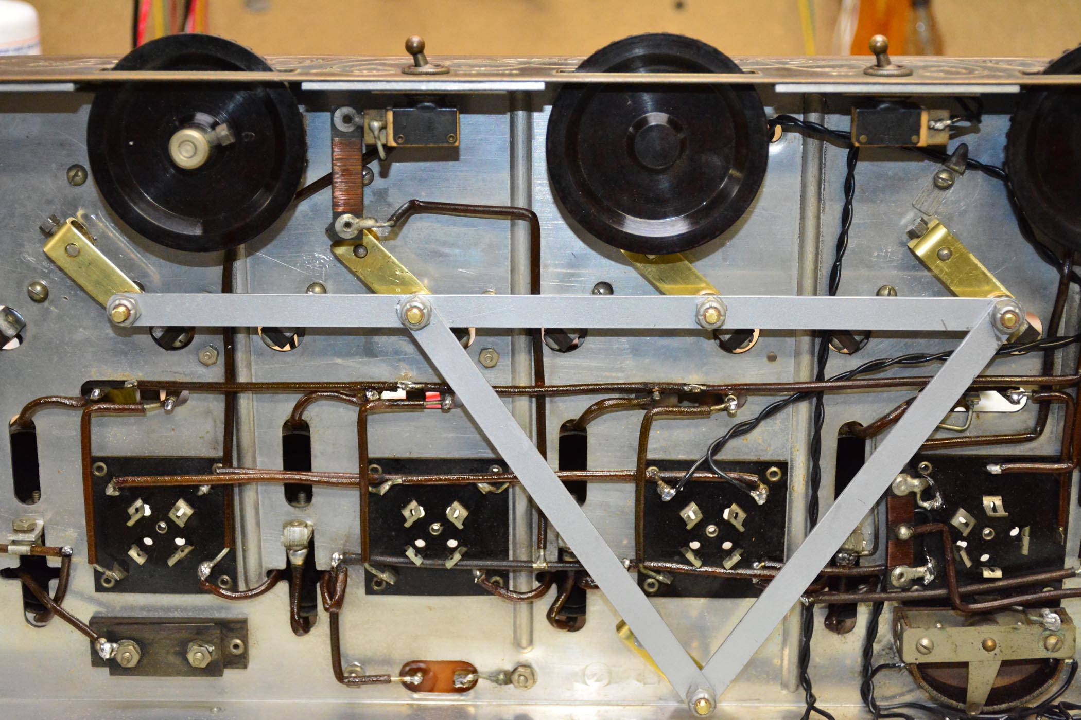

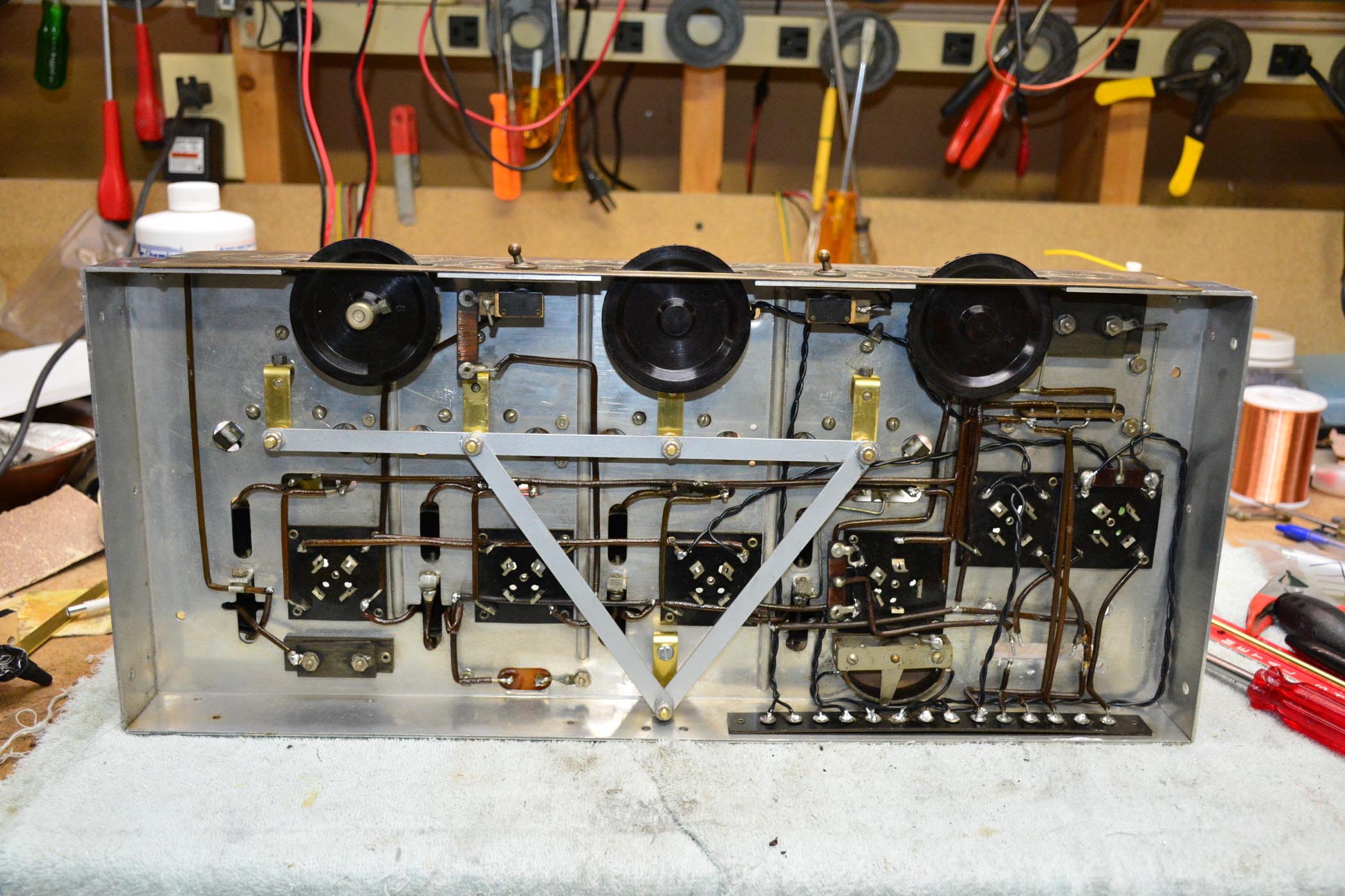

The end plates of the tuning caps are not held apart with a spacer. The end plate castings actually meet in the middle. One of the "spacers" is threaded on the end, the mate from the other end plate is drilled and a screw goes through to the threaded end. Deterioration of the pot metal could cause the whole thing to fall apart. I managed to make new linkages for the assembly out of brass strap using a jig to make sure the holes on each linkage are exactly the same distance apart. If they weren't, the whole thing would bind. There's some advantage to the older chain method of tying the caps together! Hysteresis is probably greater, though. I'll post pics when I get the linkage finished. I need to find some #10 screws with a slight sholder for the brass bearing to ride on. Don't want it to ride on threads as the pot metal linkage did (unless that was not original.) Russ's had some kind of brass pins for the bearing.

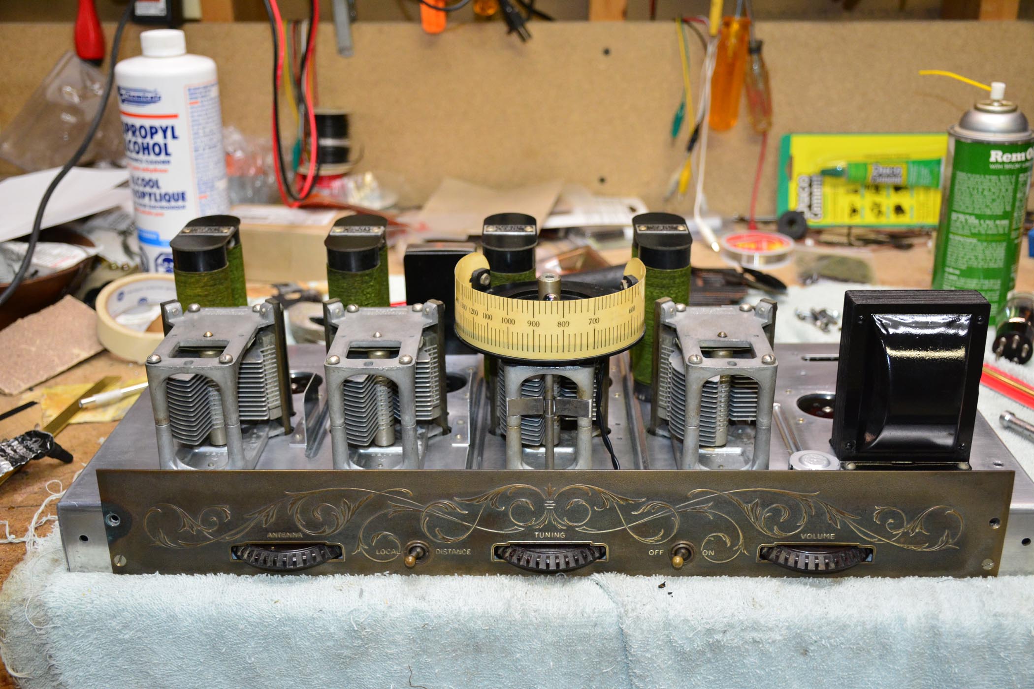

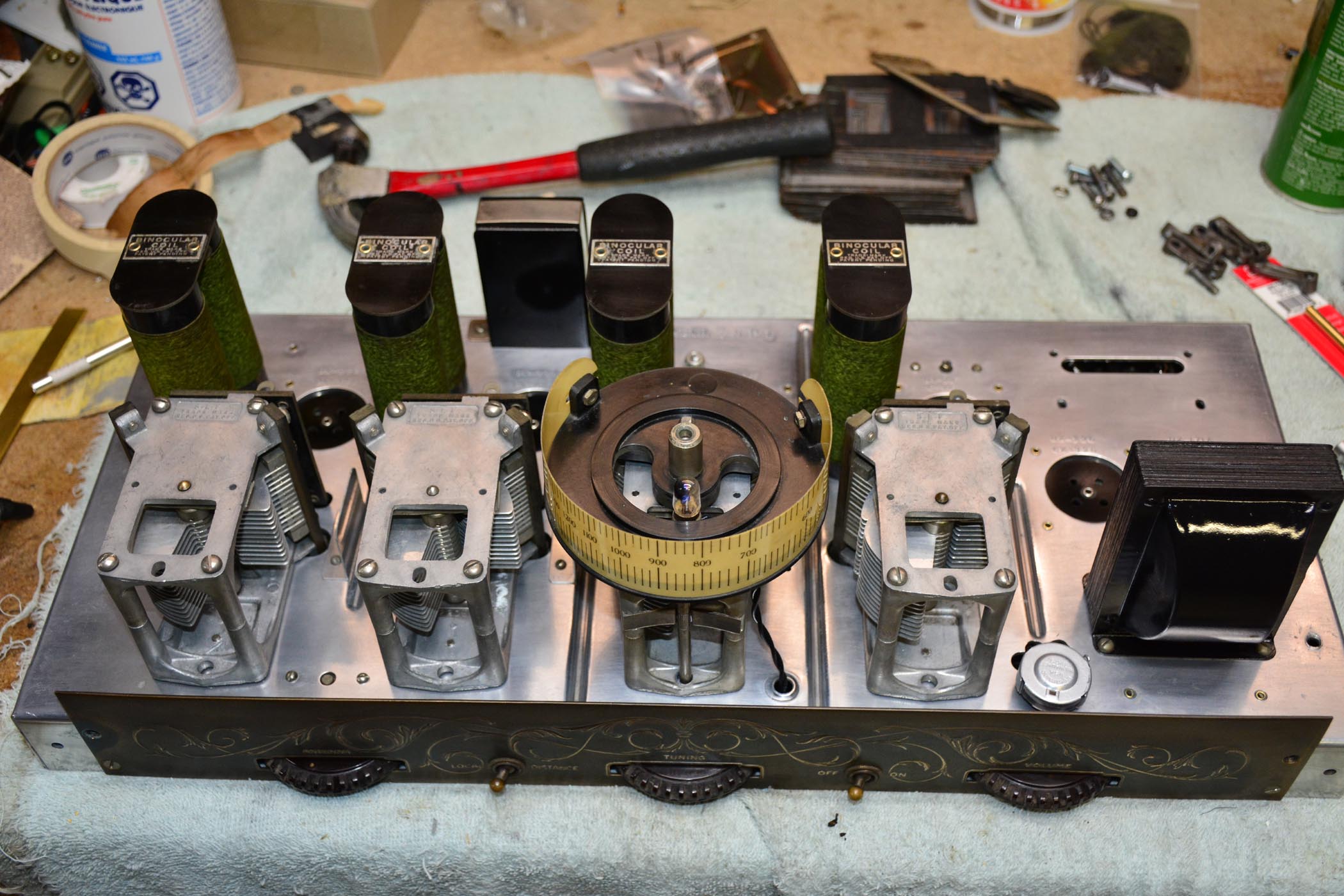

Here's a phew photos of the chassis with the linkage hooked up and WORKING. The brass parts are what I had to make. First attempt is not perfect but works great. I don't think there will be attempt #2.

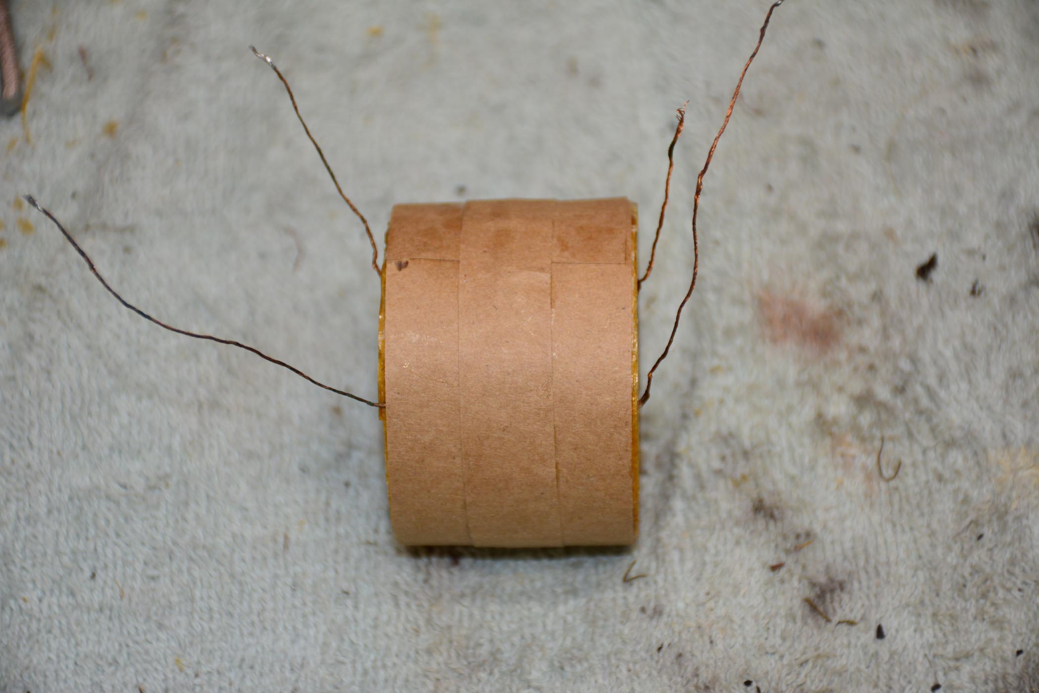

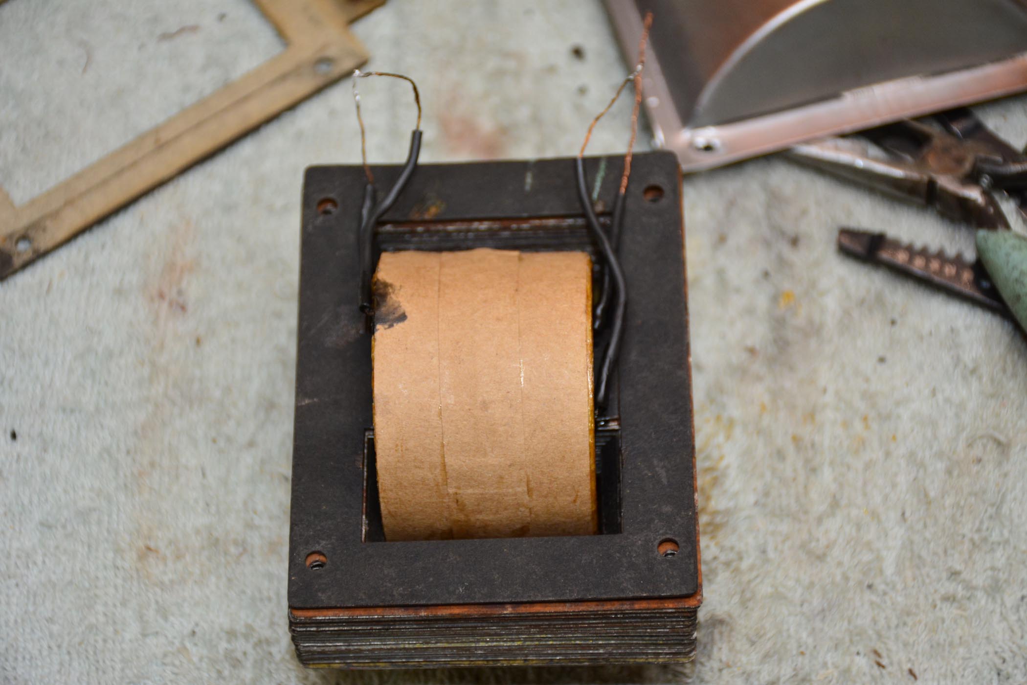

Next is the TR. I'm gonna unwind, then decide if I want to re-wind.
Notice that the volume control is not original and they hacked up the hole for the wires to make the replacement easier to solder in.

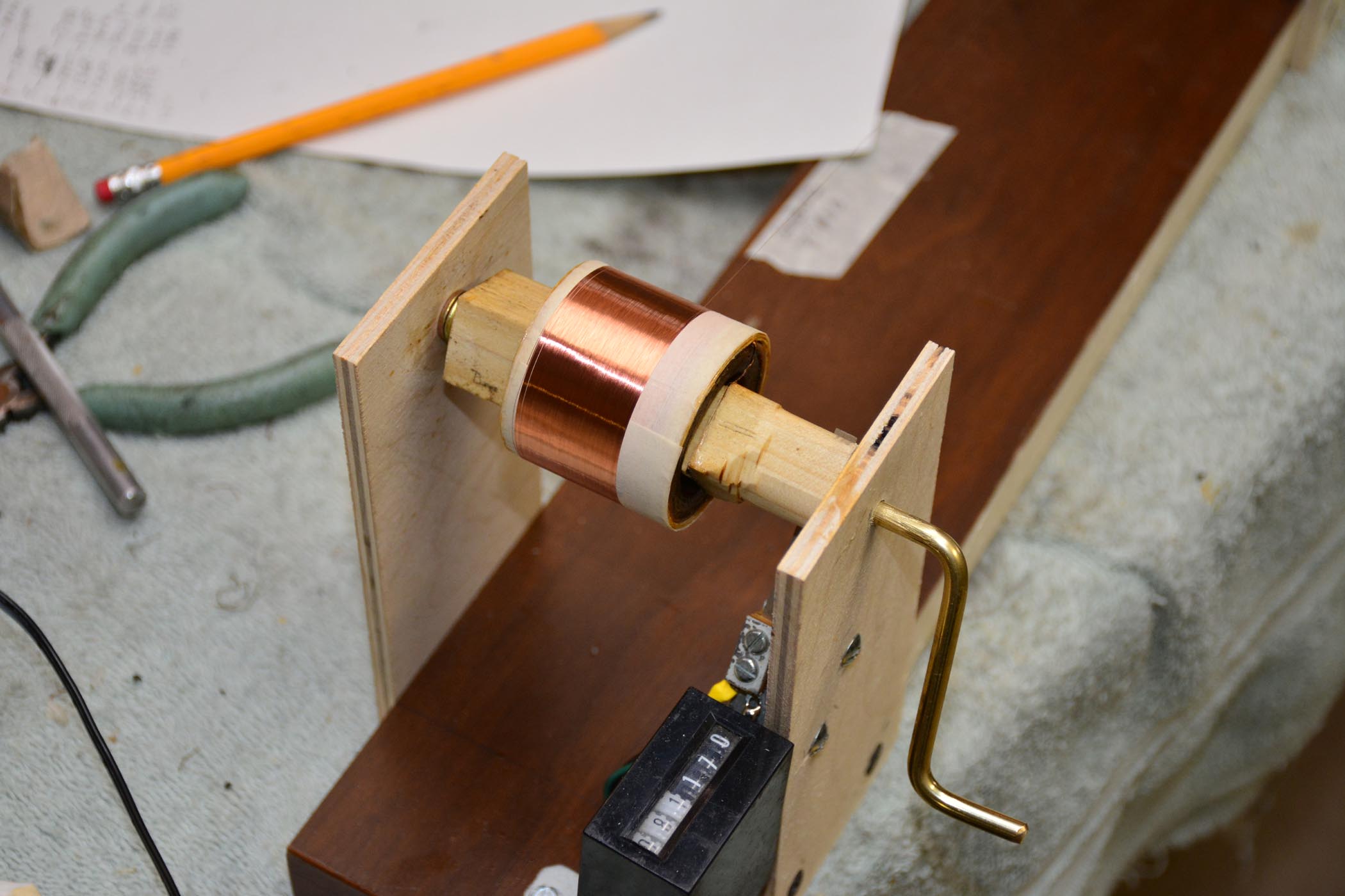

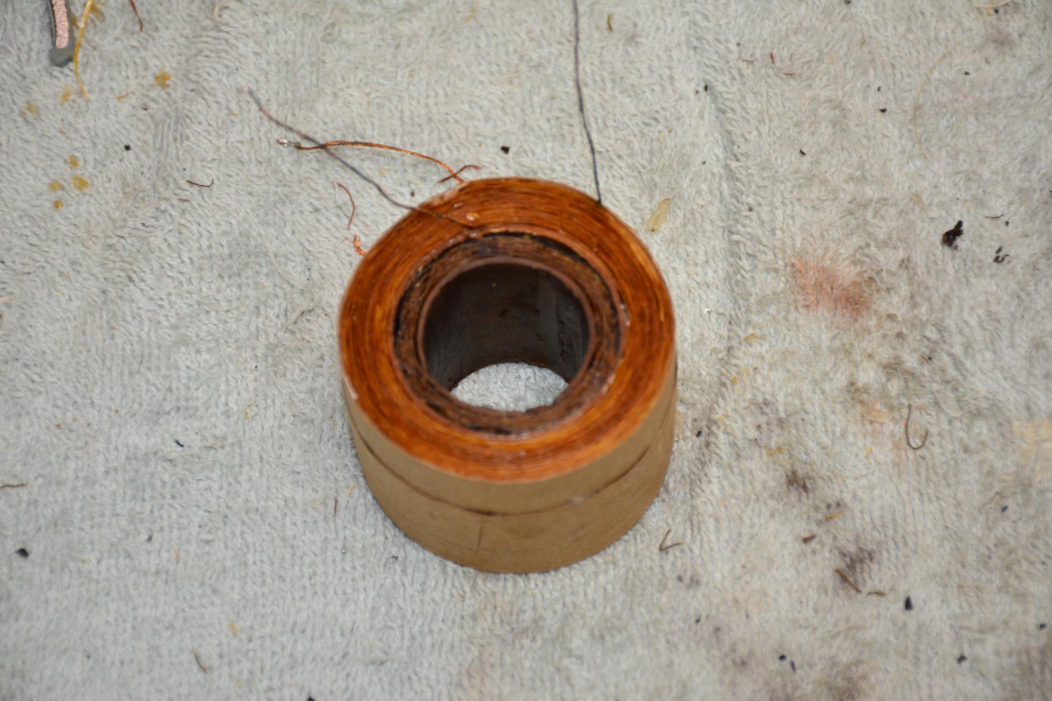

16500 turns on 52 layers of #40 magnet wire. Ouch!! Of course, the break was right at the connection on the inside of the coil. Interestingly, the wire was spliced in layer 8 from the outside. thought maybe it was a bad splice, but not the case. it was obviously a new spool of wire as the color changed. This splice was within a few turns of the previousl layer. when I uncovered that next layer, there were maybe 20 turns with no insulation - bare copper. I could lay my meter leads across them and read the short. Does anyone know what that would have done to the audio in that transformer? Would it have reduced signal level significantly by sucking up some of the magnetic field? I'm interested to know!

Wow! That is quite the winding... The effect of the shorted turns is an interesting thought. It could have reduced the audio, or if might also bog down the previous stage resulting in distortion as well.

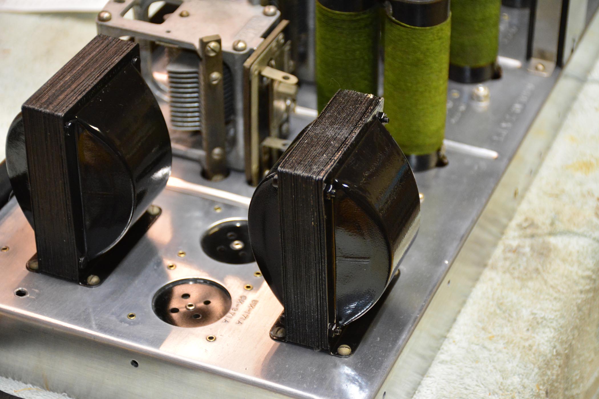

Well, it's finished. 16500 turns. Painful, but done. here's a couple of photos.
In process - somewhere aroung 5000 turns:
Core finnsihed:
final resting place:
