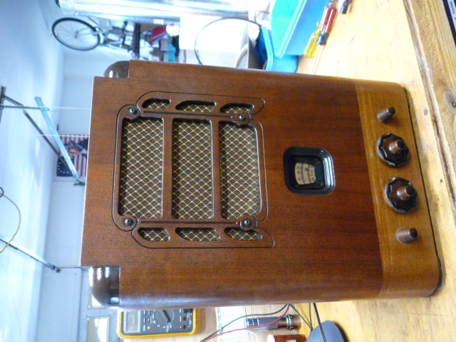

#40
Finished radio.
#41
Very nice radio Icon_thumbup ... and it has the knobs that are so often missing.
