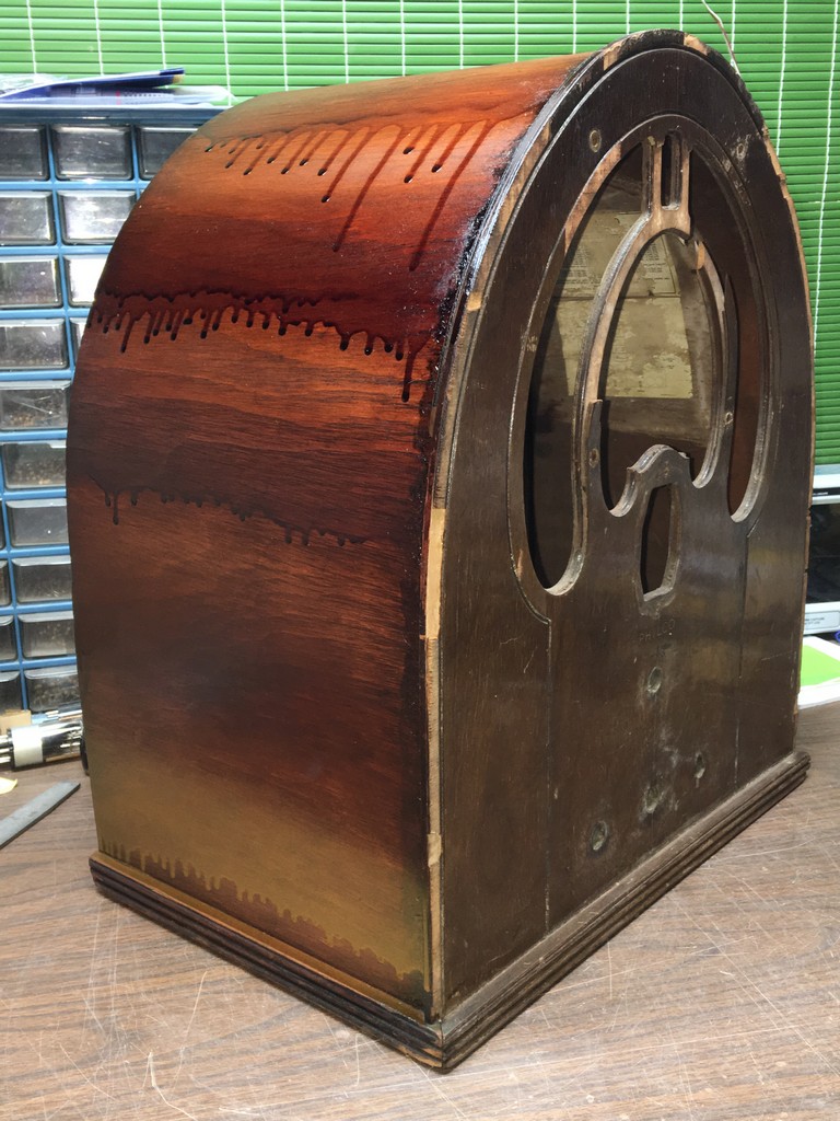

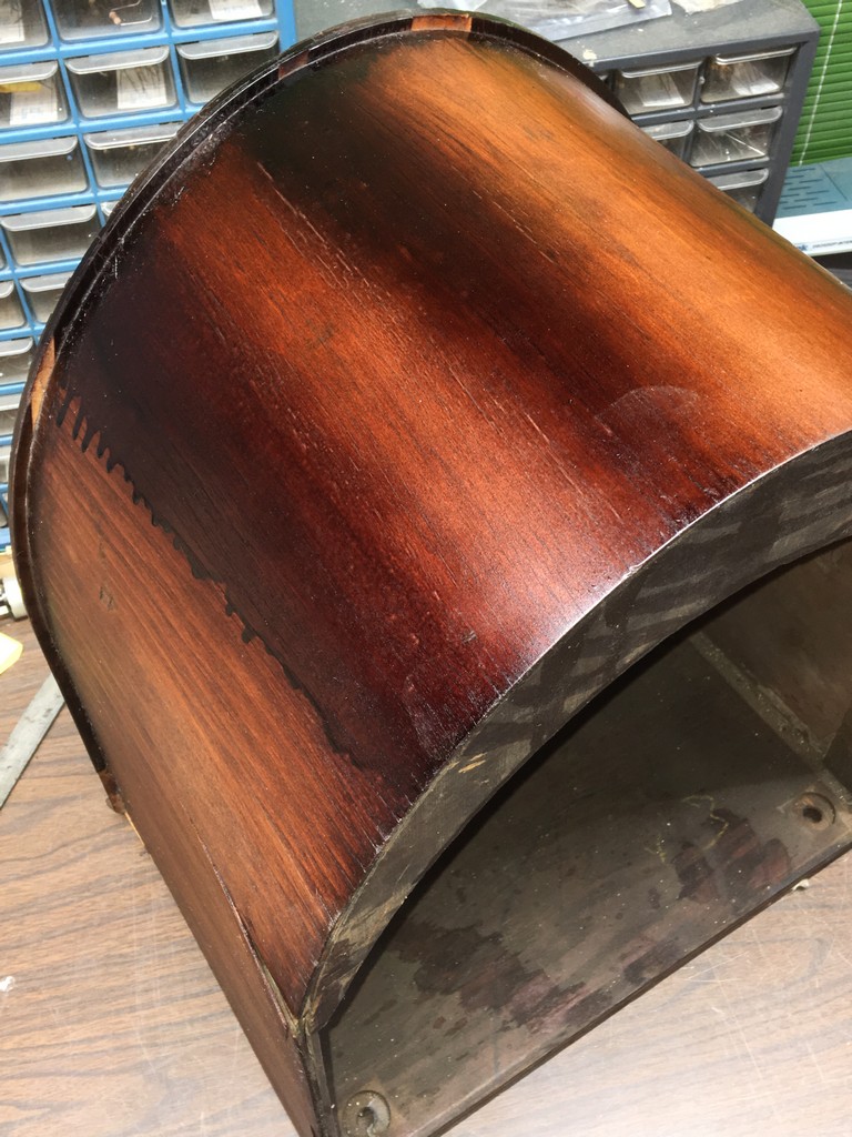

Towards that end, I've been looking at pictures of T7-5 cabinets and it appears that this cabinet was toned in at least three different colors. Today, I took some time to strip the top and sides of a very poor condition Philco 44B cathedral cabinet to use it to experiment with different colors of toning lacquer in an effort to determine just what colors to use on this T7-5 cabinet.
So here is Ron's color wheel. Or if you prefer, the Cathedral of Many Colors.
[Image: http://www.philcoradio.com/images/phorum...-5_111.jpg]
Bottom to top: Light Walnut (Tone Finish), Medium Walnut (Tone Finish), Medium Brown Walnut (Ultra Classic), Perfect Brown (Ultra Classic), Medium Dark Walnut (Ultra Classic).
[Image: http://www.philcoradio.com/images/phorum...-5_112.jpg]
Near the top of the cabinet: Dark Red Walnut (Ultra Classic) and to the left of that, Extra Dark Walnut (Ultra Classic).
Yes, the toners are runny. I don't care. I was only interested in seeing how these colors looked on an old cabinet.
Going back to the first Philco 44B cabinet photo, you can see that Medium Brown Walnut (Ultra Classic) is darker than Medium Walnut (Tone Finish) but not as red as Perfect Brown. And Medium Dark Walnut seems lighter than Medium Brown Walnut.
In the second photo, Dark Red Walnut is not quite as dark as Extra Dark Walnut. I knew this already, having used Dark Red Walnut on the RCA 6T2 cabinet along with Extra Dark Walnut on the "white wood" portions of that cabinet.

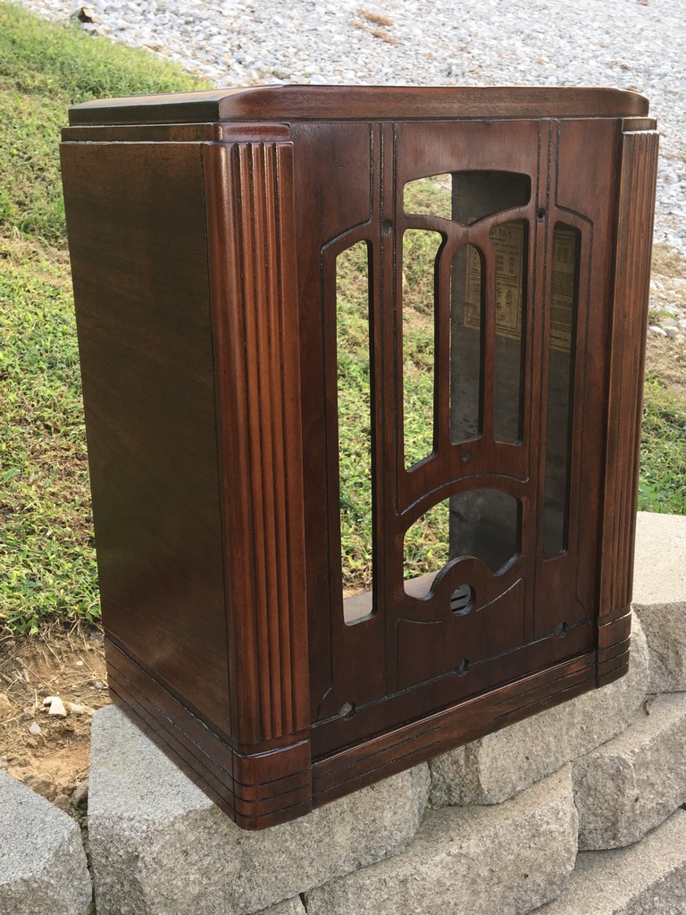

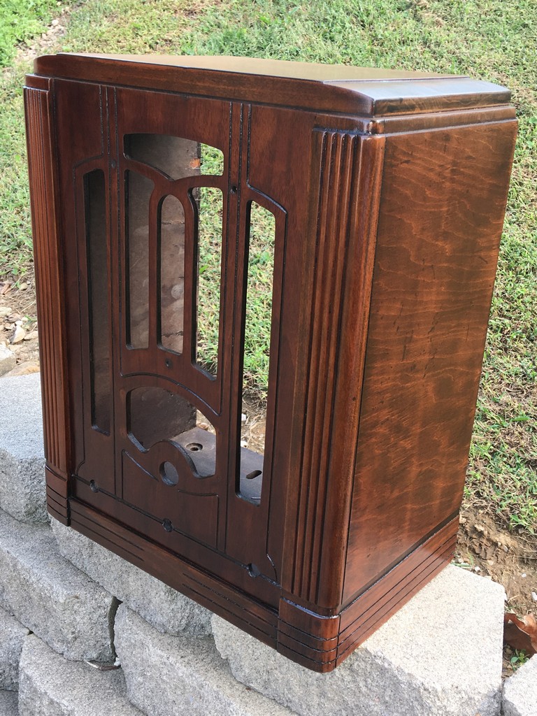

Yesterday, I sanded the cabinet down after Sunday's application of grain filler. This evening, it was time to begin the toning process.
Slowly, the poor cabinet starts to look like a radio again.
[Image: http://www.philcoradio.com/images/phorum...-5_113.jpg]
[Image: http://www.philcoradio.com/images/phorum...-5_114.jpg]
I applied two fairly light coats of Medium Walnut on the original top, front, and right side veneer. I applied four coats on the new veneer (left and lower right) to try to make the new veneer match the color of the old; and four coats on the white wood columns (left and right front).
Next comes toning of the outer edges of the columns as well as the bottom trim with a somewhat darker color (I'm thinking Medium Brown Walnut Ultra Classic), followed another day by the very dark toning (Extra Dark Walnut on the top shoulders, the top front trim, and the wide grooves on left and right).

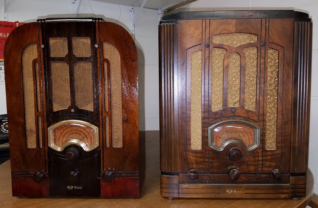

Speaking of T7-5's, I'm now faced with having two RCA tombstones both with the same dial and I know I have to part with one to make room for the other. I'm leaning towards letting the T7-5 go. I know performance wise, with the extra tube, a 3 gang tuner verses 2, it's probably a bit better than the T6-1, but strictly from a personal preference standpoint, I kinda like the rounded corners of the T6-1 a bit more than the squared corner style cabinet of the T7-5. I took a pic of them side by side showing the original wheat pattern grille cloth on the T6 and the (now unobtainable) reproduction wheat pattern I got from Bruce on the T7.

Thanks Greg. And may I add that the front panel of your T7-5 looks much better than the panel on my set. I think mine has second or third rate veneer while yours has a very nice pattern.

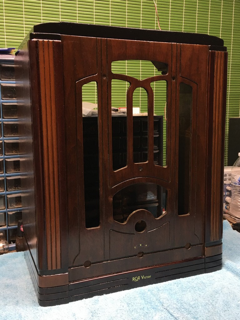

Well, kids, when ol' Uncle Ron last posted, I had just completed the first stage of toning - that is, spraying the whole thing Medium Walnut.
Since then I have attempted to two-tone the front columns and the bottom veneer on the sides, as well as the bottom trim.
First I tried Medium Brown Walnut. It did not seem to be having much of an effect so I then tried Dark Walnut. This only made the trim redder, which was not what I wanted. So today, I masked it all off again and sprayed a fairly light coat of Extra Dark Walnut (Ultra Classic, the toner with dye). It is still rather red to my liking, and there isn't much contrast at all between the darker sections of the front columns and the front panel since the front panel turned out quite red also even though I used Medium Walnut (Tone Finish, the pigmented toner) on it.

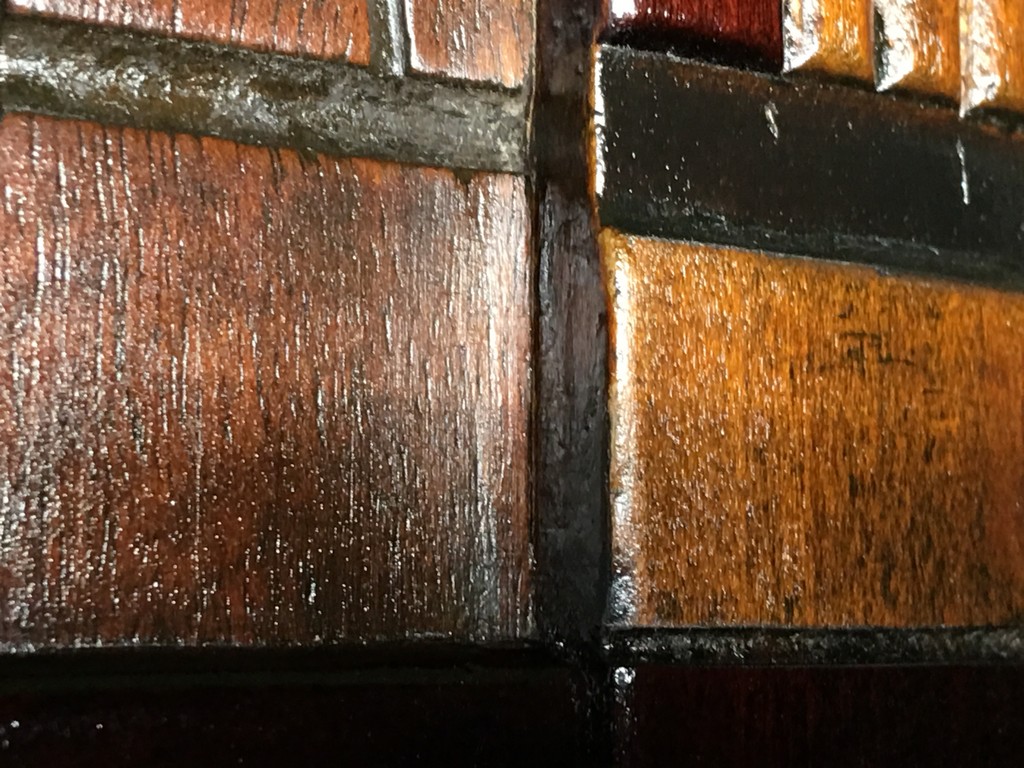

Now, after yet a third round of masking off and spraying toner - this time Extra Dark Walnut (Tone Finish) on the top shoulders, top trim, and the inset "stripes" at lower left and right - here is how mine now looks:
[Image: http://www.philcoradio.com/images/phorum...-5_115.jpg]

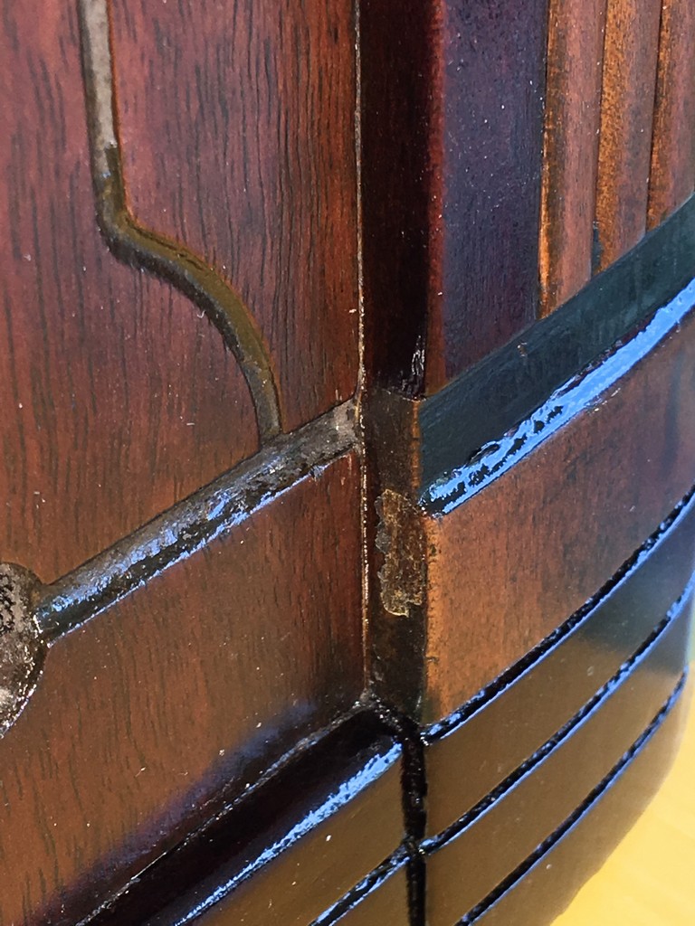

Things did not go without issue. When I removed the newspaper and green Frog tape after spraying the columns and bottom trim the second time, a piece of veneer came off from the lower left corner of the front panel! Yikes No Icon_cry
After walking away from it for awhile, I returned and tried to remove the piece of veneer from the tape as best as I could. It came off and splintered into pieces, of course. I did manage to glue the pieces back into place but a very small chip had disappeared nonetheless. This was filled with a little bit of Timber Mate. The cracks that remained after gluing the veneer fragments were also filled with Timber Mate.
[Image: http://www.philcoradio.com/images/phorum...-5_116.jpg]
I will touch that up with a little Medium Walnut sprayed into a can lid, and will apply it with a tiny brush.

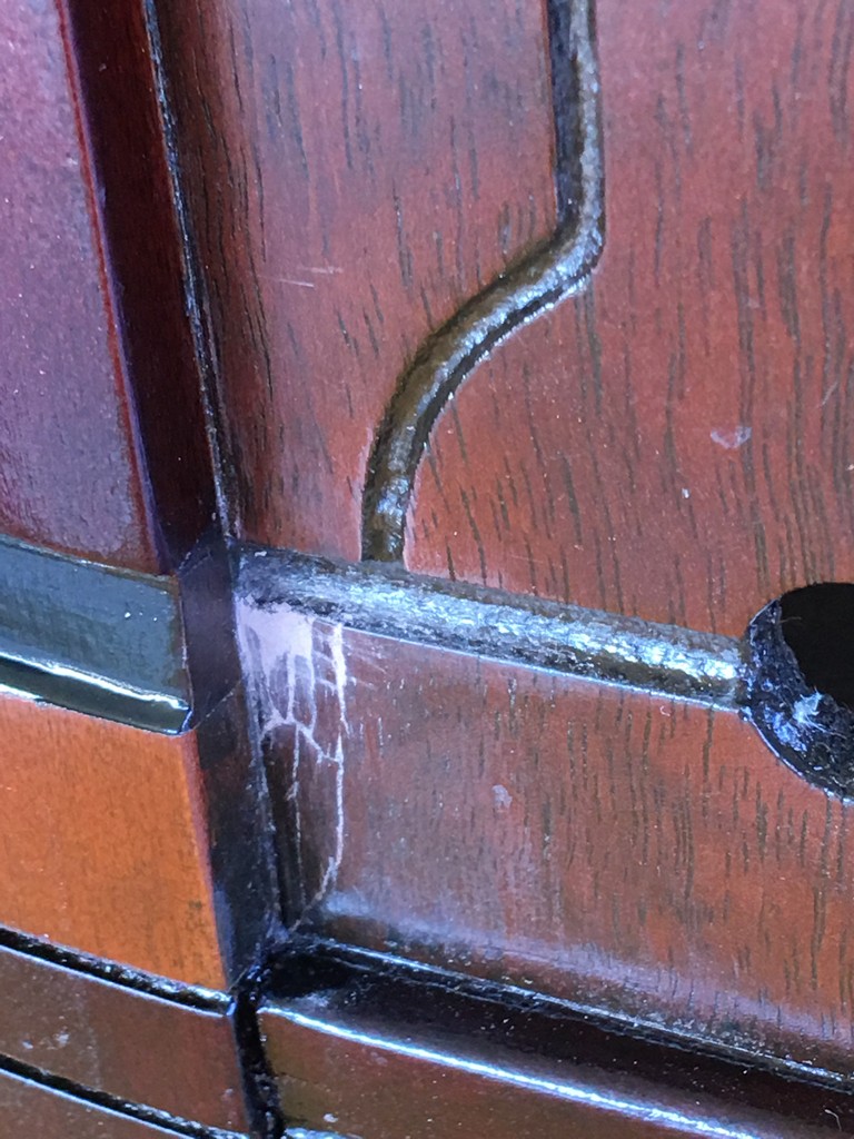

Now, after the third round of masking off and spraying the top shoulders and bottom left and right stripes, a little bit of finish pulled off at lower right of the front:
[Image: http://www.philcoradio.com/images/phorum...-5_117.jpg]
I will wet sand this area and then touch it up in the same manner as above.
All of my 2018 cabinet work has been a bit of a battle. But I'm slowly getting there. Next comes application of the band switch decal and the RCA Victor decal...then the start of clear lacquer.

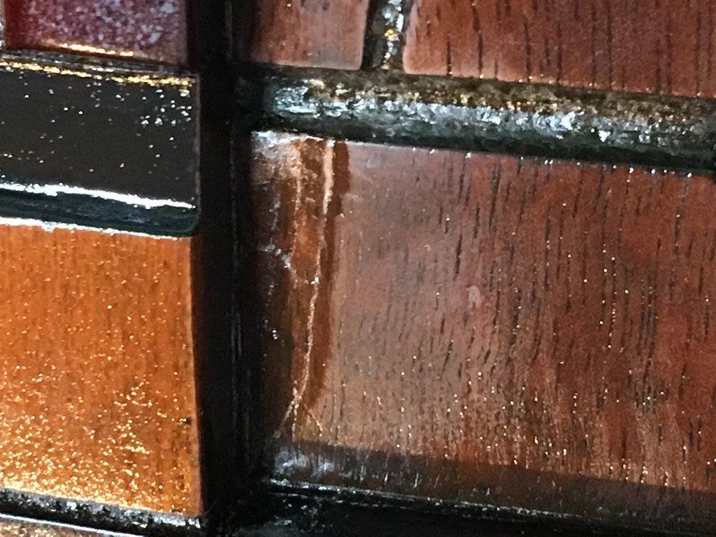

A little while ago, I touched up the repaired veneer at the lower front corner of the front panel, and the spot at lower right front where the finish had lifted.
The results:
[Image: http://www.philcoradio.com/images/phorum...-5_118.jpg]
[Image: http://www.philcoradio.com/images/phorum...-5_119.jpg]
Not bad. I think this will do just fine. After some clear lacquer and some wet sanding, it should look somewhat better.

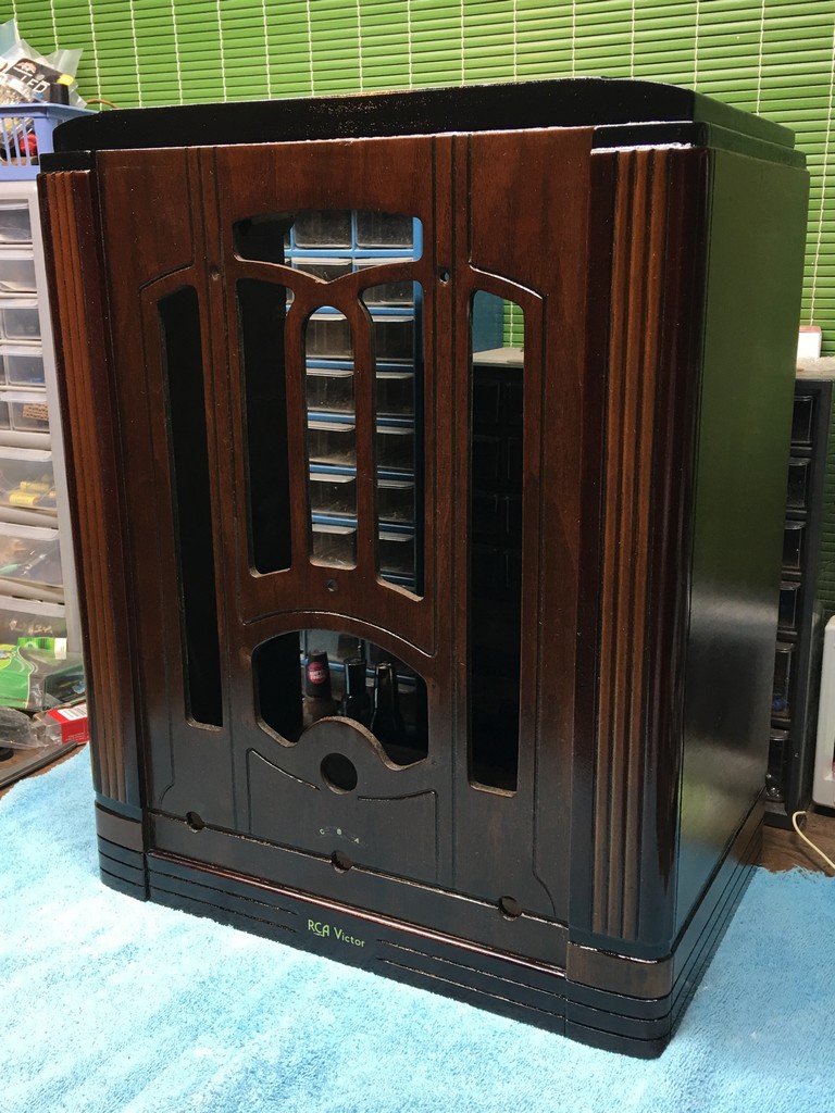

While I was at it, I went ahead and applied the two decals.
So, as a reminder, here is how the cabinet looked to begin with:

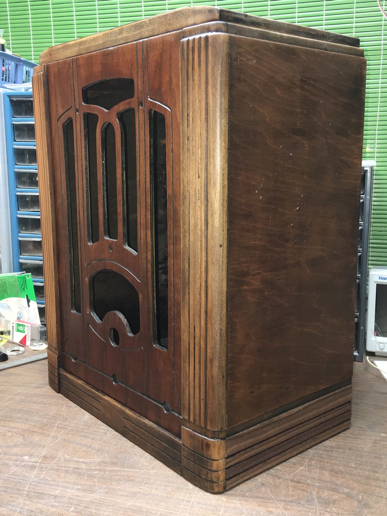

[Image: http://www.philcoradio.com/images/phorum...-5_001.jpg]

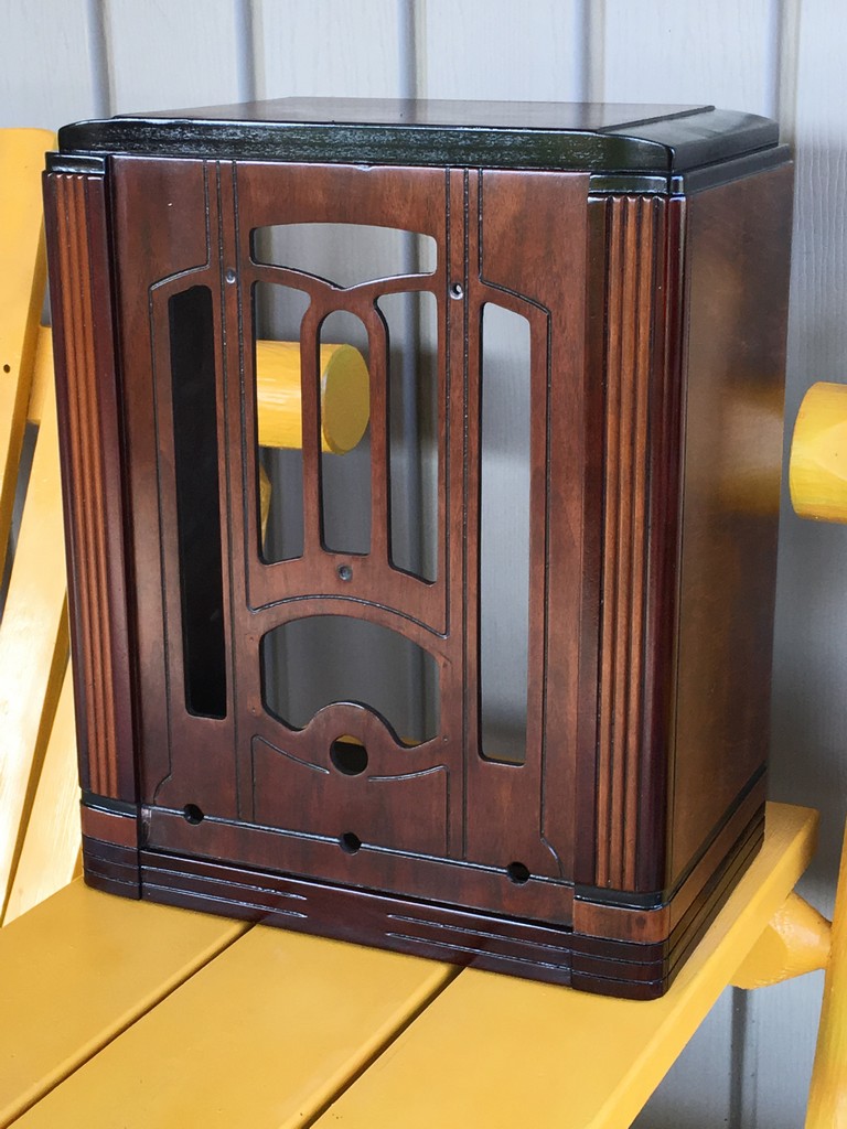

and how it looks now:
[Image: http://www.philcoradio.com/images/phorum...-5_120.jpg]
[Image: http://www.philcoradio.com/images/phorum...-5_121.jpg]
The next job is to go around the grille openings with brown lacquer, then start spraying on clear lacquer.
