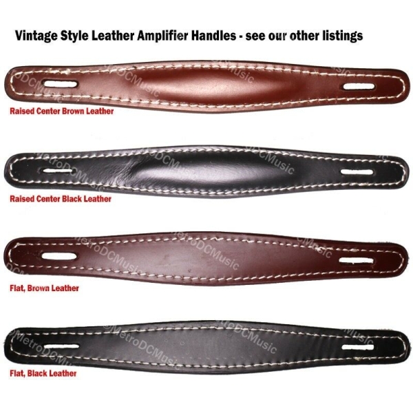

The same seller you linked to with real leather also has a handle with a raised center, I wonder if this would look better than a flat handle:
(This post was last modified: 02-27-2019, 10:02 AM by Eliot Ness.)
John
Yes, it will look better, but it is the same handle I have now - artificial. If you look at the side of the handle in that listing, you will see it is not leather. He probably gets them at the same place in China.

I have seen some genuine U.S.A. made leather handles that look pretty good but they are $40 +. Hopefully the leather handle on eBay works out well if you decide to order it.
