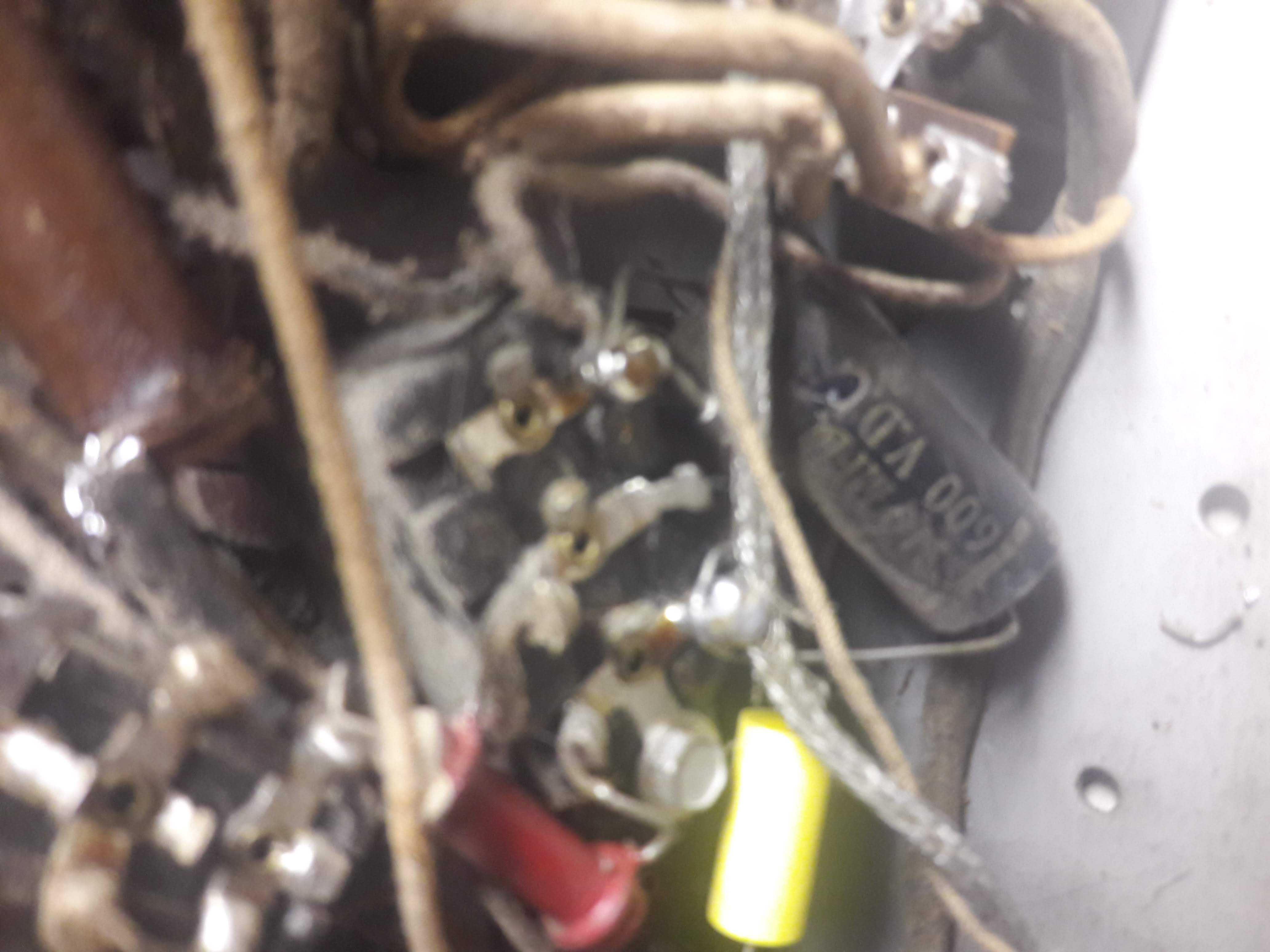

Also my radio came with the optional headphone jack on the back for private listening and there is a paper cap going across it and its not on the service data.
Anyone have any idea what should go there?

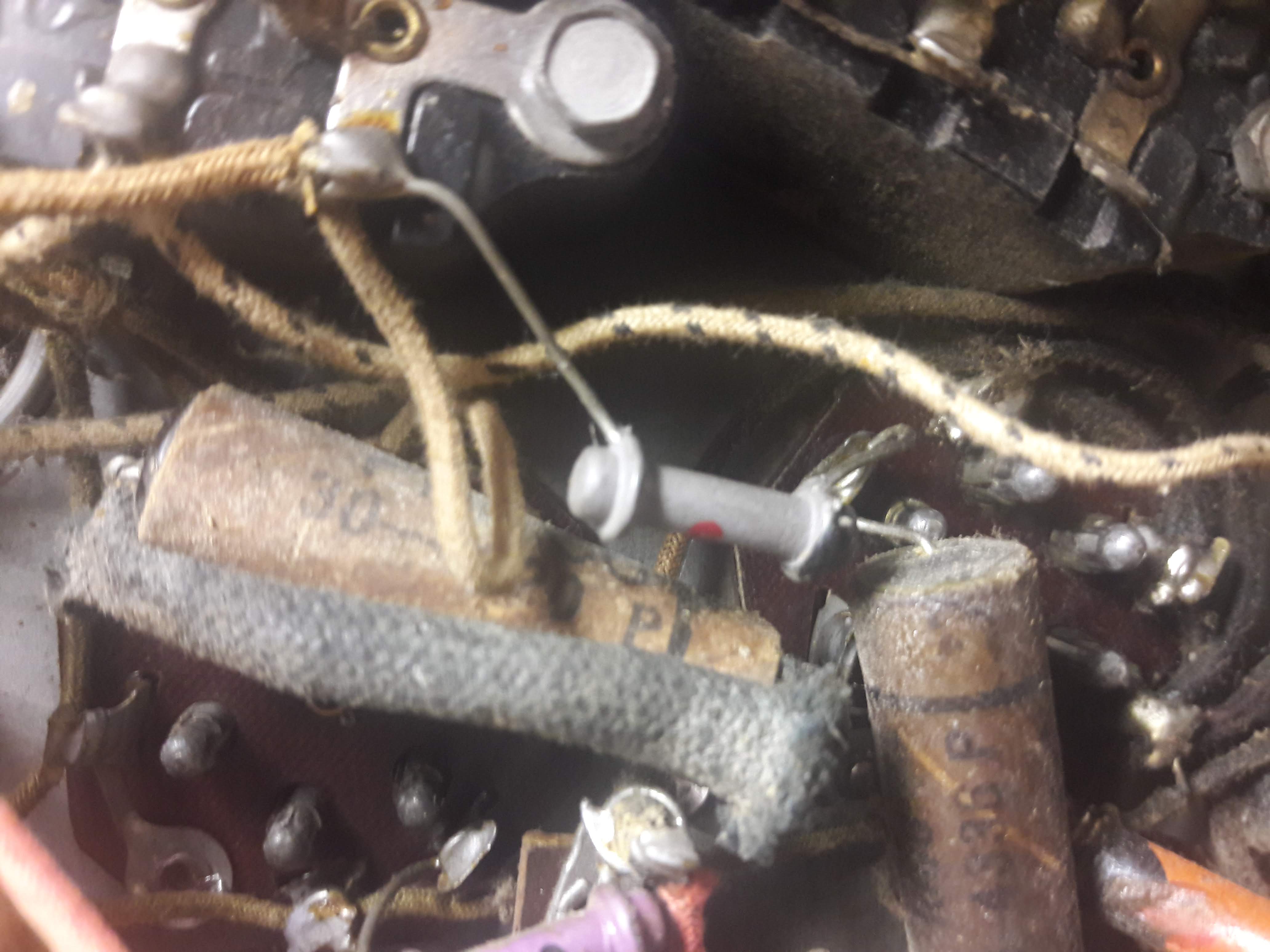

Posts: 1,519
Threads: 69
City: Kansas city, MO.
Probably a resistor across the cap and covered. Hard to put in perspective with close up pics.

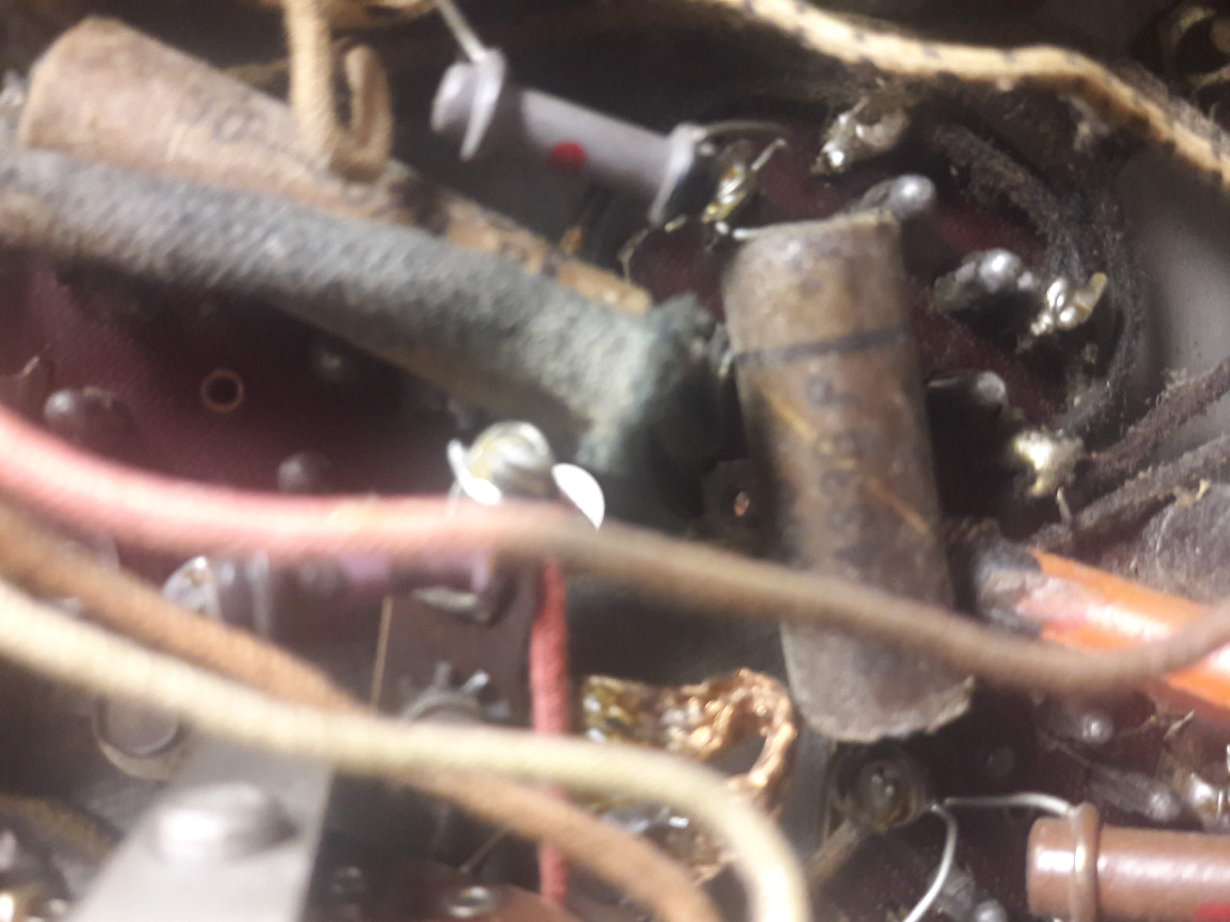

I figured out what the black thing is on top of the one capacitor, its a 300 Ohm wirewound resistor of the flexible variety, which I was told to just leave that capacitor alone because that resistor that's attached to that capacitor shouldn't be moved around too much as it could break.
