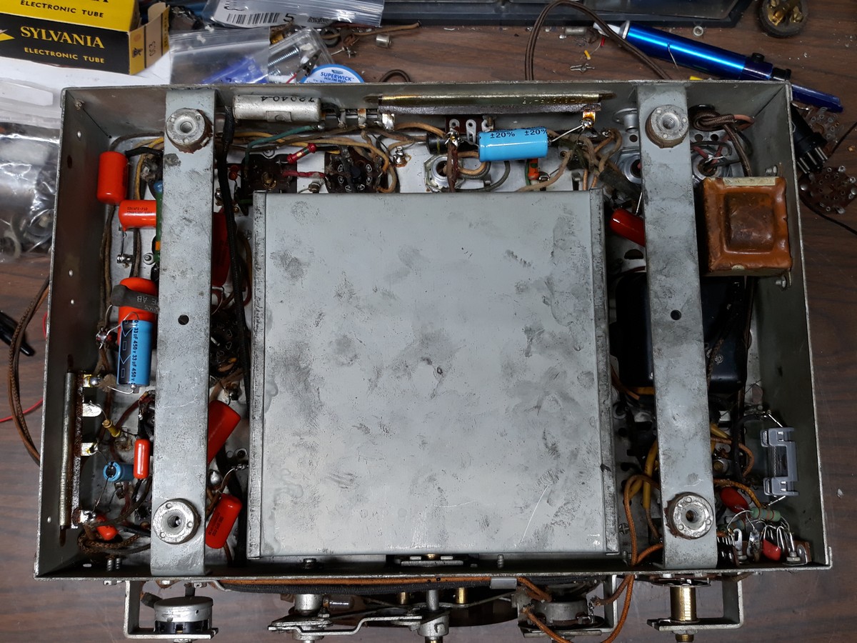

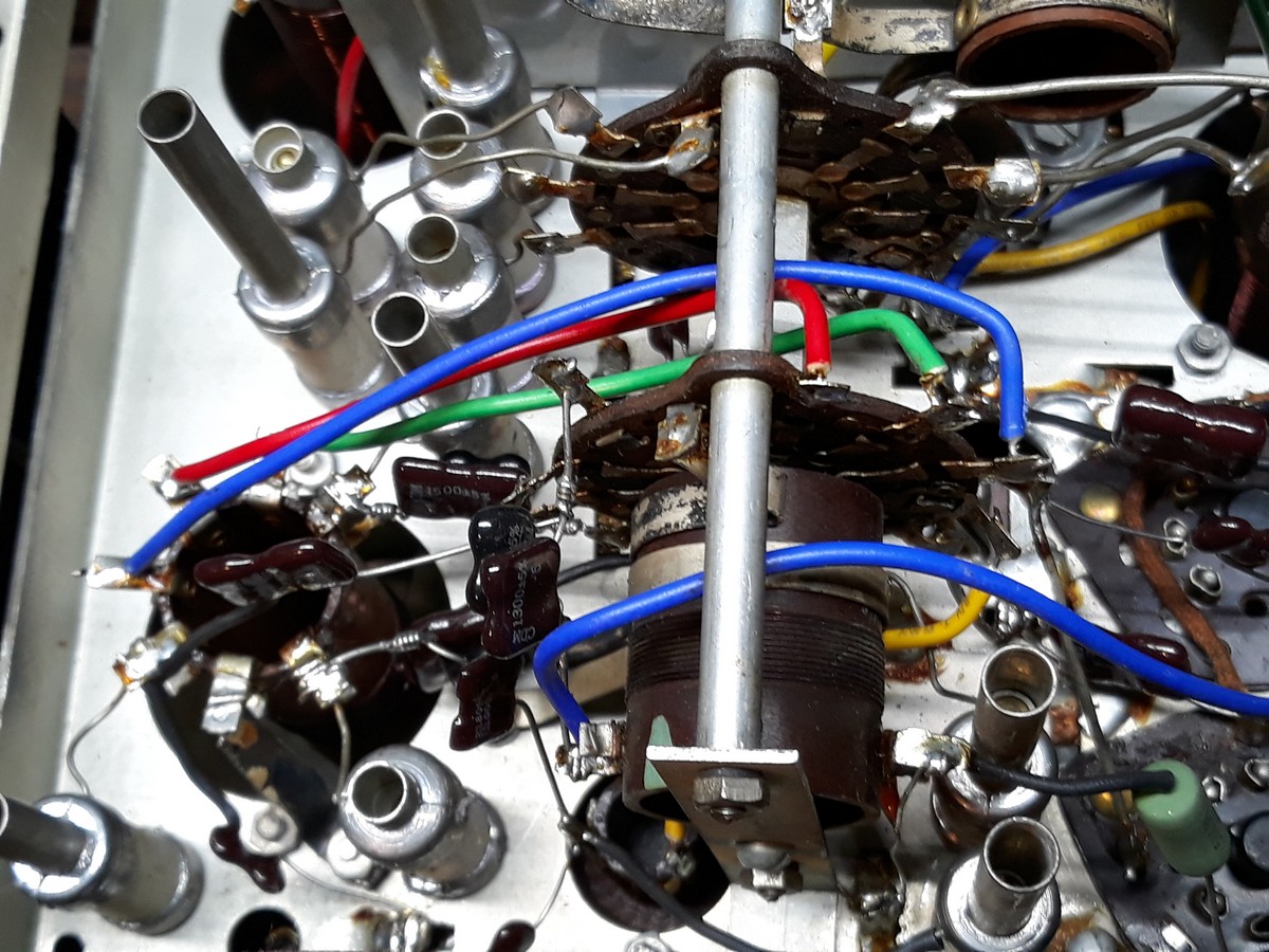

So I did not remove the Magic Brain, but I did remove the top and bottom shields so I could merely flip the entire chassis over and have access to the bottom of the Magic Brain unit. I wanted to specifically examine the area around the oscillator tube and its associated coils, capacitors, and wiring.
Take a good look at the photo below. There will be a test later.

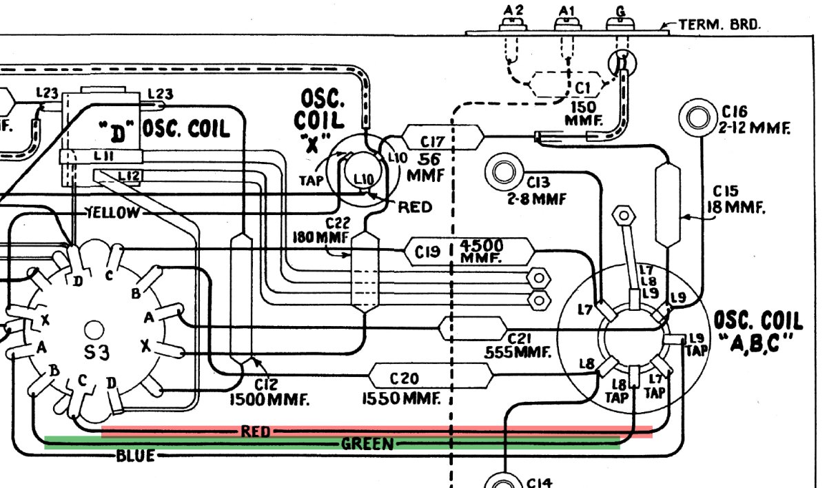

Now carefully examine the partial under-chassis wiring diagram of the oscillator portion of the Magic Brain. Again, take a good look, keeping in mind that this diagram is upside down in relation to the photo above.
Do you see the mistake I made?
Give up? Well...I accidentally switched the red and green wires at the band switch.

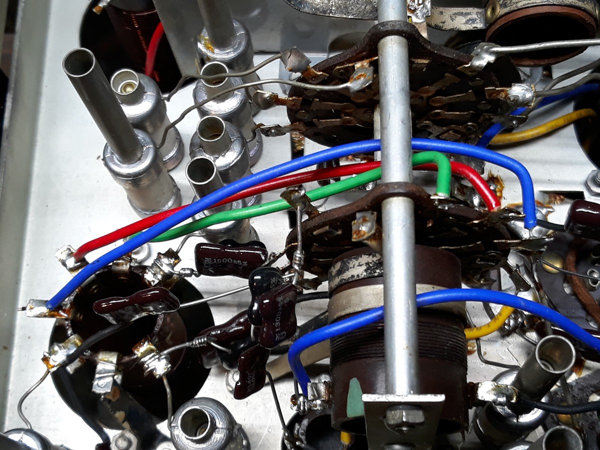

After unsoldering, switching and resoldering, it looked like this:
Now it matches the RCA diagram.
Did the wire swap fix the "No SW" issue?
You be the judge...
