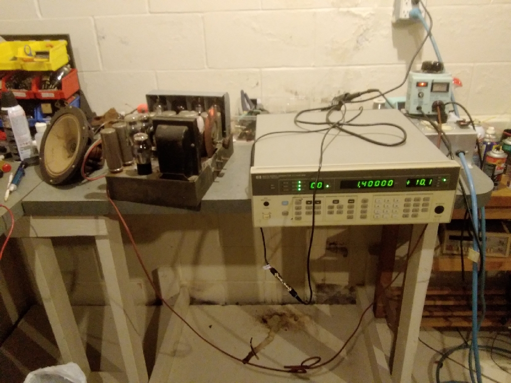

Today I swapped the gear from that chassis I bought years ago in Kutztown with mine, as I noticed the tuning cap rotated just fine despite being very grimy, so after this my tuning works just fine.
Maybe the groove was worn, maybe the spring was no longer springy enough
After this I aligned the radio, which went fine, 70 alignment is very easy and simplistic.
Have to say the trimmers padders are sensitive to lateral force so when using a formidable tool I had to constantly stabilize it by hand from it weighin down on the trimmers. But it worked fine.

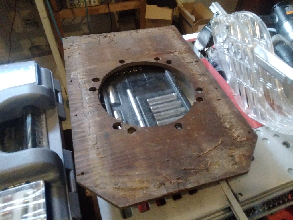

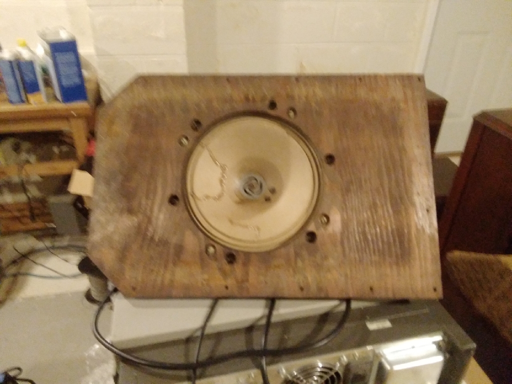

Here is the cloth side of the baffle. The cloth is on this side, the speaker on the opposite.

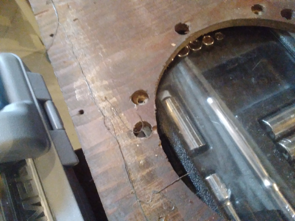

Now here is where the screws go that hold the speaker.
As you can see the screw head will be covered with the cloth. If the cloth is glued then the screw has to rip it to go in.
If I want for this to not happen I need to first attach the speaker. But then gluing the cloth become cumbersome as the baffle no longer could be layed flat on the table because of the speaker.
It is possible the screws are hidden behing the cabinet opening and my worries are unfounded, but I have yet to look into this. Also unlike in many radios where screws merely puncture small hole, these have to fully go under meaning that the hole is the size of the screw head which is large.

Interesting problem. Maybe you could bolt the speaker on then lay it into a box a little smaller the board, then you could glue the grill cloth on.
Just tossing out an idea.
Mike
Good idea, actually.
As long as I have the box and it is sturdy enough to not collaps when I press to smooth the cloth.
Also I will have to protect the cone while spraying the 3M glue.

As can be seen, the screeholes are in the cutout and so have to be covered.
This was not very smart. It means the if something happens tothe speaker that requires its removal separate from the baffle (rewinding the voice coil) the whole thing then has to be re-clothed.
So...
(I have the second baffle from the days of yore when I bought the second (then it was the first) chassis, and a bad speaker with the baffle for $15.)
Here's the plan:
1. Use the second baffle as the pattern and cut the piece of 20/70 cloth to the size exactly, save for the tapered top corners.
2. With the speaker mounted
a) protect the cone with a piece of paper.
b) spray the glue
c) stretch and glue the cloth.
I guess, I need to iron the cloth after spraying it with starch spray first.
Also, I noticed at the top the cloth was tacked by two small staples and at the bottom with a few brads.
I wonder if I should reuse the brads, or should I do it a bit differently, as I usually do it, and cut the cloth oversized and then staple it on the opposite side after having glued it to the top surface.
What do you guys think?

I think I'd glue and stretch. Adding brads/staples certainly wouldn't hurt. Even with synthetic cloth I've found that after the glue is dry a light mist with water followed with a hair dryer helps tighten it up if needed.
