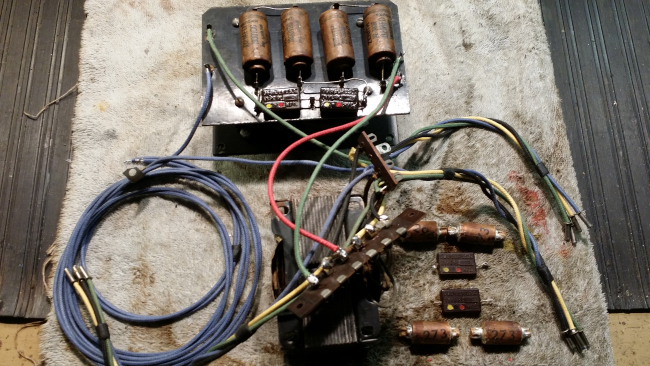

This picture may help with understanding the construction of "stick" caps.
Old parts in the lower rt.
New (rebuilt) caps mounted to audio crossover board, top center.
This is out of one of the Strats that I rebuilt.

The caps turned out pretty good Bob
Interesting construction on those little buggers.

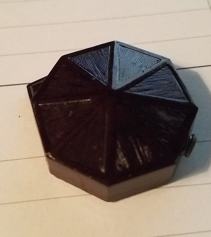

I did clean up the back of the set and painted it a gray that was just a little lighter than the original gray coating. I do need to find a period knob for the band switch but that will have to wait until I can get to Kutztown next time.

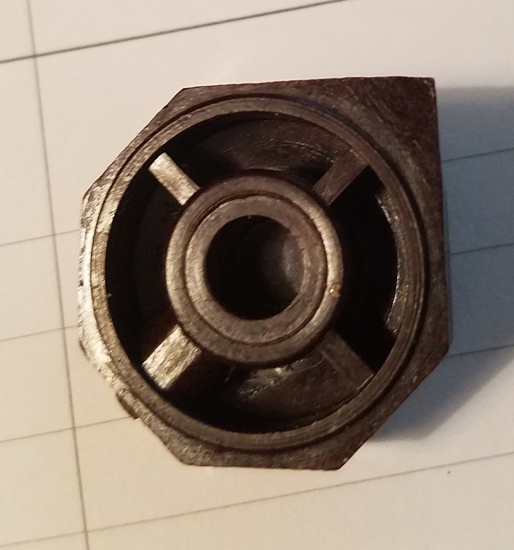

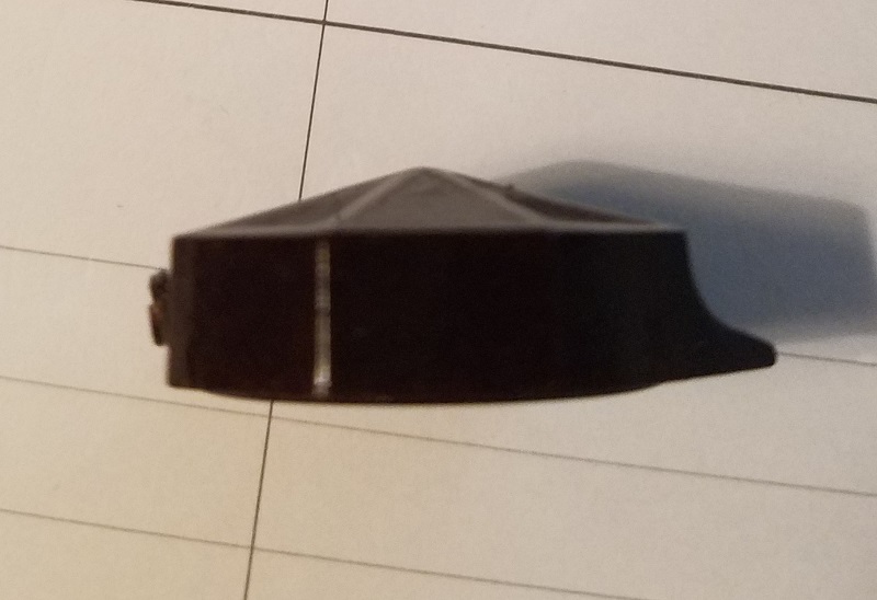

The new knob fits perfectly and matches the front! Thank you Greg (NostalgiaRadioTime)!

Despite your displeasure with the appearance of the chassis the radio displays well and the back of the set also looks good, especially with the correct knob. Good save Bob
