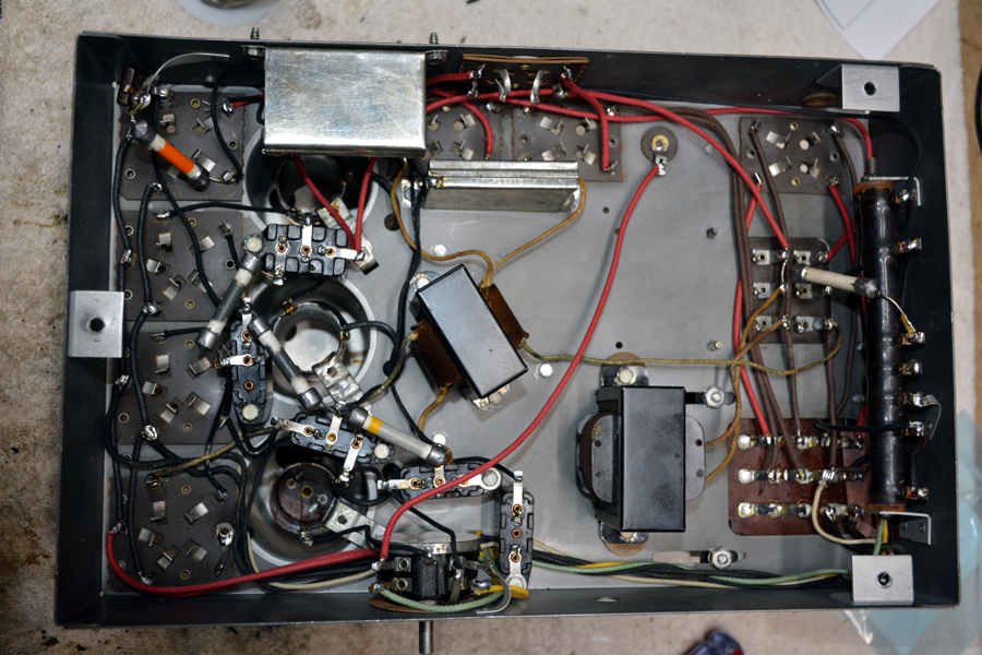

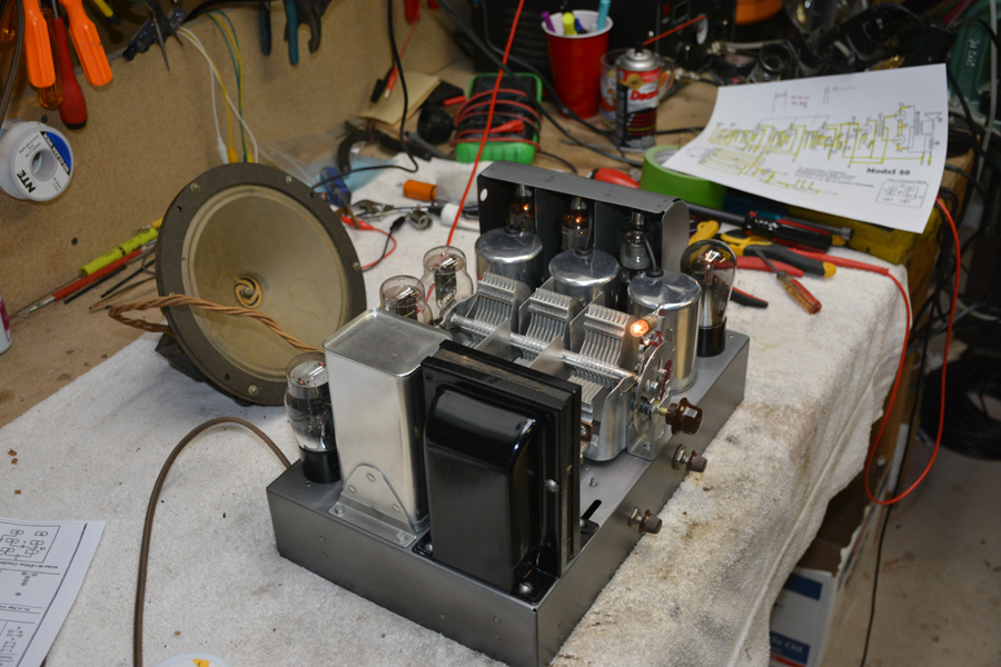

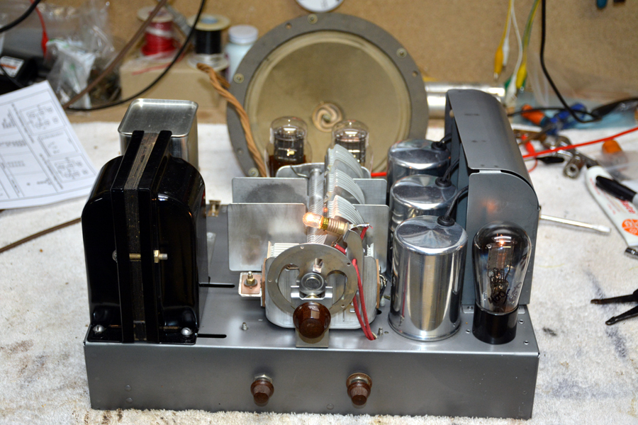

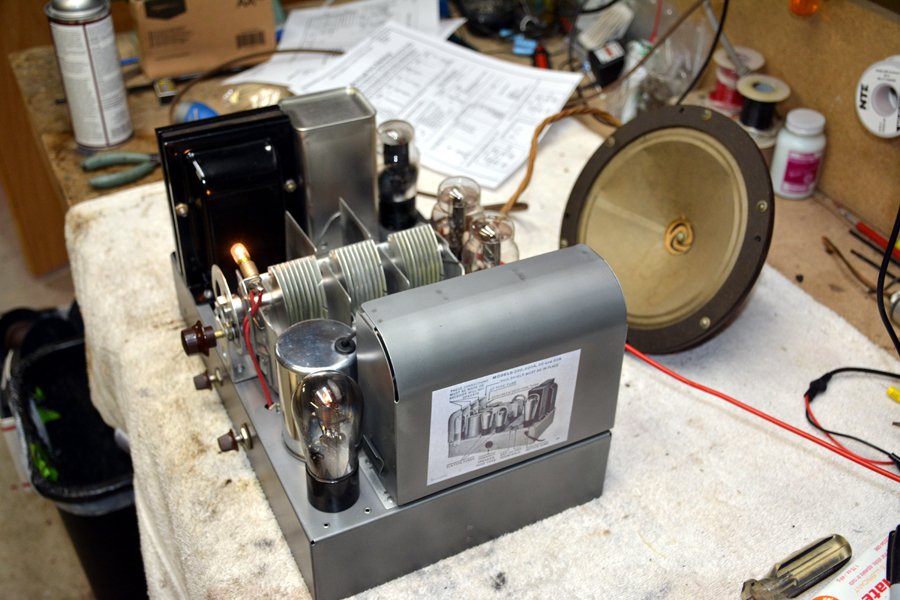

It plays again.  The resistors ore the originals with a parallel resistor hidden underneath to bring each resistor back to specs (I took the picture at an angle that hides all of them!).   The chassis is the original plating cleaned up with a very thin clear coating to protect it. Arran, I didn't realize that some rust removers may leave a protective conversion coating.  I may just rely on that in the future!  The tin plated tuning cap certainly looks different than the chassis but I really don't mind.  Kind of matches the capacitor can.  Next, I need to work on the speaker a bit to clean it up.
Question:  Most voltages are reasonable given the higher line voltage (thinking of adding a bucking transformer) except on the 2nd detector.  The chart says that the plate voltage should be 35 volts.  I get closer to 110 volts.  The grid is only about 2 volts negative compared to the cathode so the tube should not be close to cut off causing a high plate voltage.  Screen is at about 10 volts rather than the 2 volts listed.  This voltage comes directly from the voltage divider through a 250K resistor.  Result is the same with different tubes.  Any ideas?
The radio is tuned to 740, Zoomer Radio, Toronto in these photos.  Sounds okay except for the fading in and out. Love AVC (which this doesn't have)!  Not a problem if I tune to my local transmitter, though.  So far, I don't hear the distortion from the detector like I hear in the 70.

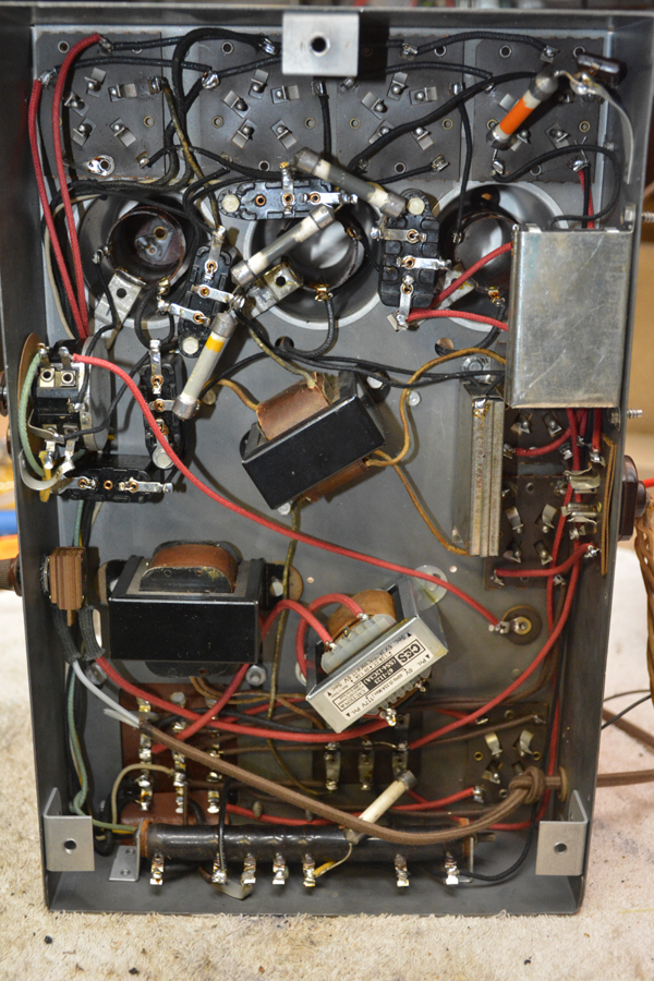

Decided to add a bucking transformer.  There was considerable real-estate under the chassis so I decided to add it there.  Easily removable.  Drops the voltage to about 106 vac to the power transformer.  Radio works fine at that voltage.

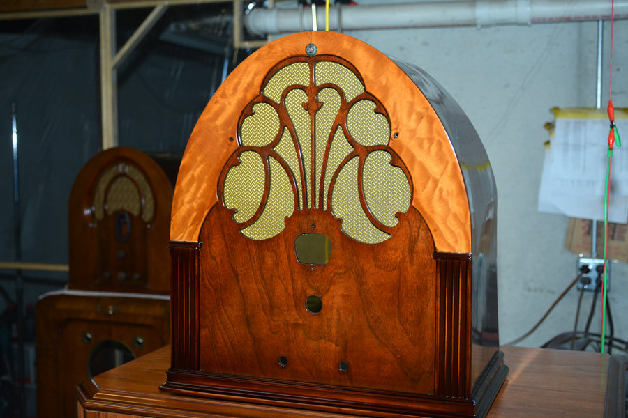

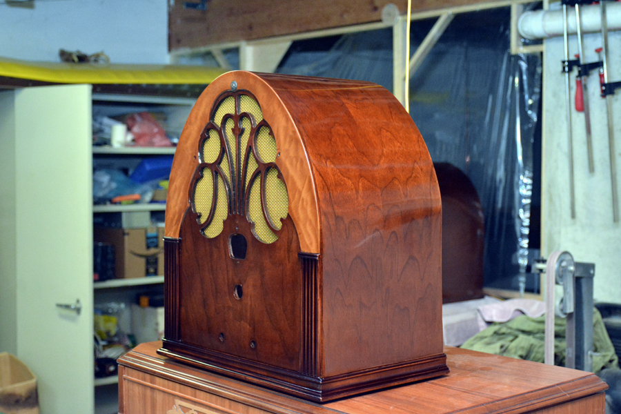

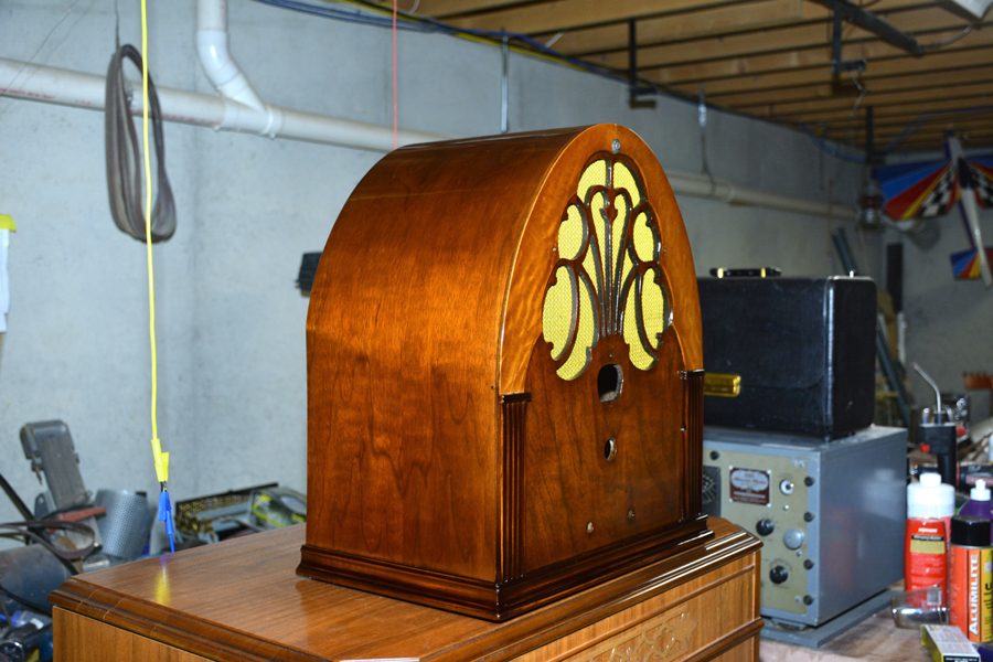

I think I'm finished with the cabinet.  Some may not like what I did with the trim, but oh well!  I wanted to give it a bit of "character" and a little worn look so I toned it then rubbed lightly with 0000 steel wool to take a bit of toner off corners. The camera flash makes it look more pronounced than it is. Now to put the radio back in.  Grille repairs turned out ok.  There was a lot of loose veneer and broken "core" wood. I wish I could find the grille fabric that more closely resembles the original. Not a huge fan of the herringbone.

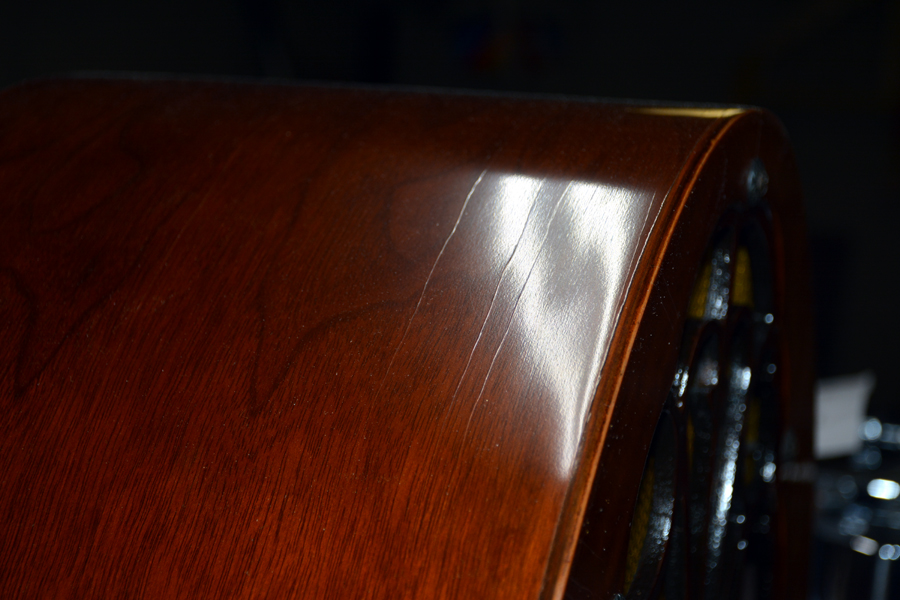

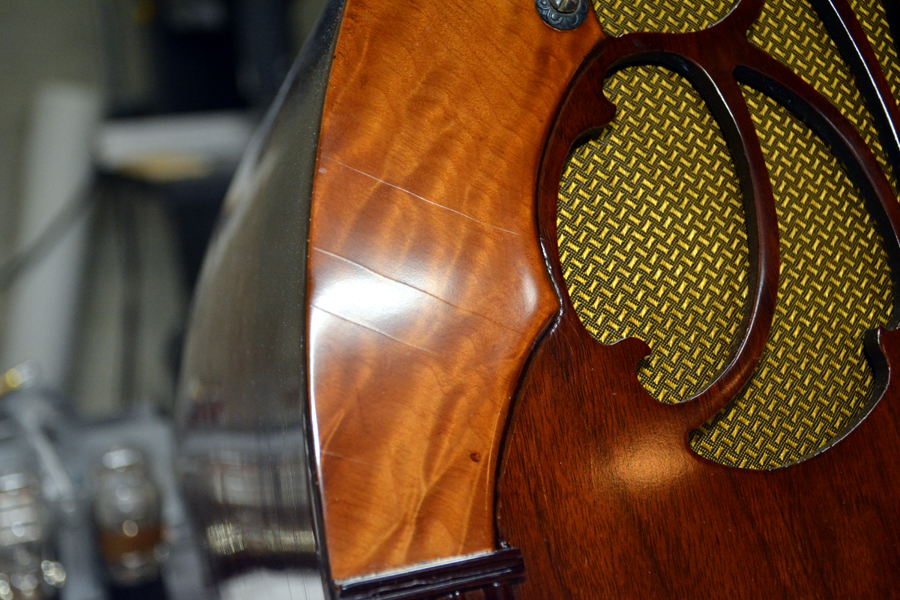

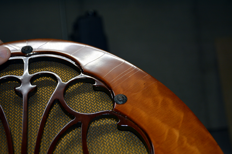

Ya Mike, you got that right! Not a great radio. It will be a shelf queen. Since those photos were taken, the lacquer finish cracked in many locations, even on the sides where the finish was kept especially thin. Not sure what the problem is, but it may get stripped and done over. Perhaps I did not allow enough time between coats. Perhaps the cabinet moisture content was not stabilized. Not sure. I have a request for info in to Mohawk, but have not heard back.
