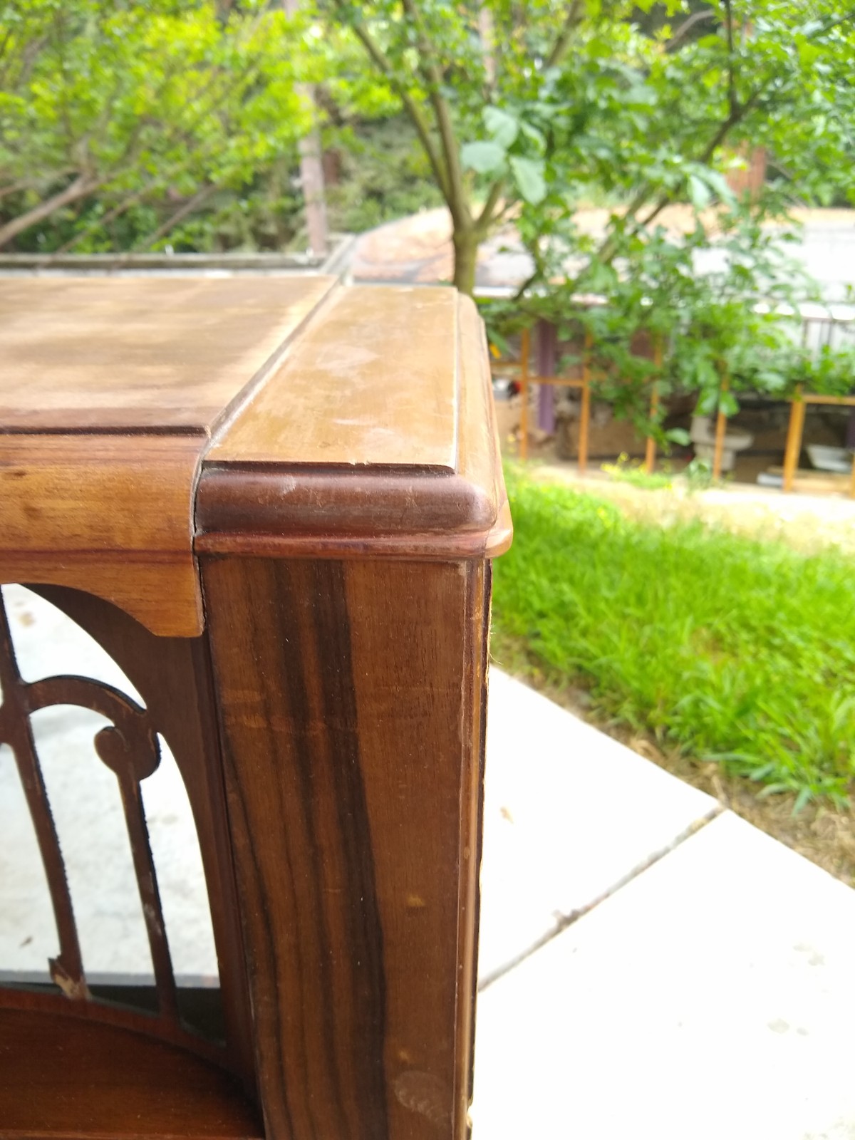

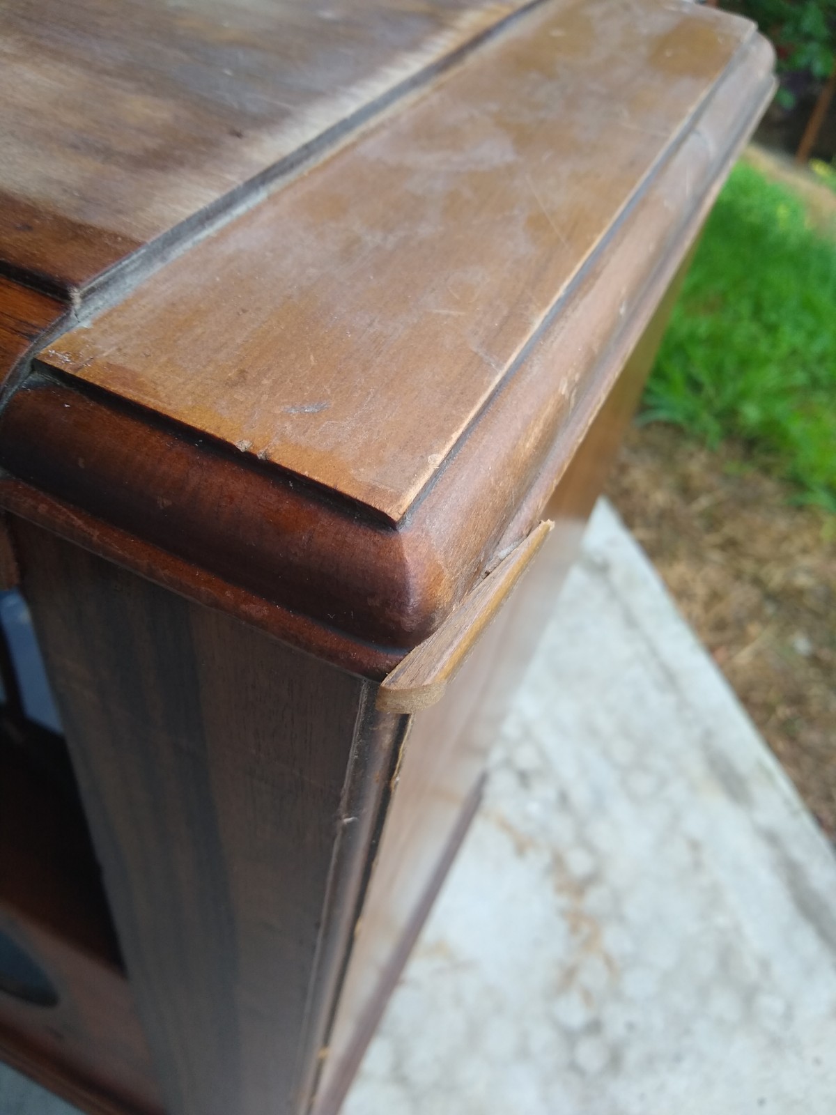

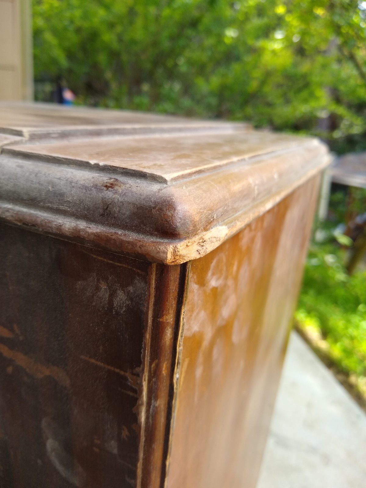

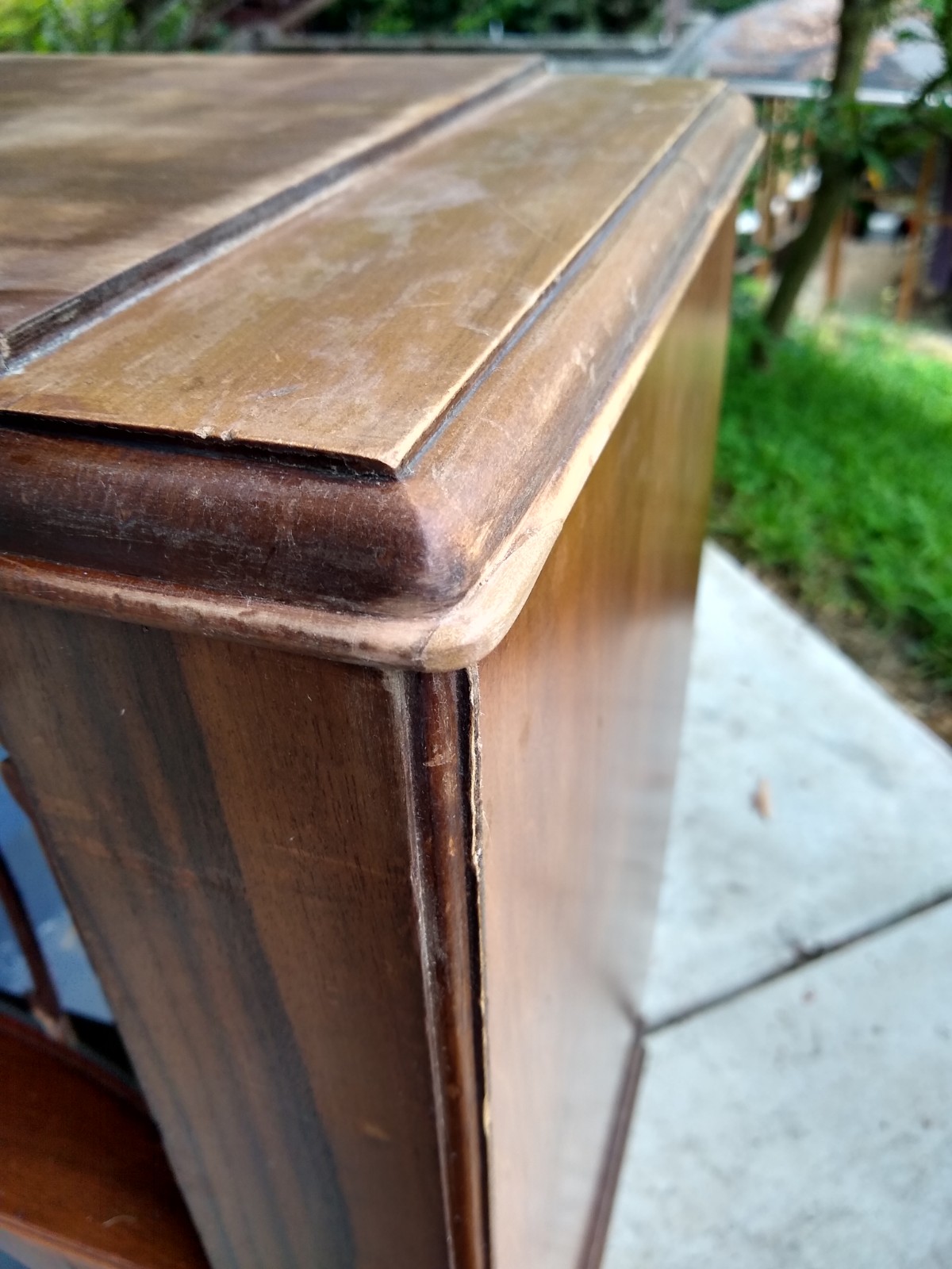

Cabinet work this weekend. I don't object to some patina, but chunks missing are another matter.
The surface was carved and worked flat, to enable gluing of a repair piece.
Careful carving and sanding restored the profile. Staining and detailing will ensure a match. I'm pleased with the results so far.

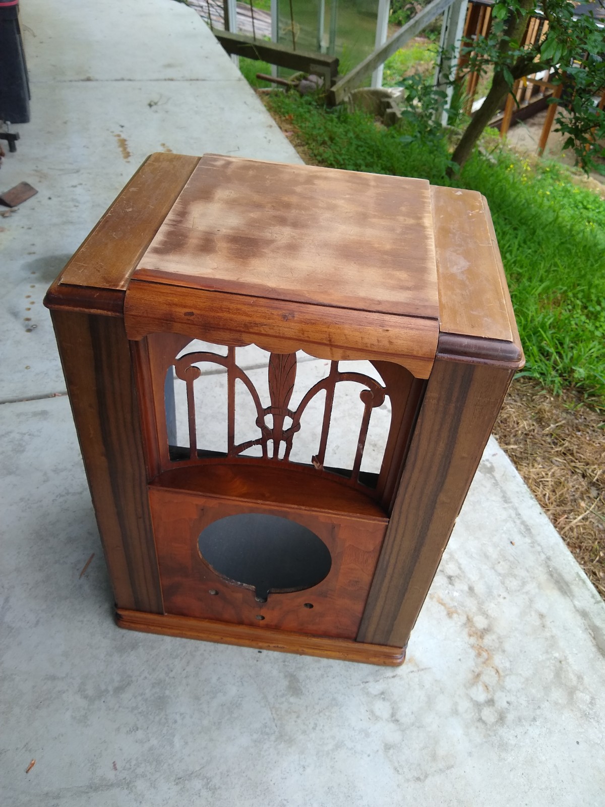

Here's the latest view of the cabinet. Yes, I still need to repair the grill, and will likely work on that this weekend. I have a section of material cut to shape, and on some similar material, tested the wood stains I have and found one that provides a nice match.

  Don't bother with the wood stain, the only type that works is penetrating stain or wood dye. Shading lacquer, such as what Mohawk or Deft sells, is what they used originally, and will cover up a multitude of sin in terms of stains, and repairs.

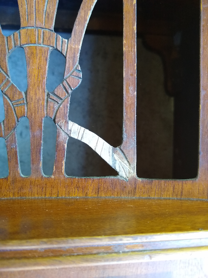

This weekend allowed quite a bit of time to work on the radio. On the cabinet, I found a few more areas of the delicate grille that were delaminated, and also another couple of weak spots, so set about getting those glued. To repair the missing piece, the repair part was trimmed to match, plus some overlap which was feathered down in thickness. The points where it would meet the rear of the original grill were also thinned. This allowed for the front surface of the repair to be level with the rest, while providing plenty of overlap for gluing in to place. I also carved the details into the repair, to match the design on the other side. This was very fiddly work, but the piece was completed and set carefully in to place with glue, first using tape to allow position to be set, then a clamp on each overlapping joint while it dried. No pictures yet, and anyway, it needs to be toned to match as it sticks out like a sore thumb at the moment. However, on tests I did with some similar material, it will be possible to get a very acceptable match. There is a tiny bit of grille surface to be replaced just adjacent to the repair part - this was near the messiest part of the break and must have fallen apart thanks to the carved details in the top ply - any pieces were long gone before the set came to me, but they can be replicated with a little care.

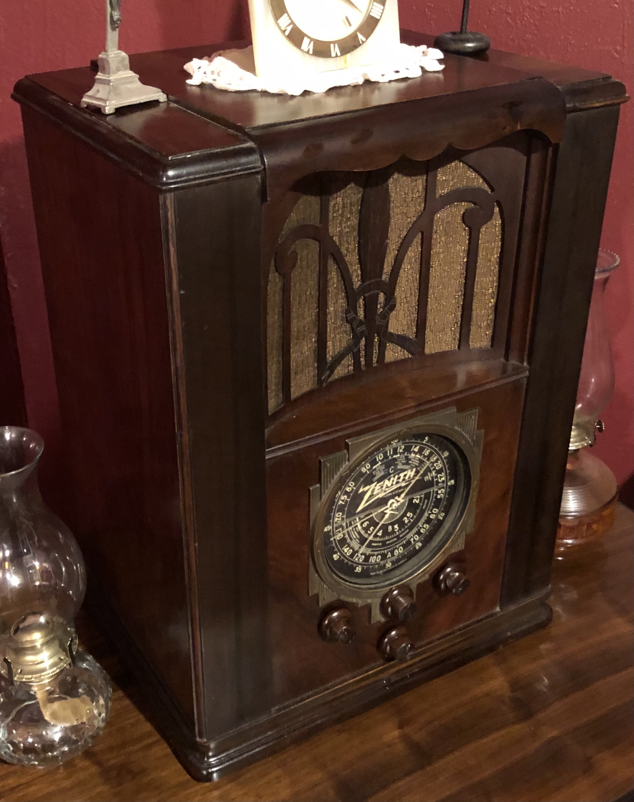

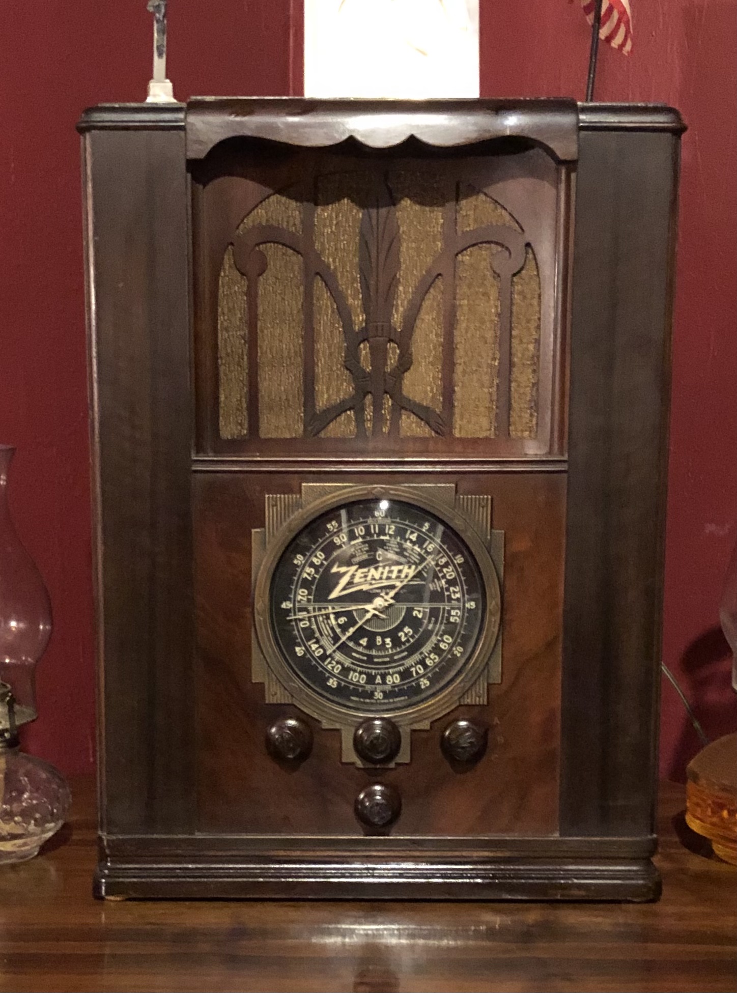

I just cleaned up my 6V27. This is how it looks, in a room a little short of lighting.  Didn’t strip it, just a good cleaning and wiping with Howard’s.
The pilasters, which have Australian laurelwood veneer, will come out darker than the rest of the set.
#39
Thanks for the pictures - nice radio. It's also helpful to have your notes on colours.

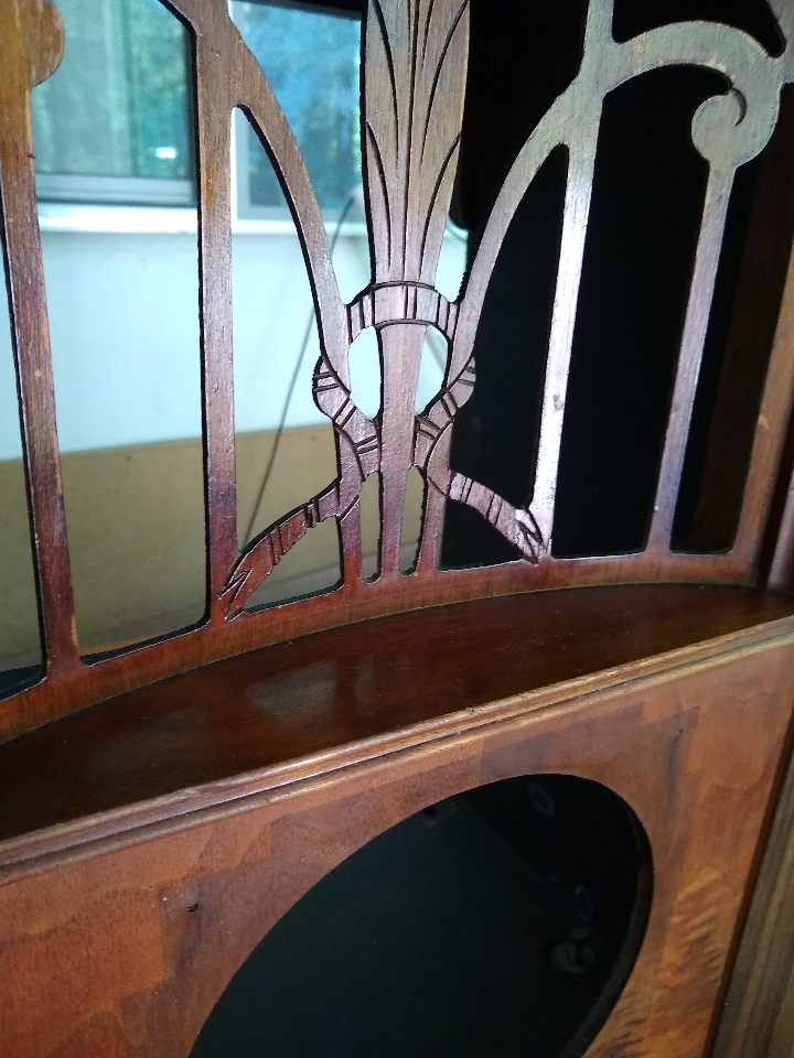

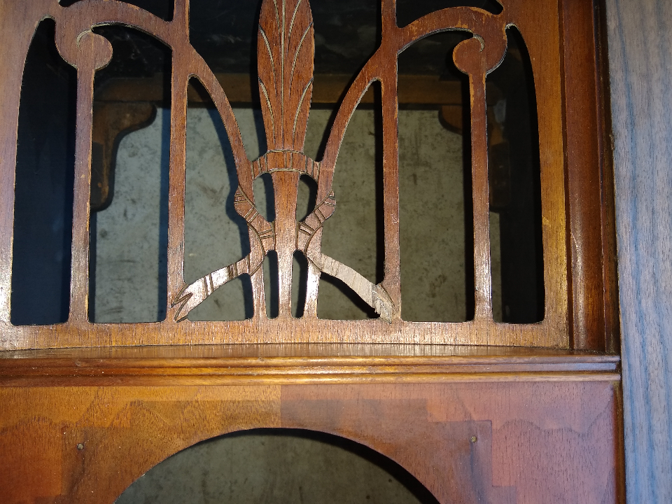

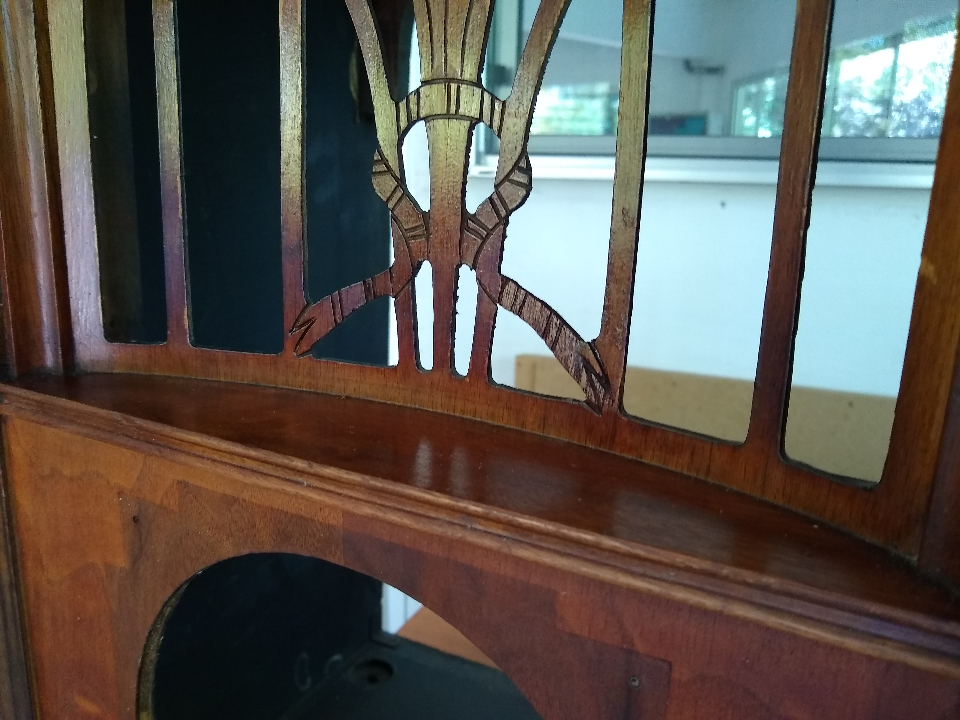

More progress today, and I think I have the repair to the grill to a satisfactory standard.
Here's the repair piece glued in. Where it joins the vertical bar on the right, I have marked out the carving required. At this point, there was still a littl shaping required to match its counterpart on the other side.
Very carefully, I completed the shaping, and carved the groove details
Then a little stain on the new wood, plus a little shellac, just to see how things are going to work out.
#42
It will never be perfect - or original - but I feel this has turned out well. The damage to this area was something that almost saw me walk away (but of course I couldn't in the end) and so it becomes a challenge. Then again, I have a hard time seeing 80+ year old wonders like this meet their doom.
