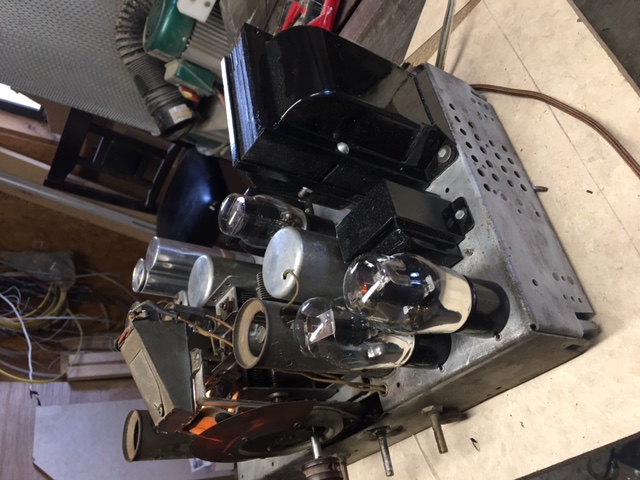

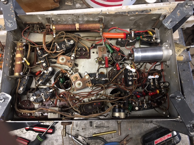

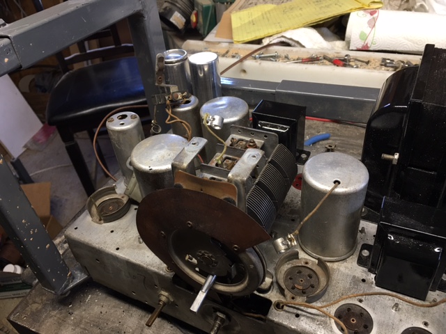

I took some time away from the 118 for some other projects, now getting back to it.
All of the Bakelite blocks have been re-stuffed and several out of tolerance resistors have been replaced.

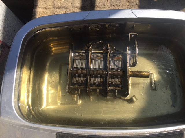

Today I cleaned the tuning condenser
I removed the mica trimmers, then used my Harbor Freight ultrasonic cleaner filled with lacquer thinner, working outdoors, of course. After about ten minutes, the plates still had a thin film but it could be wiped clean with a rag. I then put the condenser in the dishwasher and ran it for a cycle.
After washing, I blew the condenser dry, oiled the bearings, reinstalled the dial and trimmers.

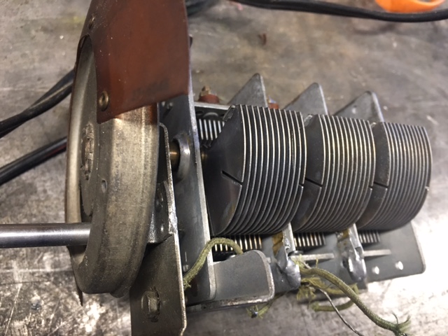

The tuning condenser has been reinstall on the chassis.

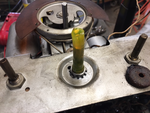

I haven't made too much progress on this radio lately. The weather has been so nice, I have been working on some outside projects and doing a little fishing.
After installing the tuning condenser, I noticed the band switch was very stuck. I first tried heat, using a propane torch I applied heat to the shaft bushing. After a few seconds of heat the shaft turned quite freely but, as soon as it cooled down, it was stuck again. Next, I tried spraying the shaft and bushing with WD-40. The WD-40 did not seem to penetrate. So, I cut a short piece of Tygon fuel line and pushed it down over the threaded portion of the bushing. I then filled the tubing with WD-40, sort of as a reservoir. It took about a week for the WD-40 to soak through, I was then able to turn the shaft. After working the shaft back and forth for a minute or so it became easy to turn.

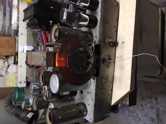

Today I had some time so, I got back to the project.
I brought the supply voltage slowly and the radio came to life. I was able to tune a couple of stations near the upper end of the dial but, nothing at the lower end. It is no surprise that the alignment is way off as I removed all of the trimmers when I cleaned the tuning condenser. I will do the alignment and probably just put the chassis on the shelf until next fall, then make a cabinet for it. The problem I have is, I only have two K-17 speakers and I have two Philco 16 chassis that I want to use those speakers for. The early 16B, 17B, 18B and the 118B are the only Philcos to use the K-17 speaker so, that make them a little hard to find.
