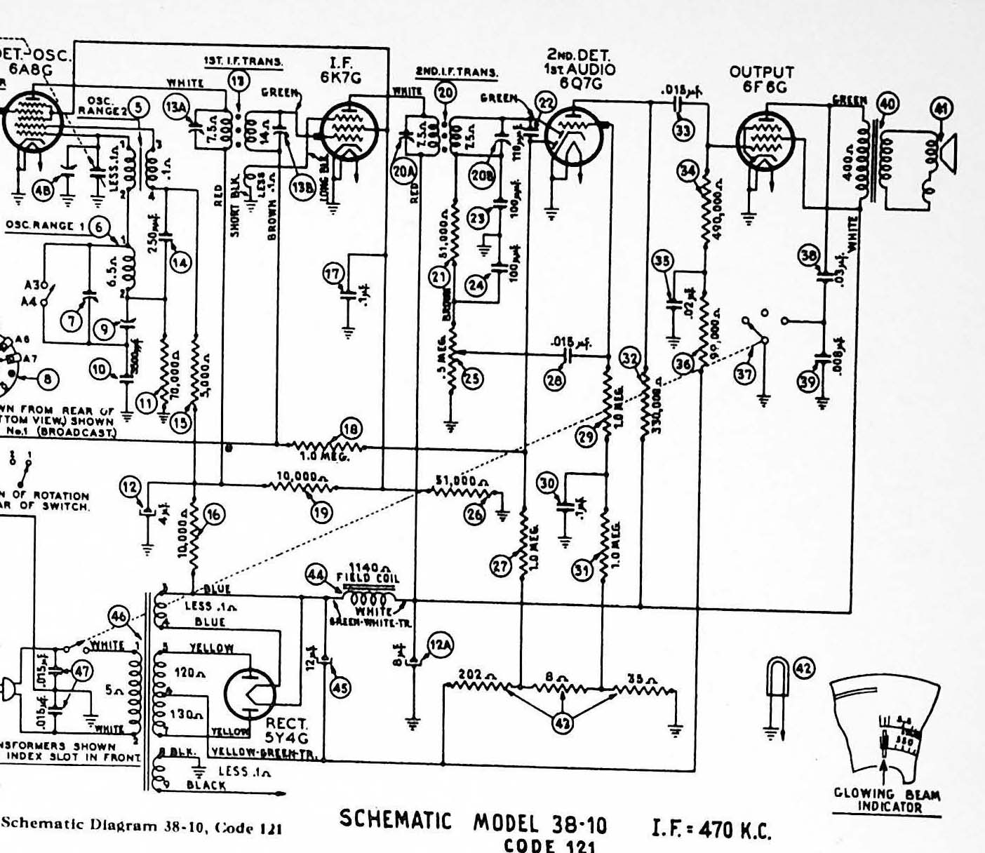

I have a question about the wiring colors for the Philco speaker wires is there a chart or does anyone know what factory colors are used.
Here is the schematic
#36
Rich,
The schematic "seems" to suggest it is green, white and blue...
Pliny the younger
#37
Chas,
Thank you I seen Green and white but I did not see the blue I will also look what color is still atached to the speaker I always leave like 1/4 inch .
#38
The blue label is at the filament of the rectifier which is common to the field coil. Though the wire itself may be another color as it is routed to the speaker. At this point it would seem blue would be consistent with an identical circuit connection to the "hi" B+...
Chas
Pliny the younger
#39
Chas,
Yes, I agree that would be the most logical!

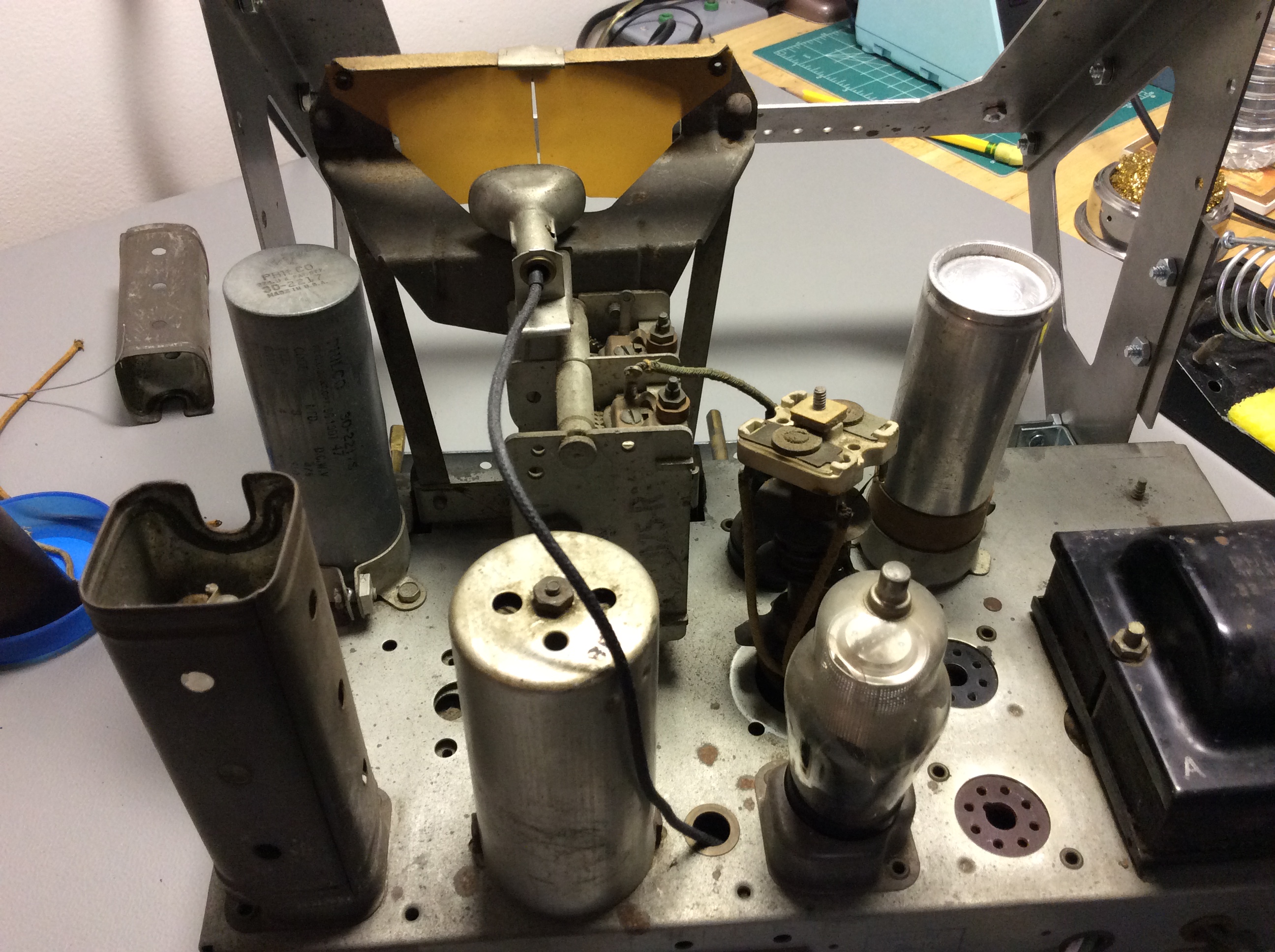

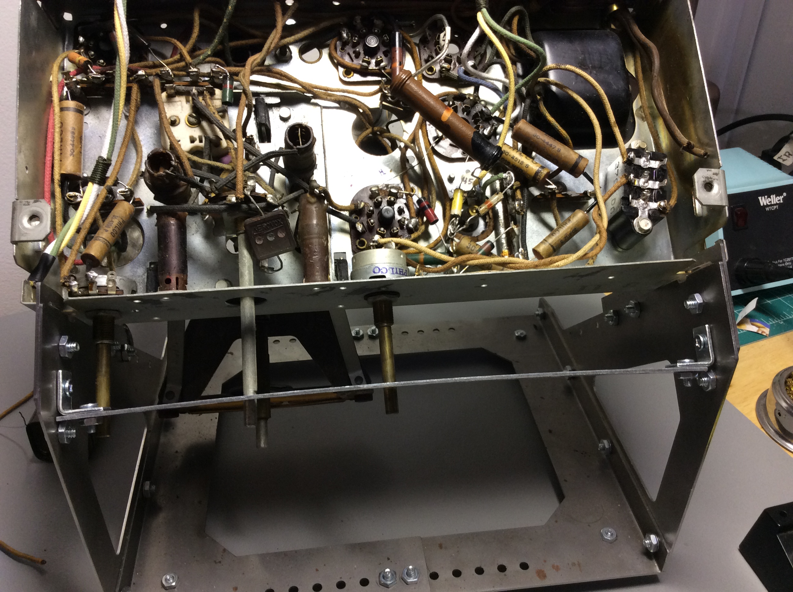

I worked on my Philco 38-10t again this weekend  Installing the newly made speaker wire harness  and  replaced the Pilot light bulb  along with new  wire and rebuilt the socket .
my next step was to take the IF can apart to replace grid cap wire .
Here are few photos showing my progress .
P.S. here is a Photo of the Chassis stand I added a brace to make it a little stronger !

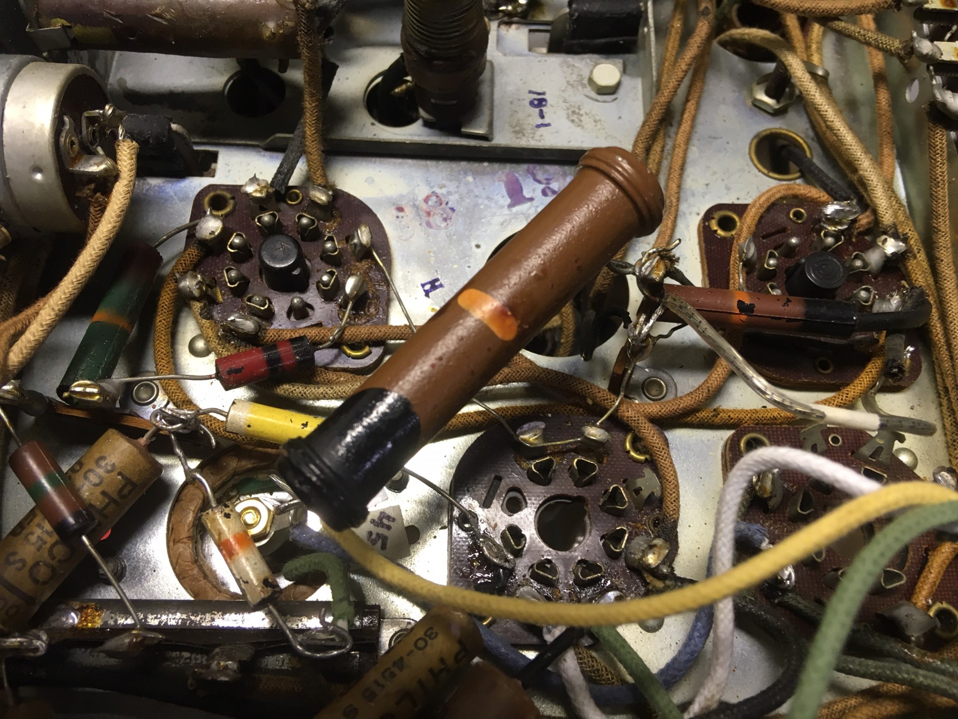

Here is one those dog Bone resistors that I want to make it is a 3watt at 10K .
I know someone on the forum made some of these before I was looking for the post on it to see what they used .

Richard, I am also just finishing up the restoration of a 38-10T and have a question for you.  What voltage are you seeing at the plate of the 6Q7?  The philco spec is for 120 volts. I’m getting about 214V. There is a 330K resistor in line from the b+, which can’t drop it enough.  I’m interested in your experience.  Incidentally, all of the other voltages are close to within spec on my set. I’m wondering if it is a typo.
The work you’ve done looks great, and I was happy to see this at the same time I have been working on mine.
Greg
#44
Hi Greg,
Typically when you see a voltage close to B+ on the plate of a tube there is little or no current flowing in the tube. When no current flows through the tube no voltage drop occurs across the plate load resistor. Voltage drop across the load resistor should be in the 100 - 150 volt range for your tube. If this is the case then either the tube is bad or the grid is biased so high it cuts off current flow.
#45
Thanks for the reply, RodB. I was most hoping that Richard may have measured his to see if it is a typo on the schematic.  My set is working very well subject to further alignment so if the bias is very far off, I don’t think that would be the case.
Philco 91 code 221
