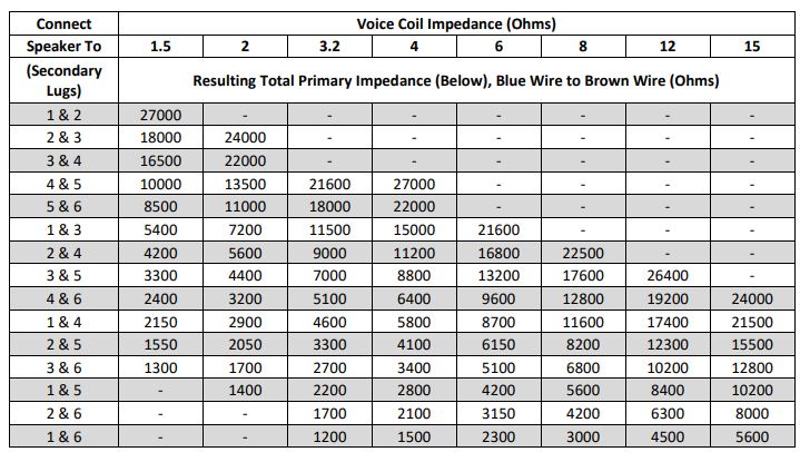

I have received my new output transformer (Hammond 125C). I thought I understood the wiring but now I'm not sure. Since my primary impedance is supposed to be 680 ohms I don't see anything in the table below how I would connect the secondary wires. For testing purposes I will be using a PM speaker measuring about 5.3 ohms and a resistor for replacement of the field coil. How do I hook up this transformer? I have included the specs for the K-6 speaker. Here is the link to the transformer. https://www.hammfg.com/electronics/trans.../125a-125e

Don't confuse the tubes' expected load impedance and DC resistance of your primary.
I do not have the sch in front of me, so I will be pulling the numbers out of you know what, but here it goes:
Say, your expected pushpull load impedance is 10 kOhm (see tubes' datasheet).
Your voice coil, let's say, about 1.1 Ohm.
This means, you need 95 turns ratio (9,000 impedances ratio) to convert 1.1 to 10,000.
Your transformer will show the coil resistance on top and your load impedance in teh coil under it. Your ratio is 9,000.
9,000 times 1.1 is 10000. But you have 1.5, so look for the value app 1.5 x 9000 which would be 13,500. The closest is 16500. This will be achieved connecting your voice coil to Wires 3&4.
Now, if you know exact voice coil impedance, use that instead of 1.1 ohm.
#38
I see where the 10k ohms comes from in the tube data sheet. Where does the 95 turns ratio come from?
If I use 5.3 times 9000 I get 47, 700. There is nothing anywhere near that. Can you give me some examples if my voice coil measures 5.3 ohms?
What happens when the mismatch is not close?
#39
95 is roughly the square root 9000.
OK, so you have 5.3 Ohm.
Look at 4 Ohms as the closest.
Let's solve this:
the closest in 4 Ohms column is 8,800, when connected to 3 and 5.
Now, 5.3:4 is 1.325.
So your 8,800 become 8,800 x 1.325 = 11,660.
This is pretty close to 10K you need.
However, you could also use 4 and 6. This will give you 6,400 x 1.325 = 8,480.
Also, you need to add to these numbers this to your 680 Ohms of primary DC resistance, more or less (I am not getting into reactances and complex impedances)m which will give you 9,160 Ohms, which is also pretty close.
So, use either 4&6, or 3&5, either one is good enough, 4&6 being closer.

It sounds like you measured your voice coil at 5.3 ohms. That would be a DC resistance. Impedances are calculated because they involve resistance at a certain frequency, usually 1000 hz for audio circuits. Your voice coil would probably be 6 ohms impedance. You use the output tube load impedance and speaker impedance to get the turns ratio for the transformer then use the chart to decide what secondary taps to connect to the speaker.

Yep, and 6 ohm still make it 4&6 Icon_lol

I don't really understand all of what was just said. I wish I understood how to determine the turns ratio. I used 4&6, subbed in new e caps and fired it up for the first time. It plays. There is a fair amount of work to do on this chassis which include replace all caps and out of tolerance resistors plus a lot of cleaning. The big canned ohm resistor is open in the 2700 section. I subbed in a 5 watt. Do you think that is enough or do I need a 10 watt. Schematic does not say.
