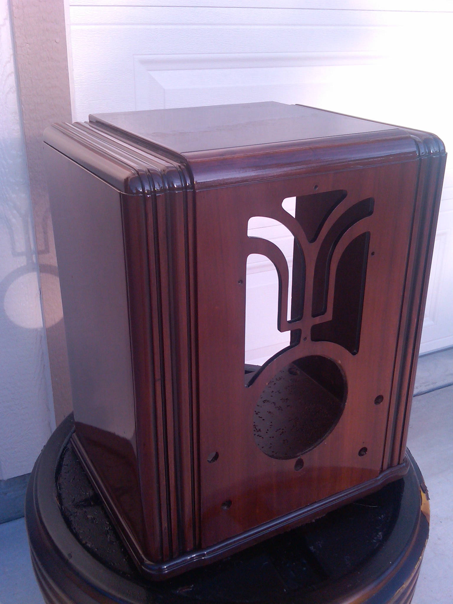

Ron I would not do that. The dye is going to transfer to the wood. I have even had this trouble using tints made for the job. I am picky, but it gives a cloudy appearance to the grain.
Here is one that I mixed the tint for. It is walnut, but it gave it more of that English walnut red tint - which, I guess is OK. This was before the polish.
I've already been warned about that (dye transferring to the wood), and have a contingency plan in mind...
So when you say you "mixed the tint," do you mean the grain filler you used on that cabinet, or the tinted lacquer itself? In any event, your cabinet came out nice and smooth, as they should.
