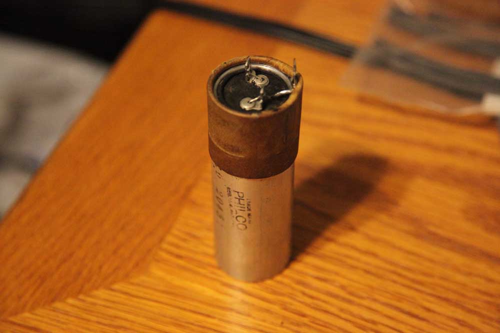

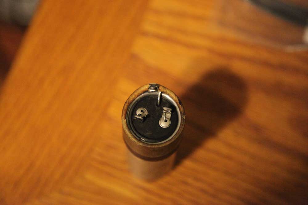

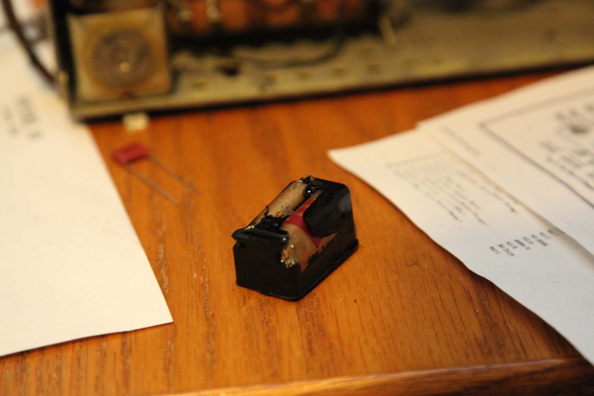

This is the final product. It also uses paper insulator (the cap's minuses are not really GND so they are insulated) so whatever imperfections are there, they are concealed anyway.

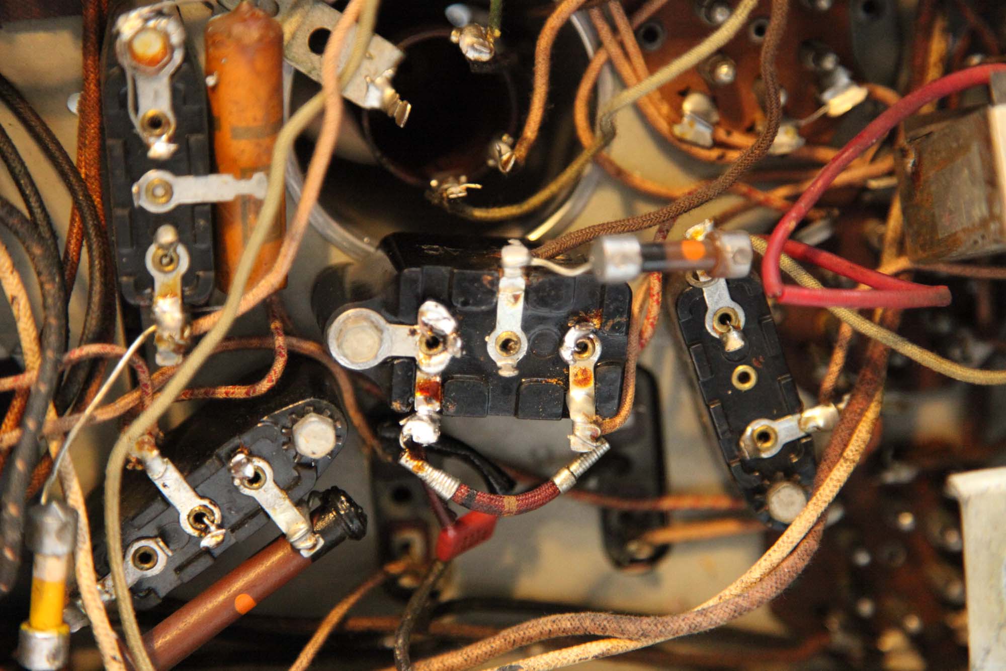

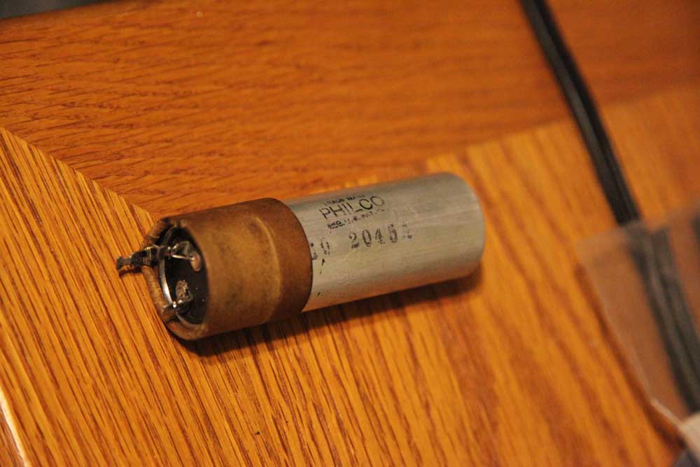

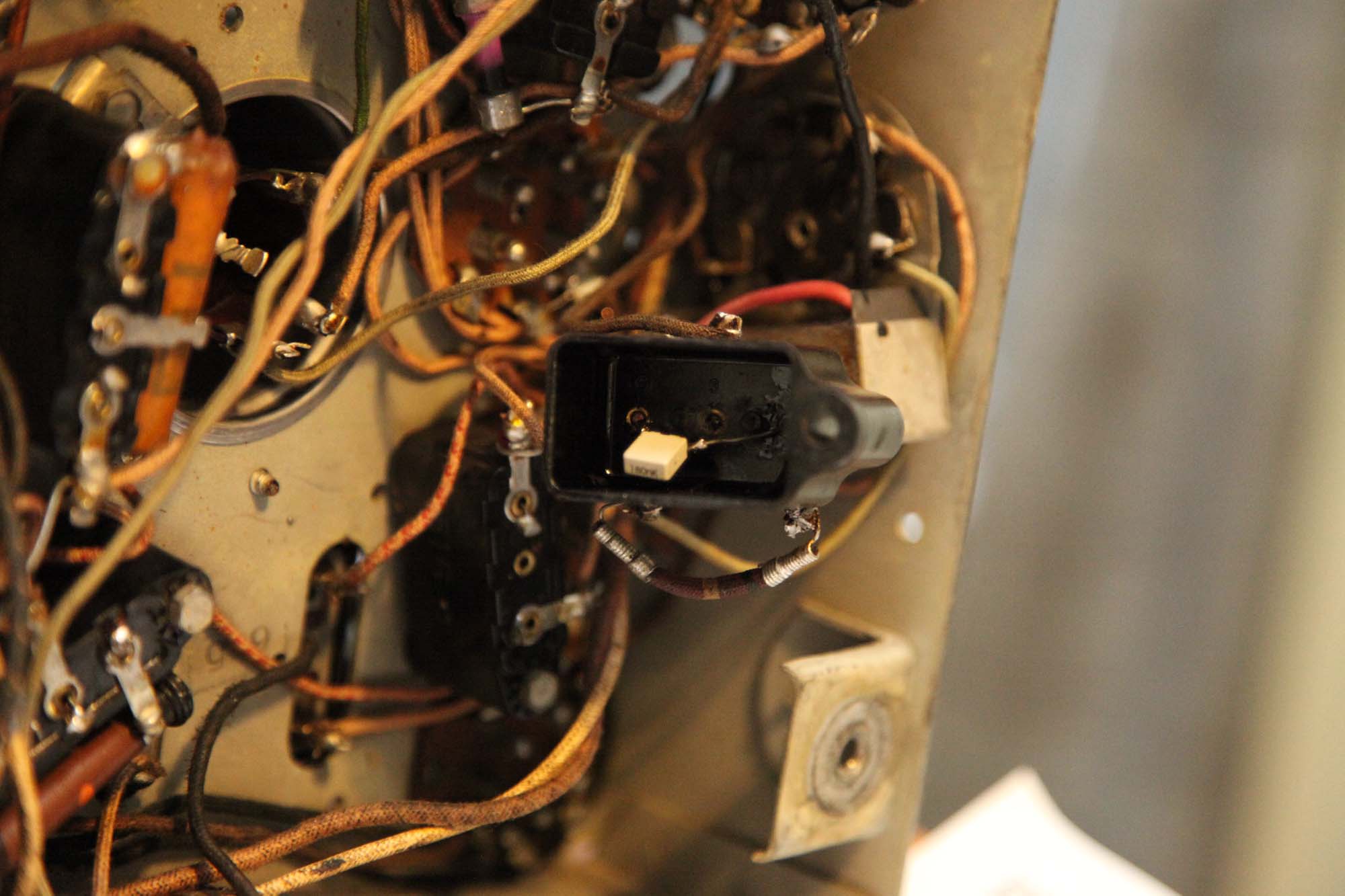

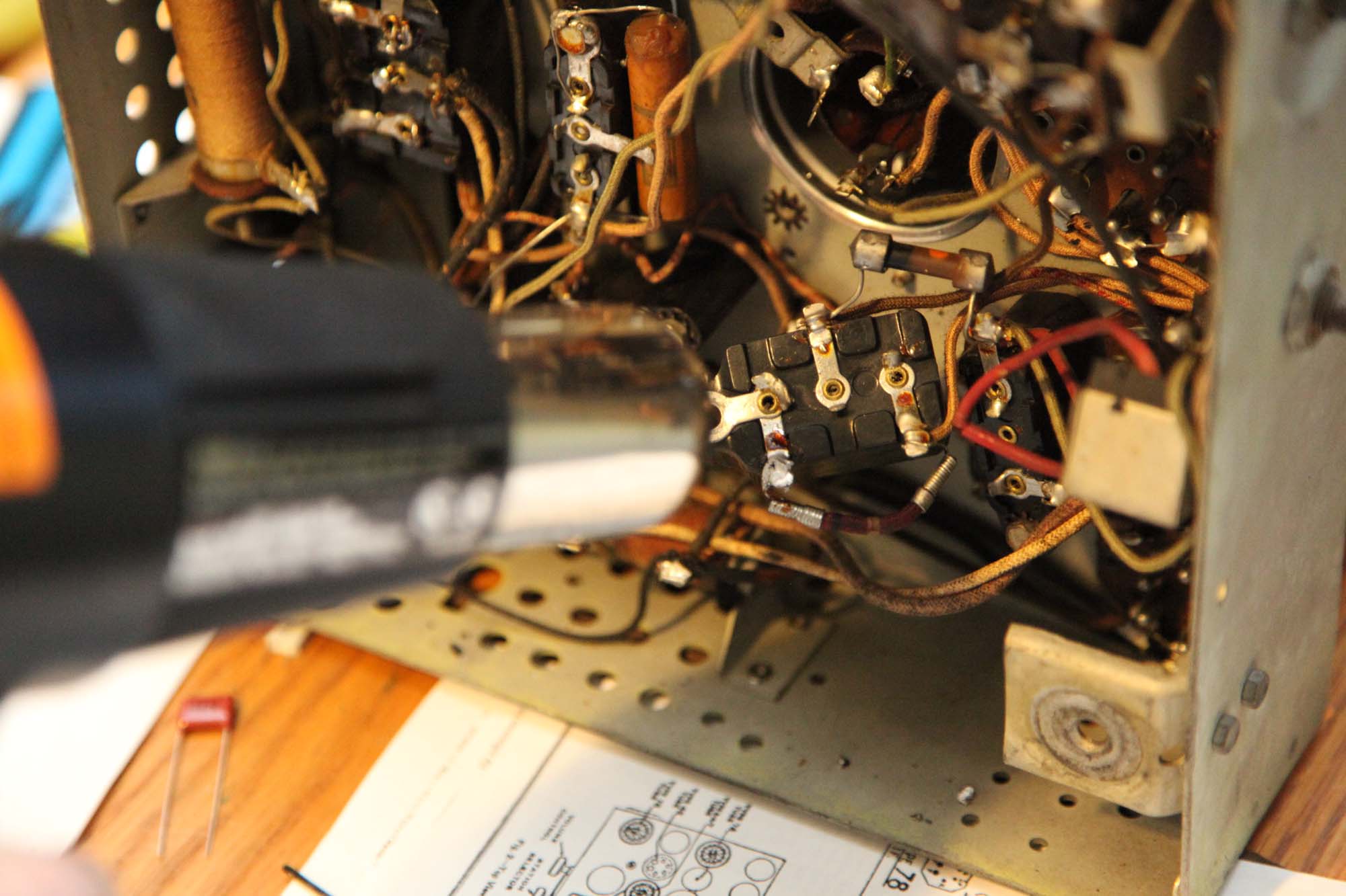

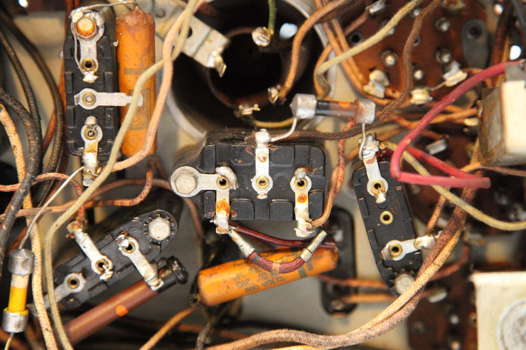

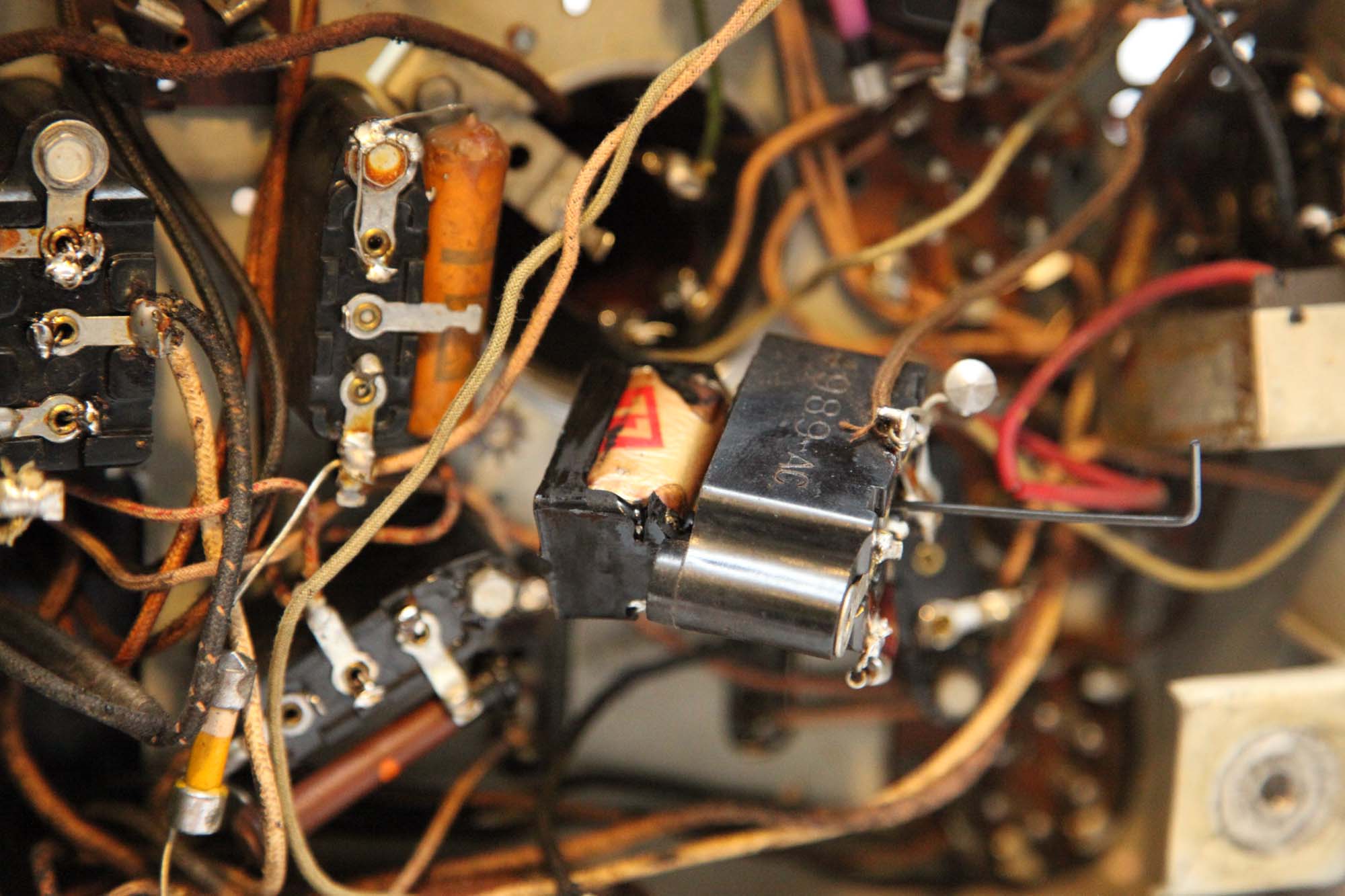

This is how I restore the backelites without taking them out and without desoldering.
A cap.
Unscrew.
Also, as you can see, unlike in the previous photo the wires going through the grommets are cut, so when pushing the stuffing out, nothing holds it.
Heat with the Milwaukee gun.
Push out the stuffing with a small Allen wrench (needs to be dull.)
The stuffing is out.

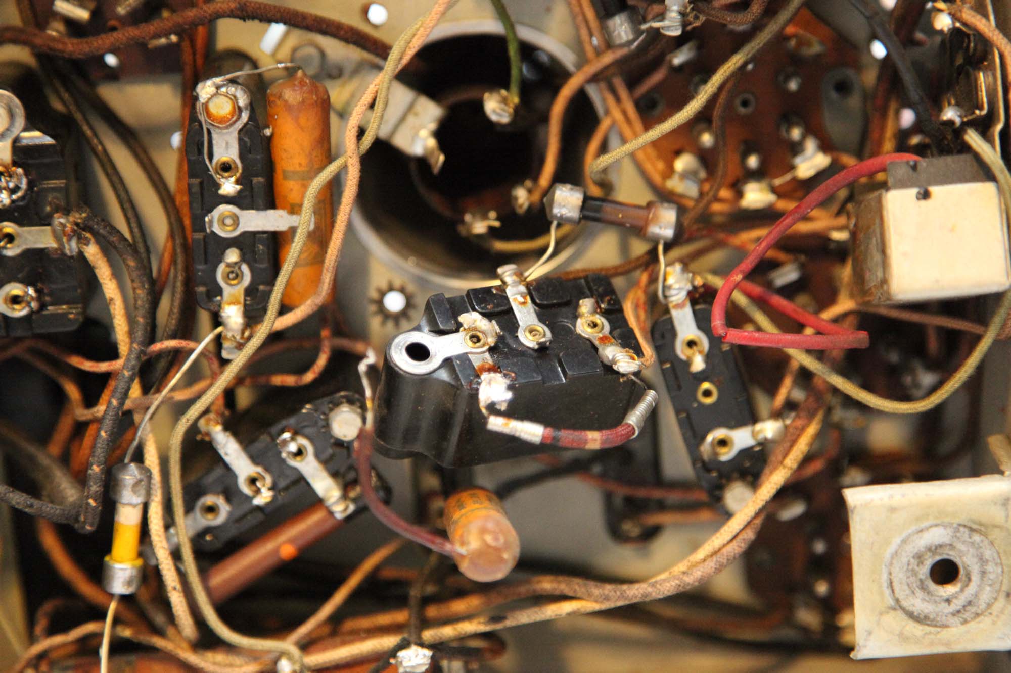

#36

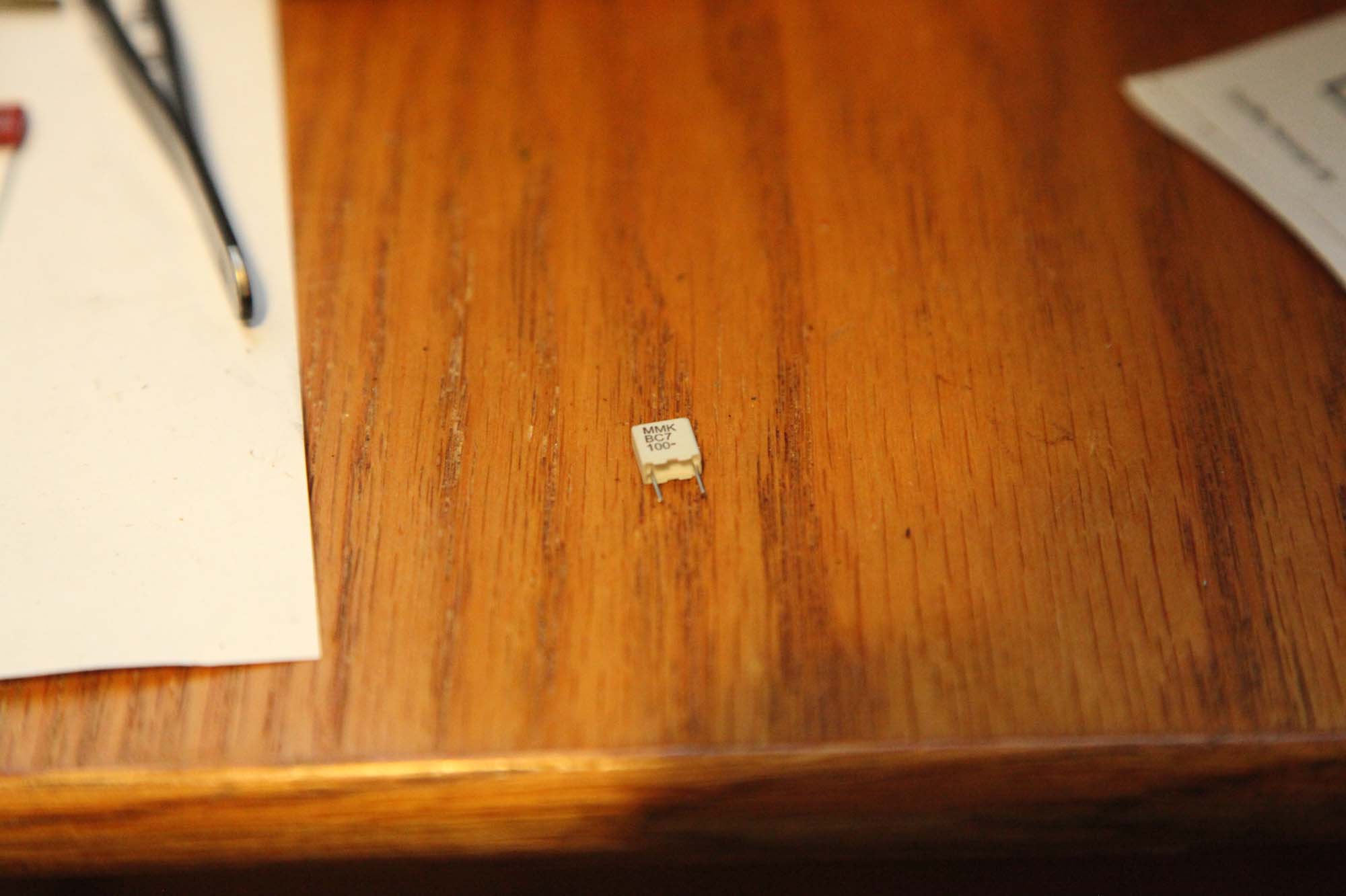

New cap.
Put it inside and solder.
Screw the whole thing back in place.
Done!
All takes about 10 minutes as the de-soldering is not necessary.
#37
Mortz, I agree, no reason to take wires off. I do think you might of missed one step. While the block is mounted I take a small drill that matched the hole in the grommets and with a hand drill, a couple of turns to break the wire coming through. Makes removal of the tar block much easier. I have also found that it is easier to do if you have a little room to heat the block with a heat gun at the top while the block is still mounted and then push down though the holes with something like you suggested. I use a large paper clip opened up but anything that will fit through the grommet hole will work. Then I remove the block and pull out the tar and caps. Really helps to release the cap wired before heating.

Yes I do cut the wires, and do it with regular cutters - the wires are so thin that it does not take much to severe them.
I did not show that since to me that was kinda obvious.....
#39
Certainly obvious to you and to me but perhaps not to a noobie. Icon_smile
Jerry
A friend in need is a pest!  Bill Slee ca 1970.
#40
I iwill edit the text Icon_smile
Is this better?
It is quite clear there that the wires are cut, and in the first photo they are still attached.
