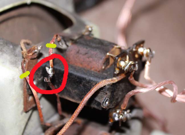

Ok, to reverse the hum bucking coil, I should swap these two wires? (marked in yellow)?
Posts: 16,533
Threads: 573
Posts: 761
Joined: Jul 2013
City: Kentucky
Ok, hum bucker is now reversed. Kind of a tough job for tired, old eyes. I somehow managed to poke a small hole in my speaker...arrrghh... As soon as the speaker repair glue dries, I'll put it back in the cabinet and give you a report.
