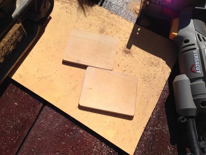

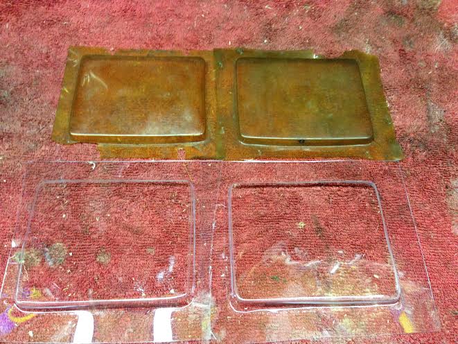

I am happy to see that people like the restorations. Pointing out issues is always welcome too. I made the molds today for the new dial covers and made one for the clock and one for the dial. There was about an 1/8 of an inch size difference so I had to make 2 instead of one.
Here are the new covers:

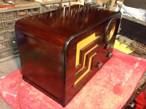

City: Kings Park NY

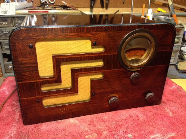

I had amazing weather today and after all my work and stuff I finished my Philco 38-62.
I waxed the heck out of it with Johnsons Paste wax and buffed her out. Put the chassis and speaker back in and cleaned the bakelite knobs with soap and water. Then gave them a shine with Brasso.
Here she is:
AC: 4 DC: 1
(This post was last modified: 04-10-2014, 05:52 PM by OldRestorer.)

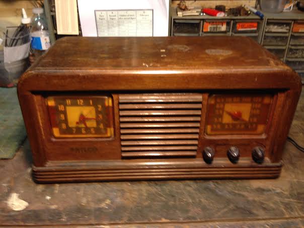

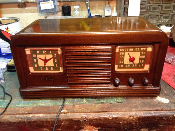

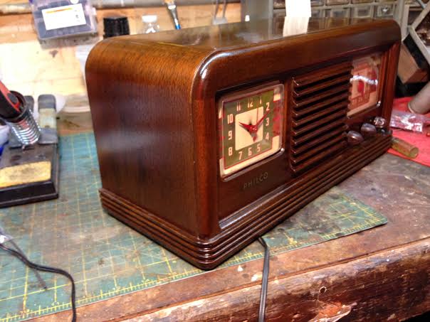

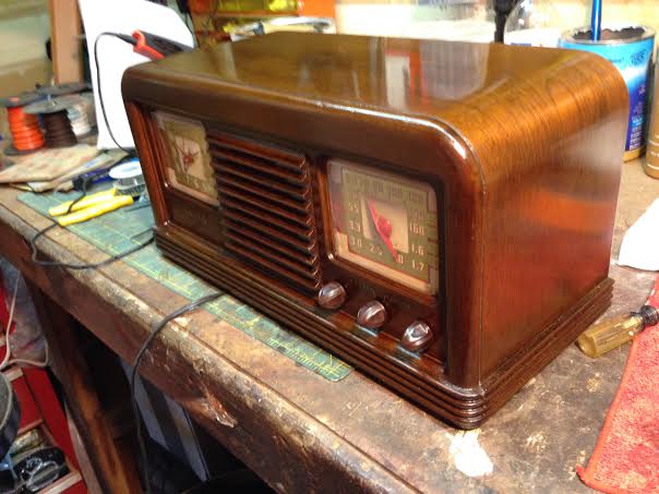

Well after 2 weeks of searching and talking and learning I have just about perfected my method for restoring cabinets.
I took out my 41-22CL and got working this morning. decals, about 4 coats of clear and then 400,800,1000,1500,2000 sanding. Last was the 5 coats of Johnsons wax.
Here she is all finished:
AC: 4 DC: 1

Kirk, so your new method is 400,800,1000,1500,2000 sanding followed by paste wax? Are you doing this sanding between coats or only after the final? And how many coats are you applying?
I think you should consider doing a cabinet with step-by-step instructions and pictures.
Yes. And all ingredients listed.
