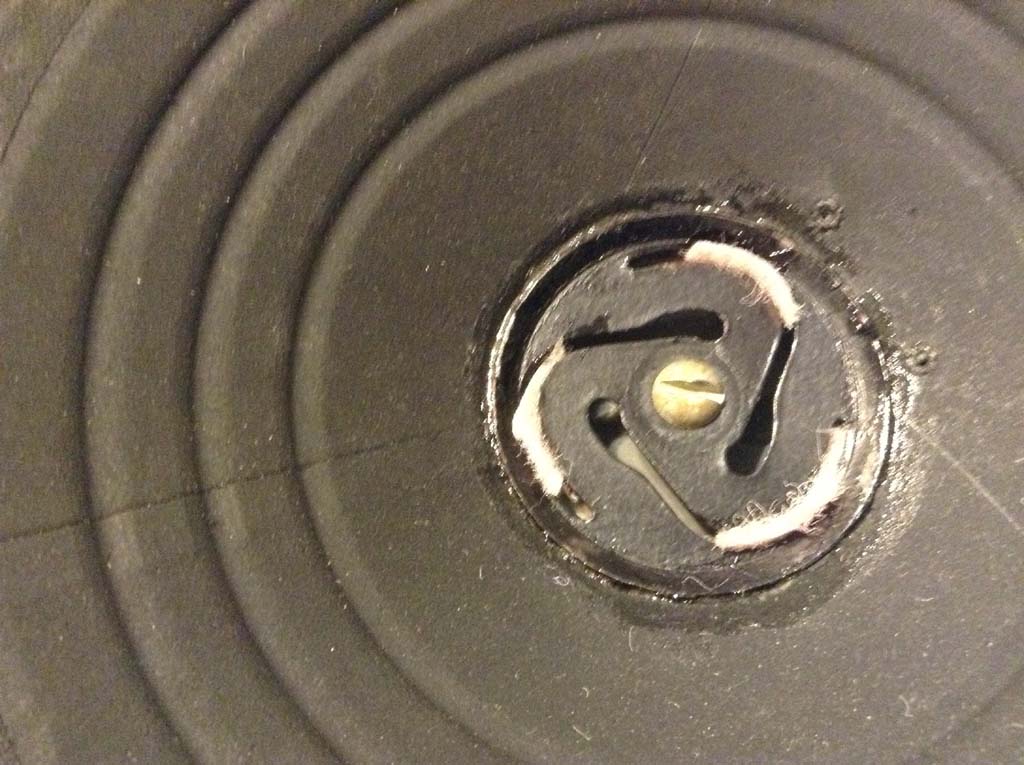

Looks to me like a good one for the impact driver.
Looks to me like the screw goes into the center pole.
Ron can probably verify that it is a continuous chunk of iron to the back and if it is a 1/4" screw.
Set it like the picture on a good hard surface.
Pick a bit that fits snugly in the slot of the screw or grind / file one to fit. They are 3/8" hex drive bits.
Setup the tool for unscrewing. Hold the end and hand torque it and it will toggle depending on which way you twist. You can test you got it correct by butting the bit on a metal surface and pushing down watch for the bit to turn CCW.
Fit the blade into the screw head. Use one hand to push straight down and twist till snug CCW (unscrew). Use a light hammer in the other hand and tap lightly. The tapping jars the threads, pushes the blade solidly into the slot and adds a bit more unscrew torque. You can get a lot of torque if you smack too hard so take it easy. If you must use penetrating oil just a drop or two it wicks and I would not want it around my cone / VC. Trade off would be: Do you want oil or to drill out and retap. The driver can develop way more torque than necessary to twist off the screw.
Might what to set up a practice screw locked into something with a jam nut to get the feel for how it works before you go for the gold.

The pole piece is indeed solid.
But the problem here is that the screw goes through the spider, and the spider is solid - one wrong move and bam, major damage to spider.
Even if the spider were open, what I call the "45 rpm adapter" type because its appearance is very similar to a 45 rpm adapter which is inserted into the large hole of a 45 rpm record, one wrong move with the screwdriver and hammer and bam, broken spider.

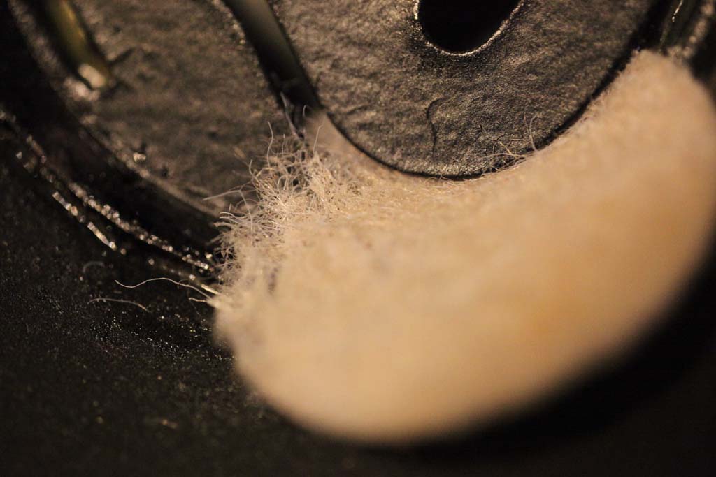

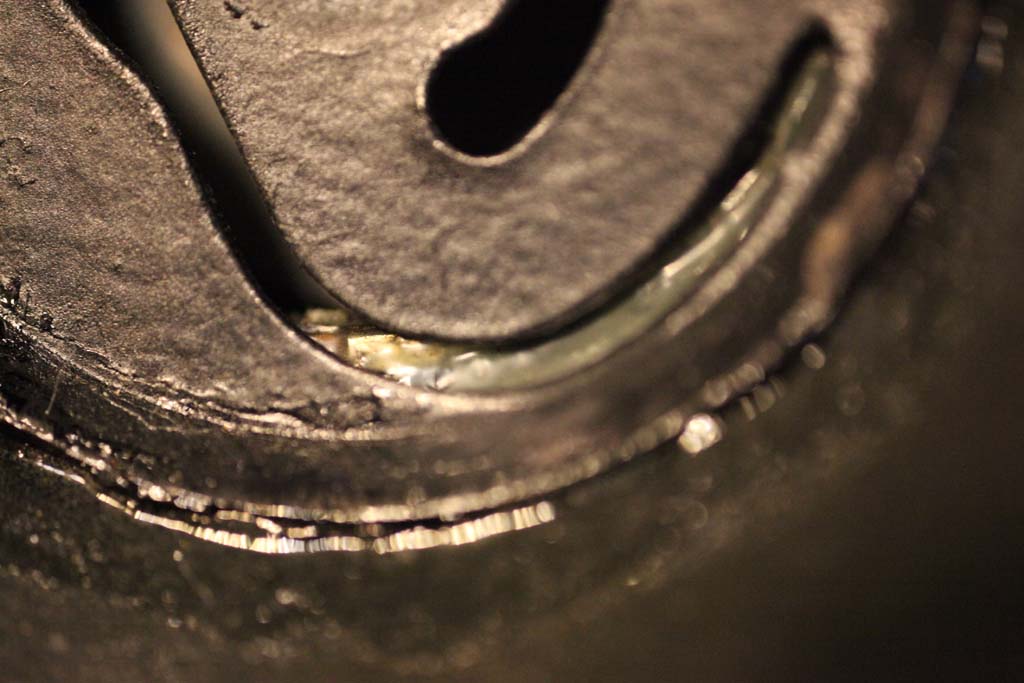

Then during commercial when a man with deep low voice spoke, I heard buzz, "bzzzzzzzz" type. I plugged in the other speaker, and it was OK.
Then I started touching the membrane and the spider, and when I pressed upon the spider the buzz stopped.
Then I saw something surrounding the spider under it, which it touched.
I thought first it was the metal, but then realized there is no metal there.
Eventually I think it is the lower part of the cone's funnel, as the spider is kind of wide and could not be glued to that part. The spider, I think, resonated on low and was buzing against that part of the cone.
I had the thin leftovers of felt padding for furniture legs.
I cut thin segments and glued them under the spider using fabric glue.
Seems like the buzzing has stopped.
The ultimate test will be when they resume musical programming, as so far it has been mostly sports. But so far during commercials deep voices and low-pitched music sound fine. No buzz.
Posts: 16,533
Threads: 573
This is it.
The way spider (one blade of the propeller) looked.
Felt shim.
Felt shims trimmed and glued.
