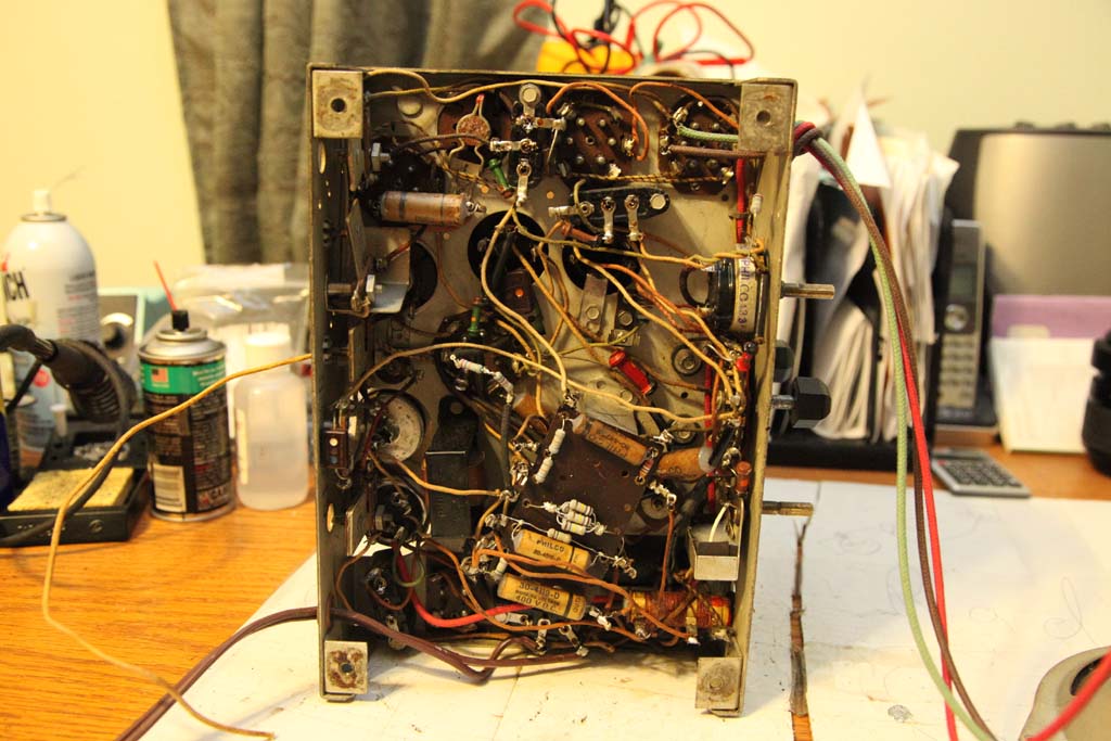

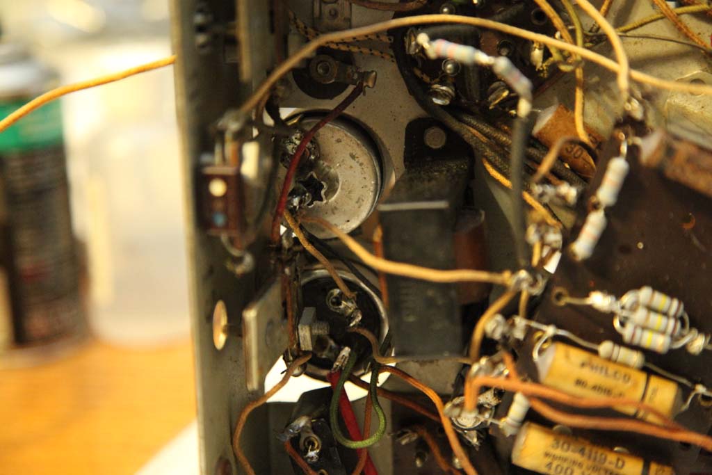

This is a weird animal....the retaining ring is absent.
And there seems to be nothing holding the rotor of the switch otherwise.
So when I tap on the shaft, I fully expect the rotating panel (the contacts are horizontal so they are not held by other contacts when the axial move occurs, or ao I think) and the shaft to come out. Only it does not.
I probably need to pull all tubes and give it a nice wack. But so far it's been fruitless.
After some work and whacking with a hammer the shaft started moving and now I have it 2/3 way in. But this is where it is really got stuck. I do not see anything bad, the part that came out from the back is smooth, clean, no rust at all.
Applied some Lithium grease to the insideart of the shaft.
After some working all of a sudden it started rotating freely and then I could pull it back with pliers, while keeping applying the grease. Now it is back in its position switching freely.
Now, there is that question of the missing retaining ring - need to get it fom somewhere.
OK, the donor was the bad pot from the Westinghouse, good thing I keep those.
The switch works, the effort is minimal, as it should be. Two fingers without any exertion.
I wonder what it was that held it...no residue, palpable or visible, was present.
Good thing is, this switch construction allows for extracting the shaft and the moving contacts without removing the whole switch, just bend parts and move wires a bit to clear the way for it to slide out.
Gave it a bit of Deoxit for good measure, though contacts looked very clean with minimal oxidation.
Alignment tomorrow.
PS. There was some extra good in it - during the whacking process a huge splash of solder came off of somewhere. likely from a chassis' wall.

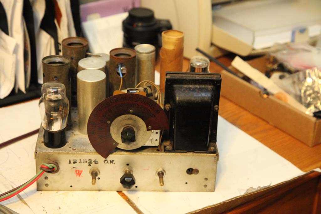

This is so darn sensitive....12" wire, and I pull in stations I did not know exist. At high freq part of dial especially.
And this all before alignment.
Aligned it...not much of an alignment, IF, trap, upper end and low end osillator.
A note to those aligning these - do not epect yours tations to be right where they should be even if your low and high ends are. Mine local station which is 1160 is at about 1140 or so, and this is not the first time I see it.
Very sensitive, pulls lots of stations on 1' wire.

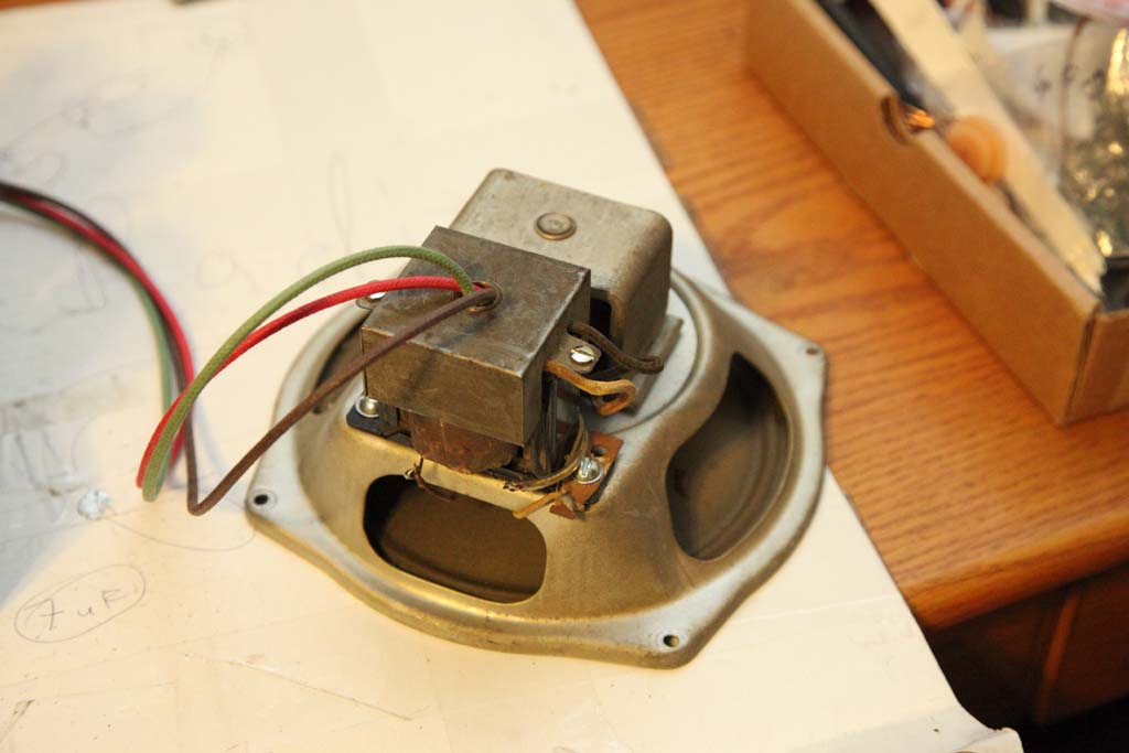

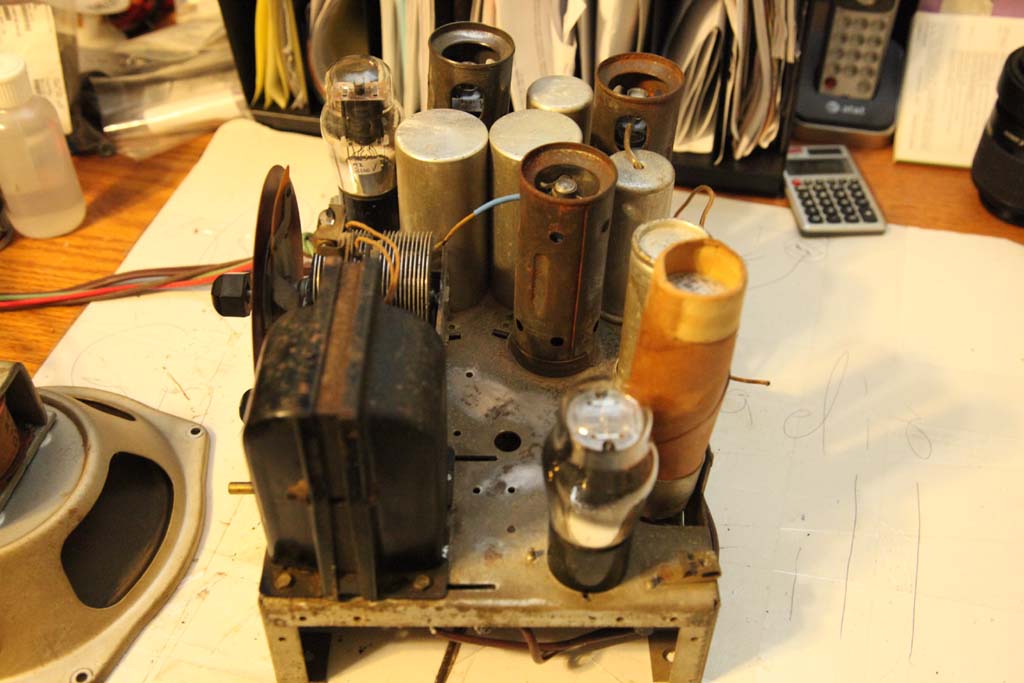

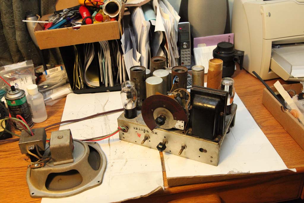

The transformer has been replaced.
Not exact model but also for the 42 tube, SE, also Philco and close impedance matching. Also looks close (cover on top) and has exact same mounting panel on it (under the cover), so the connection does not change.
The speaker allows for mounting holes variations so though this one is wider, it fit.
Had to make new wiring.

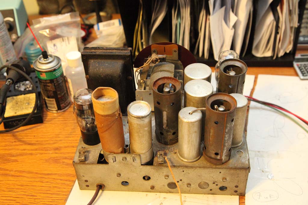

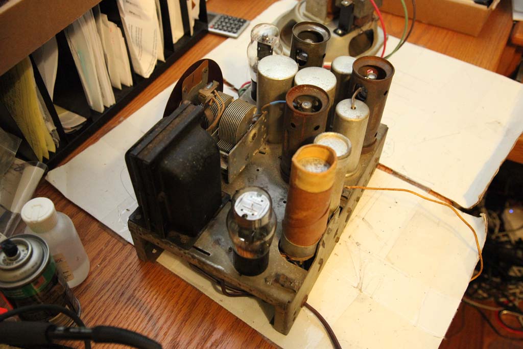

The caps have been rebuilt.
The choke is a Philco but smaller size, however the current rating is same or better. To make it look the same and fit to the mount, I simply put it in the bracket from the original choke, used some wood and epoxy to mount, (discovered that works well when I did the interstage audio driver in 111) and it went right in.
Posts: 736
Threads: 26
Joined: Jun 2013
City: Hayward, California
Nice job rebuilding those caps, hard to tell. What do you fill up the holes in each side with?
