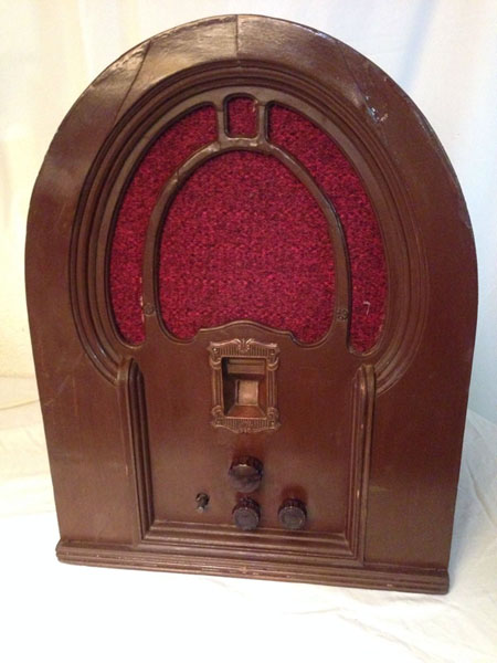

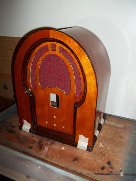

LOL!!! Morzh
First and last....fool me once!
I attached a couple pics to show how the cabinet was. The reason I want to get it to work. I think it's worth more life. Ignore the tape on the bottom, used to hold parts in place while dabs of glue set up.

By the way...the pics I posted above are of course before and after. The radio was painted brown, an attempt to hide all the flaws. When I received the set via usps the grill was wasted " and I don't mean drunk" after I finally get this thing running, I'll get wasted...lol.
Instead of rebuilding the grill I made a half template, traced it and cut a new piece. Re-veneered all of it. The veneer was gone also. I'm almost done with the case....now to get the chassis to work.
