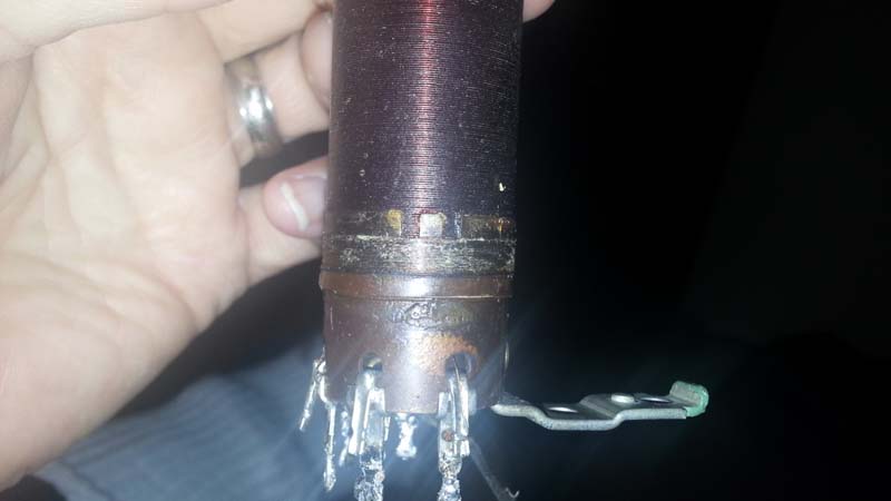

Ok I am getting a little worried. I unraveled the tickler winding.  I counted 26 turns which is in line with what I have been reading.
Underneath, the celluoid insulator (with the little tabs) remains.  It is stuck on there good!  I don't see any possibility of removing it without destroying the winding underneath.
Can I just leave it?
Can I wrap it with a piece of tape, then wrap the new winding on top where the old one was?
Mark

(03-17-2015, 11:11 PM)markmokris Wrote:  Ok I am getting a little worried. I unraveled the tickler winding.  I counted 26 turns which is in line with what I have been reading.
Mark
As Rosanne Rosannadanna would say "Never mind."
I used a little heat and eventually the celluloid strip cracked and broke off mainly in one piece.  The primary and secondary seem to remain electrically sound.  So I think I am in business.
Thanks,
Mark
