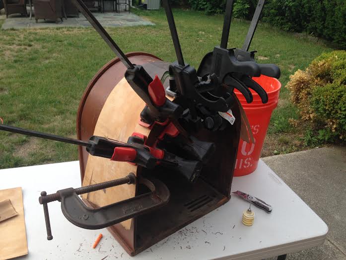

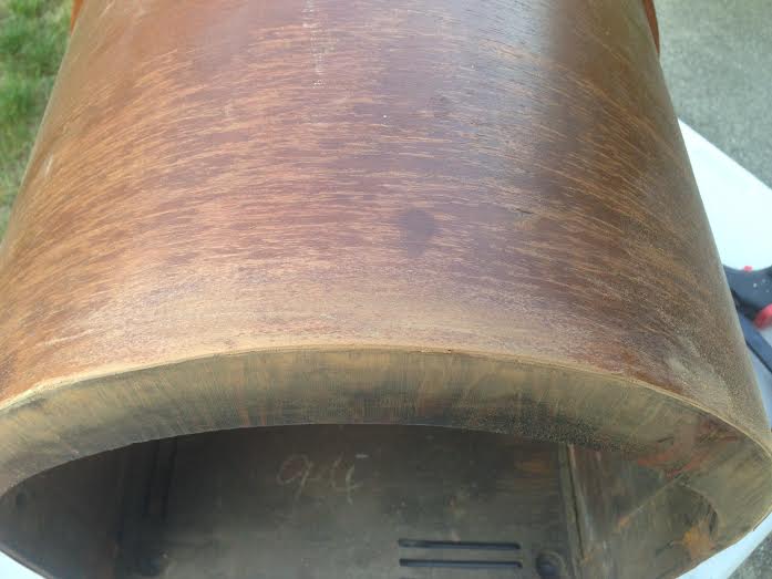

I am having issues with Mikes 16B as the veneer is hanging over the back arch. I am trying to glue the front back to the arch and if I clamp it, The veneer on the back of the arch crushes. I decided to do some other repairs while I think about it. I have glued down all the veneer that was lifting and patched the top missing strip on the arch. I had to reattach the arch brace so I did it all in one step.
Update *
  I decided to cut off all the overhang on the back. It will just get ruined in the future if it gets bumped so removing it is the logical answer. I planed it and it came out nice. Now at least it is even and the arch support and the veneer is lined up correctly. I dont understand how that happened though. It was never touched, The arch support was never moved so It was a factory thing??
Anyway,

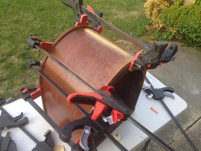

  I have veneered, glued, clamped and moved on to another cabinet till tomorrow when it is dry. Then hopefully re-attaching the face will not be so hard. It will need a lot of pressure so I am hoping no buckling will occur.
Kirk

Unclamped and the veneer came out pretty darn good.
Now it is gluing the face to the arch and waiting till tomorrow...
