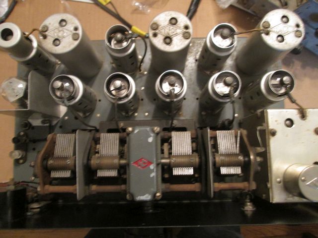

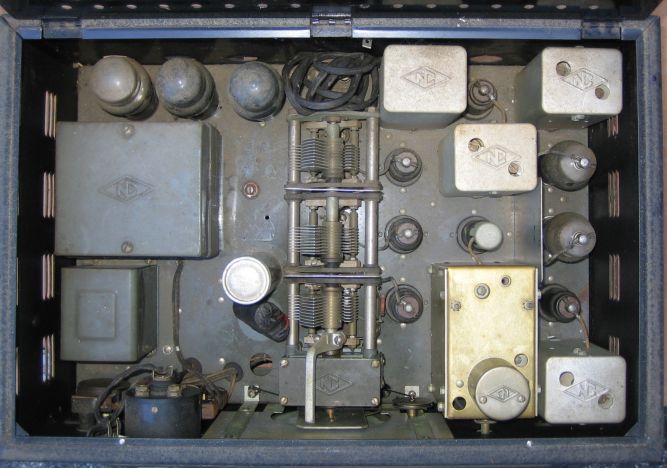

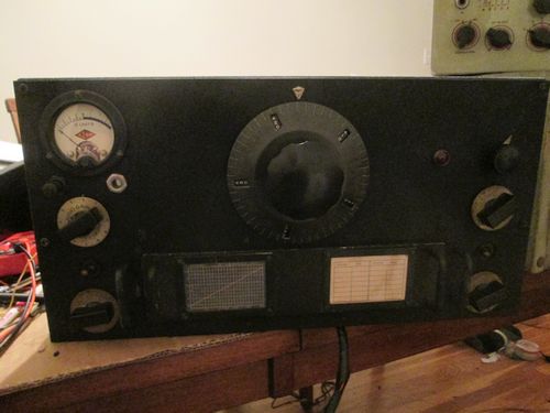

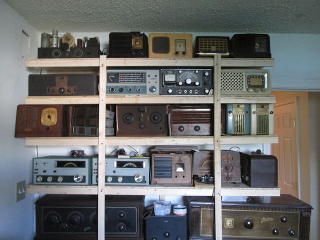

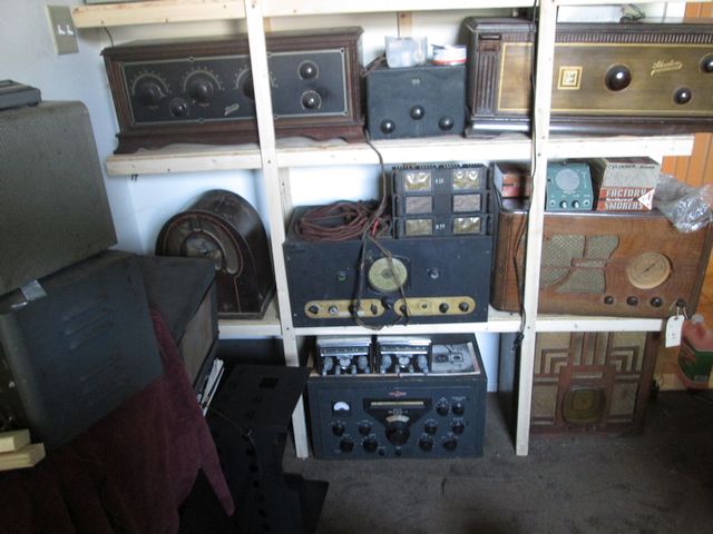

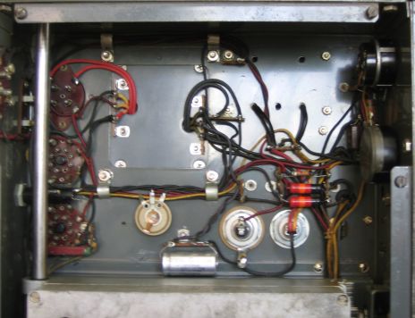

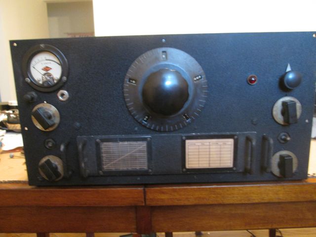

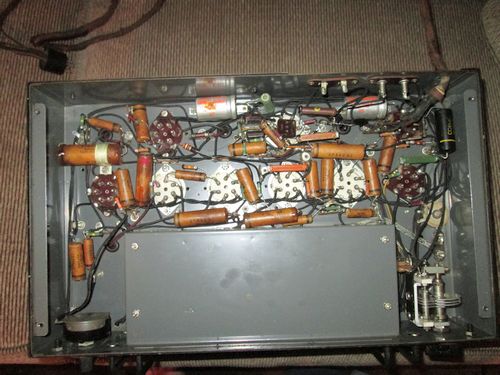

And now time for some pics! Seems like the pics never come out in the same order I put in. Anyway 1st two are of the HRO w/the fnt panel installed and the chassis cleaned up. The others are mostly for Mike and Sam's edification these are the shelf's I put up a few posts back to get some of the junk off the floor. When they where over they saw all the stuff on the floor. Notice I didn't take a pic of the floor. No comment.

wow terry looking goo now mike can walk around Icon_thumbup
and you have room now for some consoles Icon_twisted

We can send Fred Taylor over to really get you organized, he has got it going on. Really though I should talk. But sometimes just rearranging things makes you feel like you got something done.

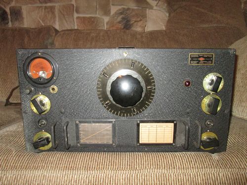

Haven't shown yous guys any pic of 7C. It's kinda dirty and has some white paint overspray (I didn't) on the left side of the front panel. All in all it's in really good original shape. It's three years and one month newer that L76. Last pic is of L76 still working on the RF gain issues.

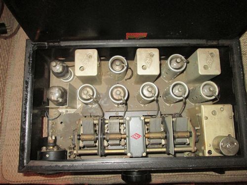

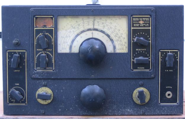

I picked this NC100XA up last year at a hamfest and am almost done with restoration. Here are a couple of before pictures.
National made some really nice equipment in the 1930's.

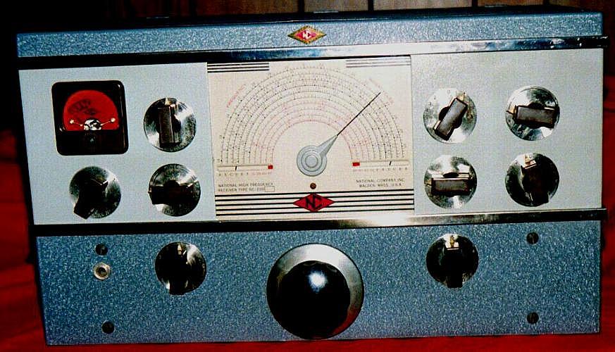

Hi Mike,
Would like to see some after pics...
I have it's father and son over here.
Have serviced both many years ago.
THe '200 I used to use on the air w/a VikingI.
Those where the days!!!! Back when I was 40 something.
Take good care.
Terry N3GTE
#58
Wow, that NC-200 looks in great shape. You have a nice National collection.

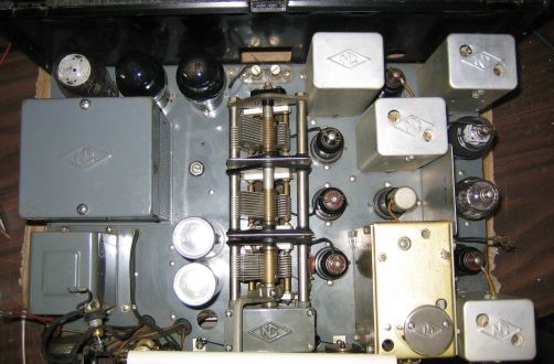

I don't have any final photos of the NC-100XA yet, but here are a few during restoration.

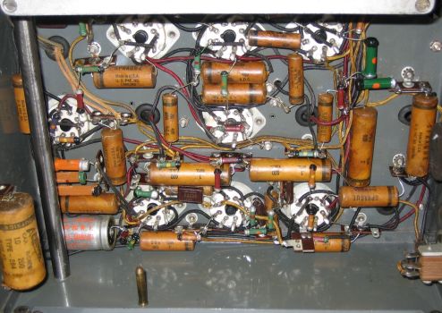

The chassis cleaned up nicely. I was able to find a matching electrolytic can to restuff to preserve the original appearance. The nice thing about this particular radio is that it was pretty much untouched, only a few electrolytics were patched in in the late 1960's. All the original paper caps were present and have been restuffed. A few of the resistors were open and replaced, the remaining ones were close to tolerance and left as is.
The catacomb movement was really stiff due to  shrinkage of the plastic bushings. I was able to split them lengthwise in place in the casting to relieve the tension and now it moves smoothly and freely
The big problem was the power transformer. These radios are known for their weak transformers and this was no exception. Secondary was shorted and it was was replaced with a Thordarson of similar specs. I made a mounting plate to match the existing chassis holes and fit the transformer within the original cover. You can see the new mounting plate in the original chassis cutout.
At this point after complete alignment, the radio plays great on all bands. I particularly like the dial and the wide freq coverage of each band.

A few new developments with the HRO . I finished up the loose ends, installed the power cord, replaced a few ecaps under the chassis, and removed extra parts I was using to troubleshoot. Buttoned up the bottom and installed the cabinet and going to called it done for now. It still has some minor issues like lettering on the knobs needs to be refilled just little stuff.
