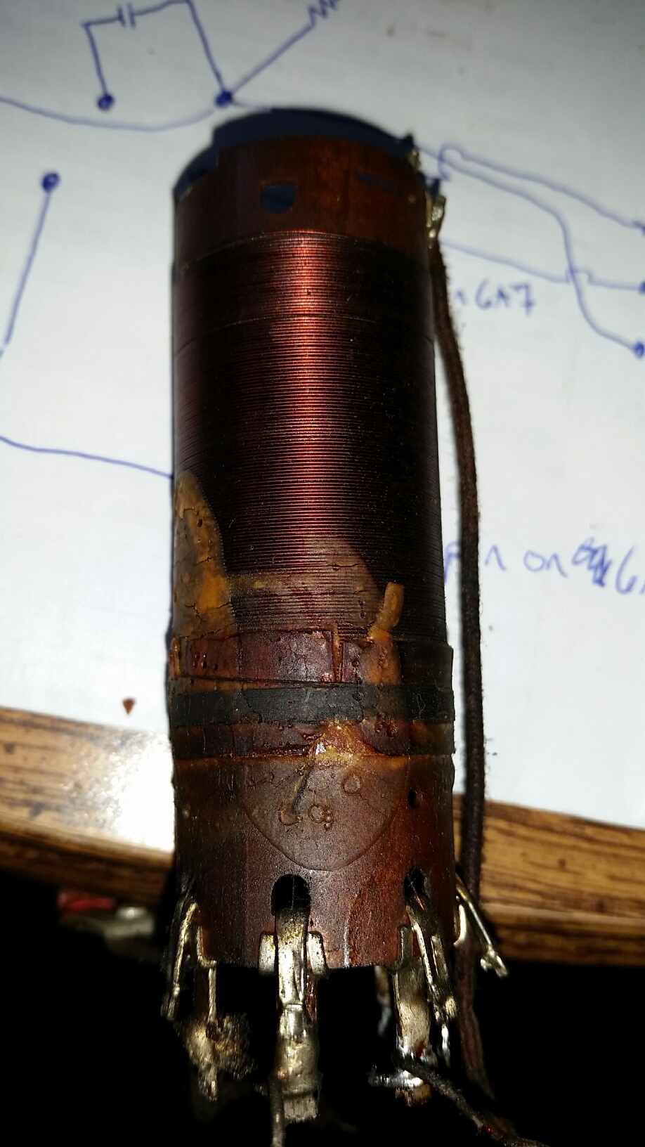

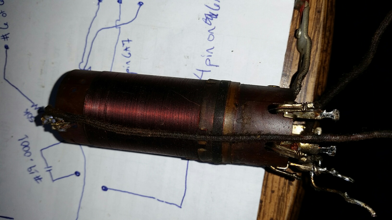

So this morning I finally pulled out the coil after many photos and a drawing to help me get it back together. I've included a couple photos of the coil so that hopefully the course of action to fix it can be done. I need to know the best source for materials.
#58
Now that you have it fulky out, just for s..ts and gighles measure between the two windings one last time, see if the 25K is still there. Not likely it will disappear but still.
As I suspected it is one coil over the other so this makes it possible to develop a short.
#59
That's the first thing I did when I pulled it lose from the chassis was to check the measurement between the windings and the resistance was still there. Not sure whether to try fixing it myself or seeing if someone with more experience can fix it for me.
#60
Well... there is not a whole lot of turns. You notice the winding direction, make notes, measure the wire gauge, and mark the limits that were original limits of both windings. Foyr key things : wire gauge, direction from beg to end, geomettical position along the bobbin and the number of turns.
