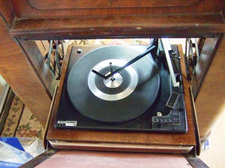

As it turned out, when I tried using the changer the way I had mounted it was too high in the cabinet and raising the record support arm when loading records was all but impossible. The solution is to remove the bottom part of the plastic base of the changer and use a piece of 1/4 inch plywood to attach it to the original Philco rose colored base frame. That will allow use of the changer in a much more comfortable and accessible manner. It will have to wait a few days as the weather is rather raw and cold here now. I have to do that work in the barn and there is no heat there.
In the meantime I did take a picture of the changer in place when the unit was too tall. Here is that picture:
You can see the lower indented part of the base in the picture. That part can be removed by taking out some 1/4" hex head screws and that is where the plywood piece will go. That lowers the entire unit about 1.5 to 2 inches which is enough to make the unit much more accessible.

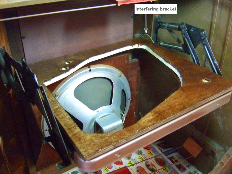

As things turned out, I can not use the upper portion of the BSR-310 base as it is wider than the bottom half and it rides up as the phonograph door is closed on the top edge of the front pivoting steel brackets. Either the brackets would have to be modified or the sides of the upper half base would have to be modified to prevent the brackets pushing up the front of the changer base when the door is closed.
I wound up using a piece of left-over 1/2" birch plywood from another project and made a new wooden base for the changer. I used the old plastic base as a template for determining where to drill 1/2" holes for the changer hold-down screws and the internal cut-out for the changer mechanical items underneath. I drilled the 1/2" holes with the old changer base taped to the plywood so things would not shift. Once those holes were done, I moved on to drilling some entry holes for my saber saw blace and made the interior cut. I finished the internal cut shaping and sanding using a cylindrical grinding bit in the chuck of my Dremel tool. Some final sanding to get rid of any remaining burrs and roughness resulted in a decent looking base.
I found that a can of MinWax Special Walnut stain looked closest to the OEM stain used on the inside of the phonograph compartment and used that to stain the new wooden changer base. It is now curing in the barn. After a day or so I will apply some polyurethane varnish to the base and mout it using some screws and fender washers. The front of the wooden change base will also receive shims made of flat washers to equal the height of the rear OEM changer mounting brackets and screw heads.

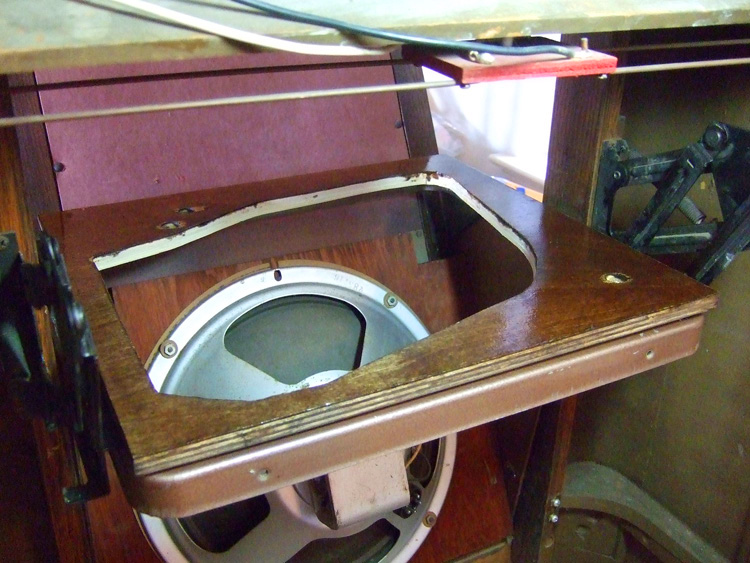

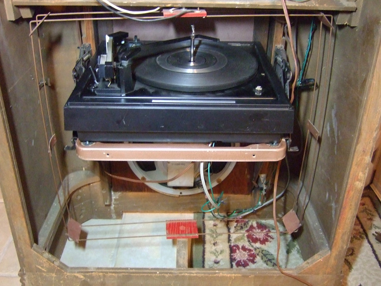

I did get the wooden changer base made, stained and varnished. The installation to the OEM changer base was done this morning. By using the wooden base arrangement, the changer vertical position in the cabinet is further lowered for better access to the changer for loading and removing records. This will be an additional advantage to the user. Here are some pictures:
In this picture you can see that with the changer door closed the bracket pointed to rises and is the bracket that interferes with the BSR upper portion of its base when I was trying to use the BSR base. That would have been less trouble to do, but unfortunately it did not work out because of the position of this part of the moving brackets on each side at the front of the OEM Philco changer base. Using a wooden base cut to be less than the distance between the two brackets allows the wooden base and changer when mounted to move freely with no interference.
This picture is taken from the front of the radio cabinet showing the position of the changer when the door is opened for access for adding or removing records.
