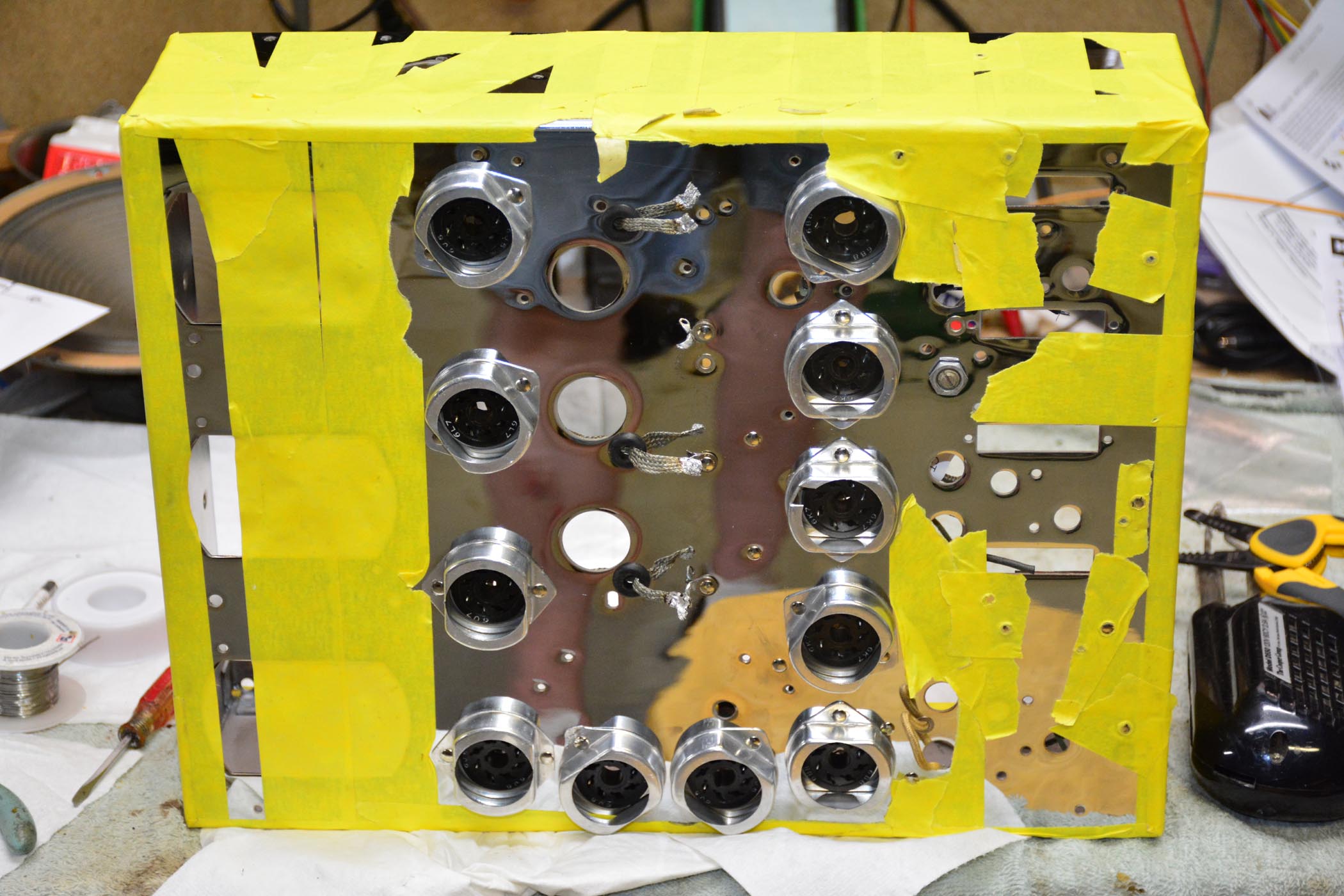

Thanks, Mike, for that info. There may be a few that I'll have to do that with. but this evening I got the first row of tube sockets riveted in without a lot of difficulty. The next row is a bit more difficult as the rivets are closer and the tube shield bases get in the way. Need to make some custom bucking bars to set the rivets. So far, only very minor, invisible damage.

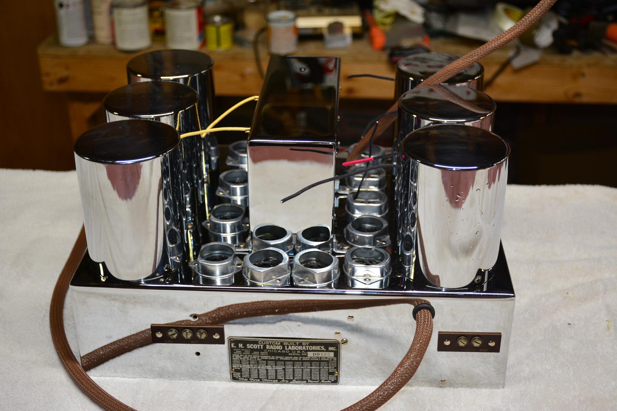

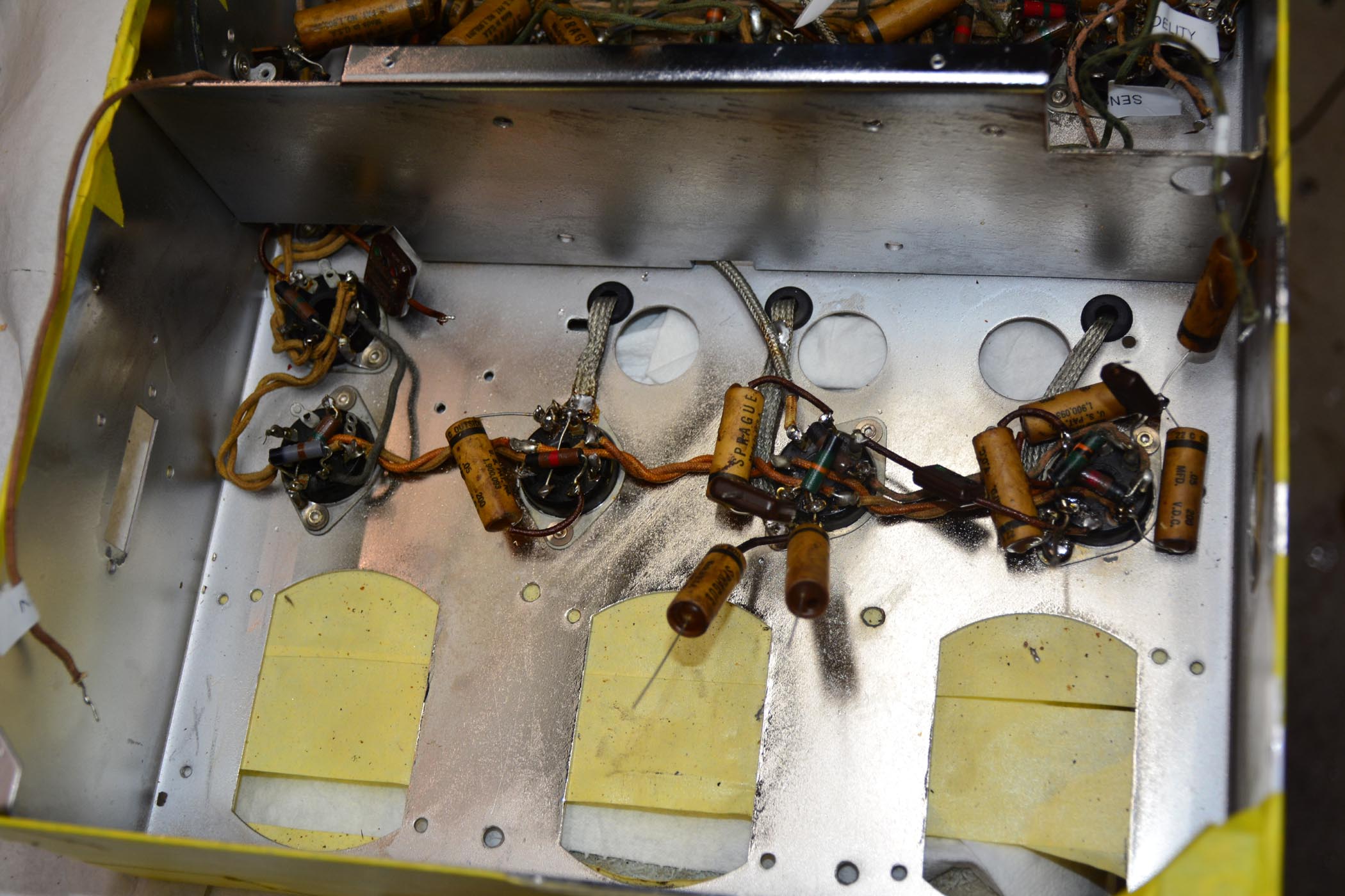

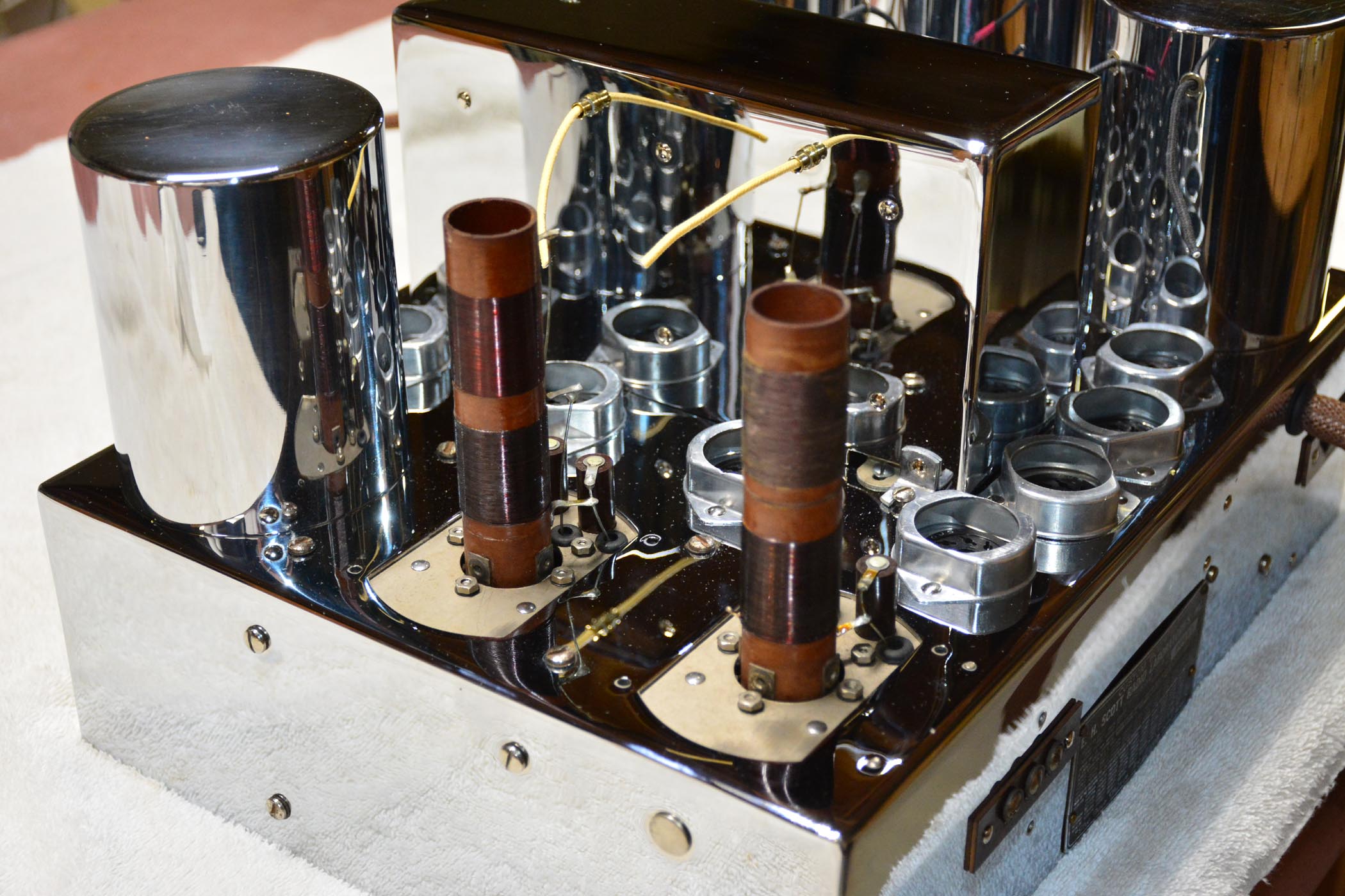

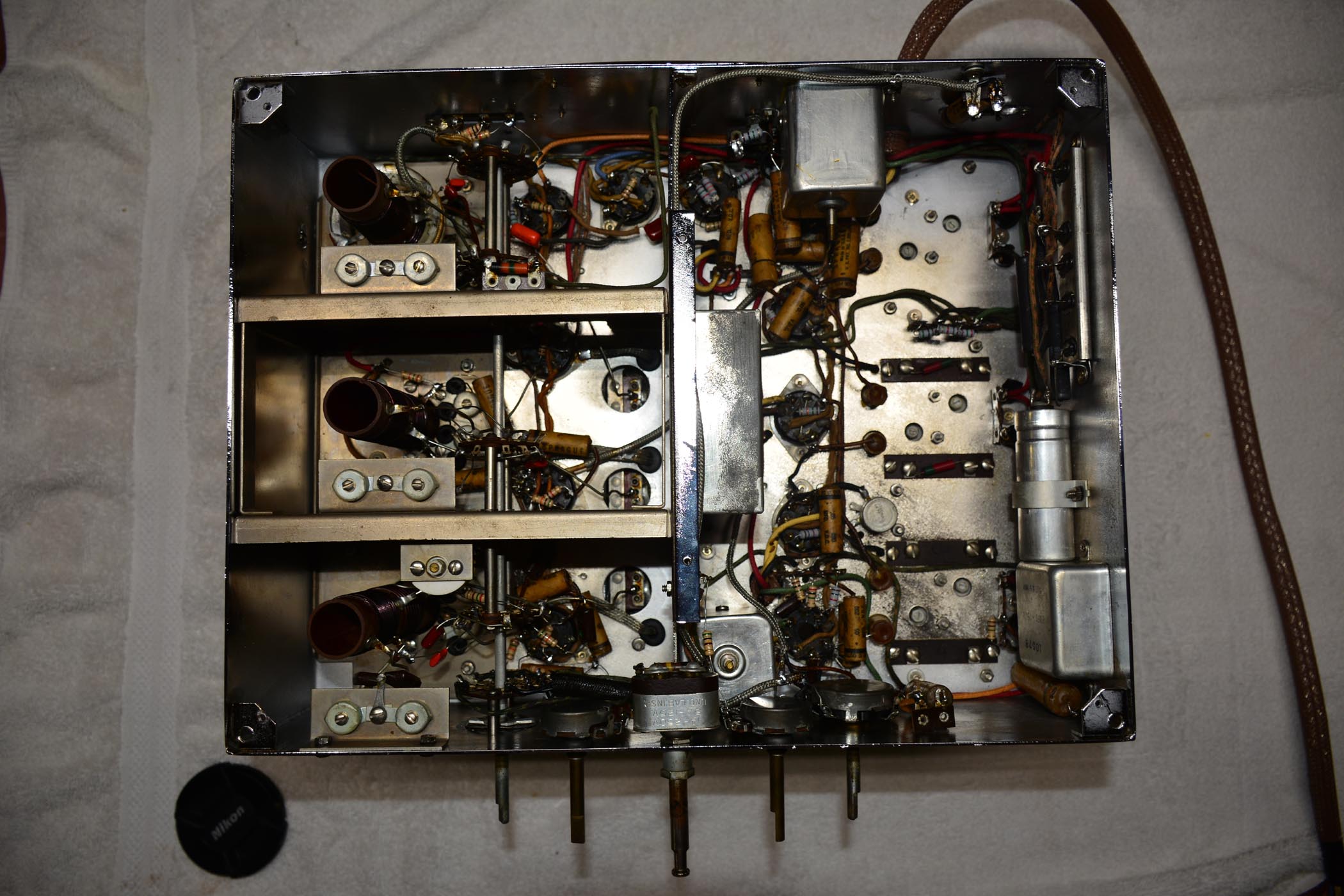

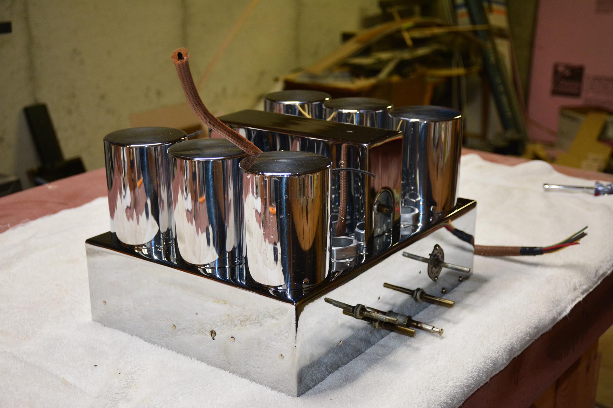

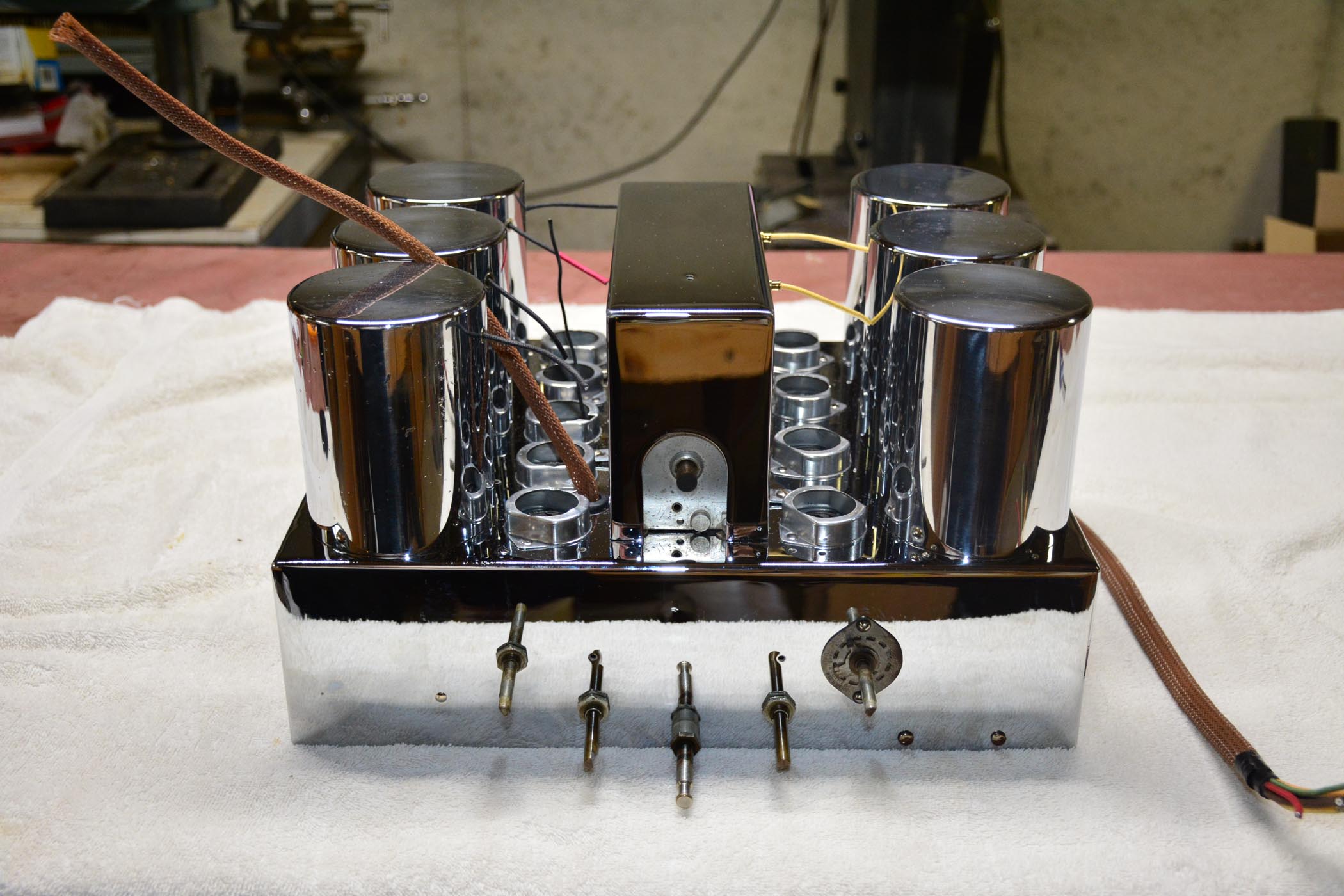

Here's where I'm at so far. Tube sockets and several terminal strips have been riveted in place. A few tubular caps have been re-stuffed with a lot more to go.
Chassis with some protective masking tape:
These caps re-stuffed and resistors checked:

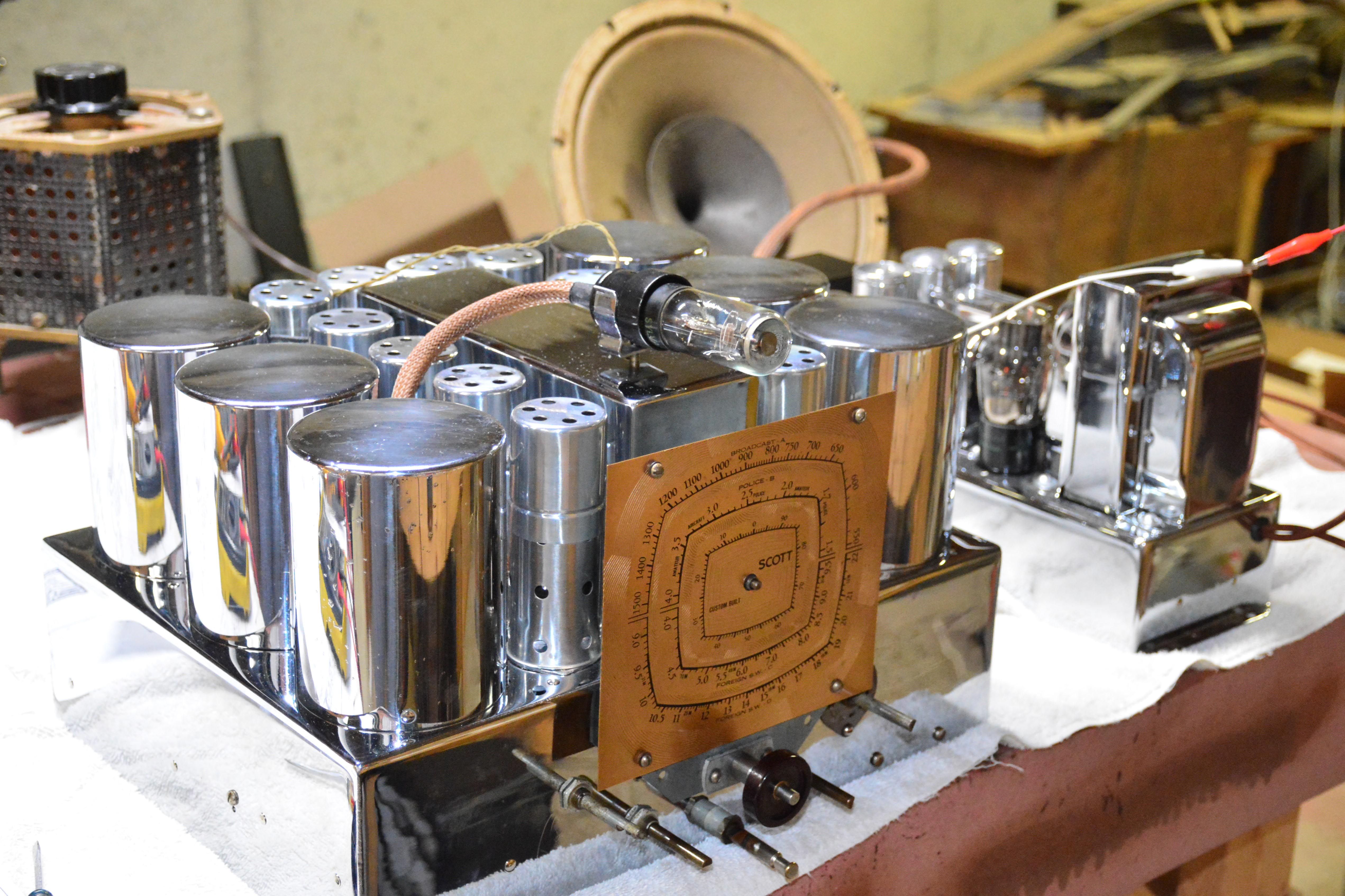

I love it when things work first shot out of the box! Powered it up slowly this evening. Started to get stations all across the dial at about 75 volts. Works great at full voltage with all bands pulling in stations. Now for a complete alignment and a few other minor things such as dial needle and dial lights. Then the cabinet. Nice to finally be this far.

The proper IF frequency for this radio is 465kc. I suspect it had been set at 455 at some point in time as I had to turn the trim caps a considerable amount to peak it at 465. Then, my dial was off by about 10kc. I've realigned everything and all bands now track very well. Things seem to work quite well. It sounds pretty good even with the speaker out in the nude. However, it's still AM with all of the associated noise. I like FM! Now I need to attend to the cabinet.

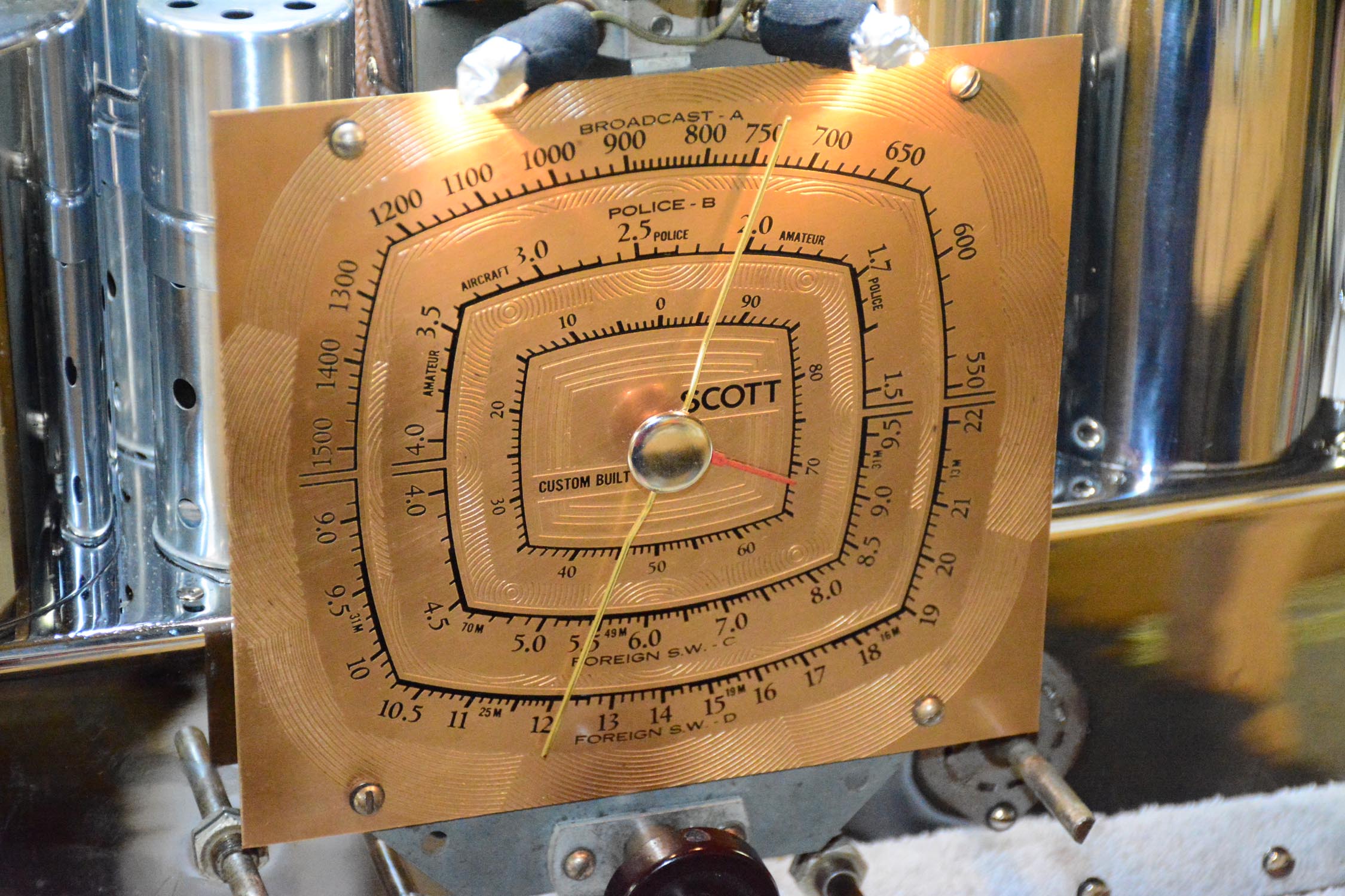

Until such time as I can find an original needle for the dial, this will have to do. It works and doesn't look too bad.

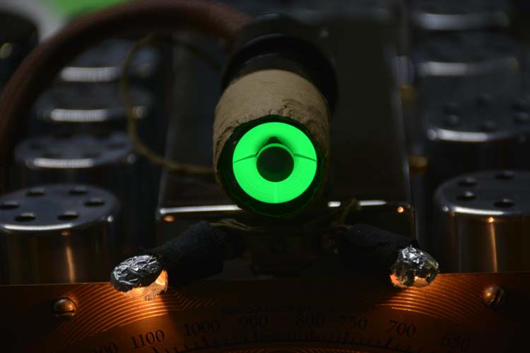

I needed a new 6E5 for this radio and found some cheap Toyo brand on Ebay. I decided to try them. It's nice and bright but the gain in the triode section must be pretty high. Most stations fully close the eye even though the control for eye sensitivity is turned all the way down! I should be able to modify that. Nice to have such a bright indicator.
