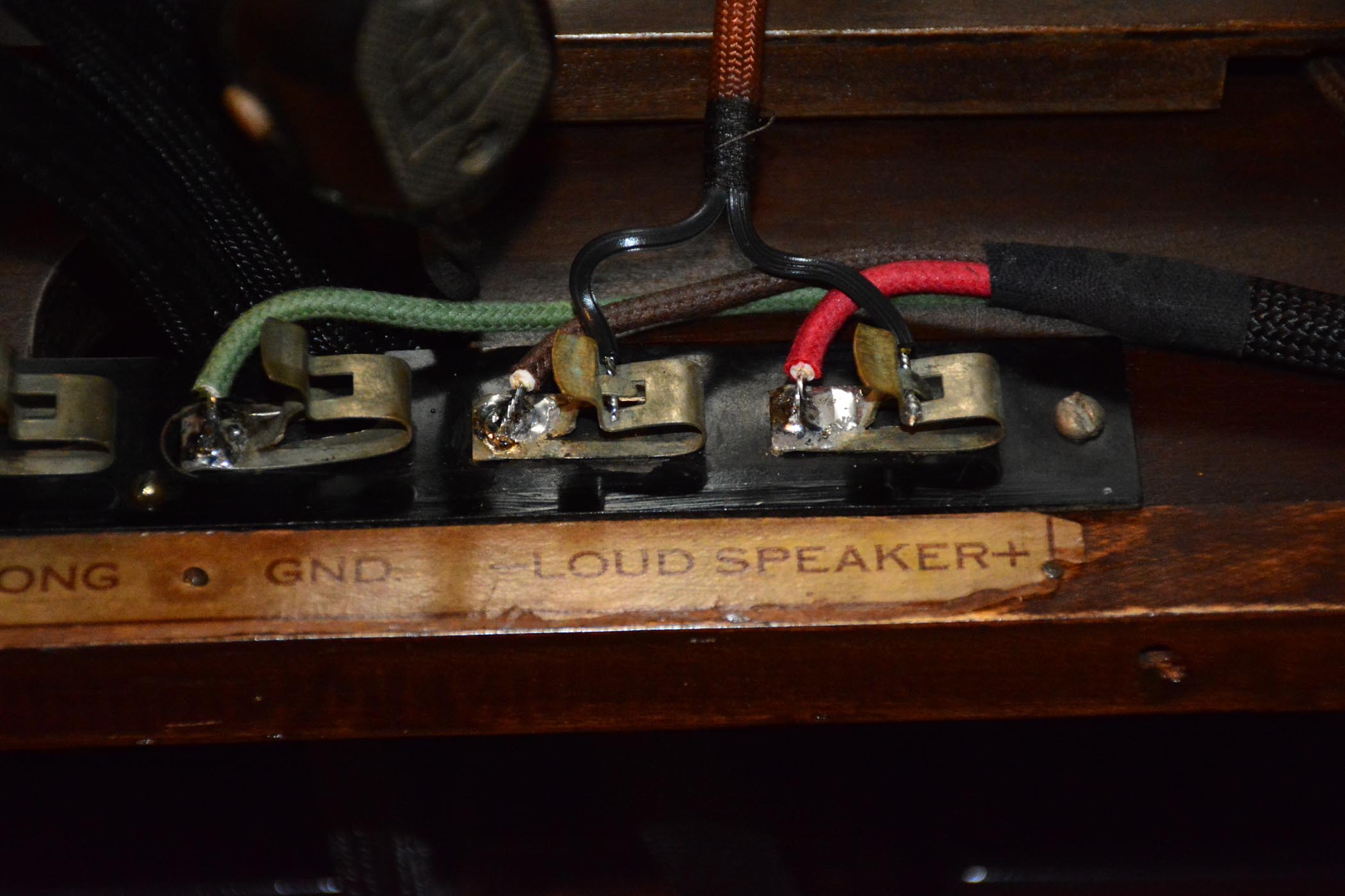

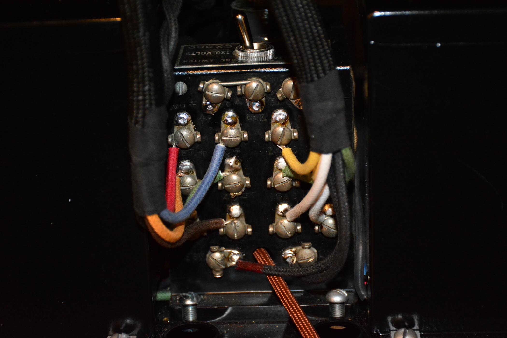

There is no doubt in my mind that this radio would far exceed all UL requirements for safety.  The top terminals are straight off from the rectifier,  The bottom 2 terminals go to the AC switch in the tuner section.  The speaker + terminal goes to the 180 volt power supply feeding the output TR, and the speaker - goes to the plate of the 71A from the output TR.  All are readily touchable in the back, especially the speaker terminals.  Looks good to me!

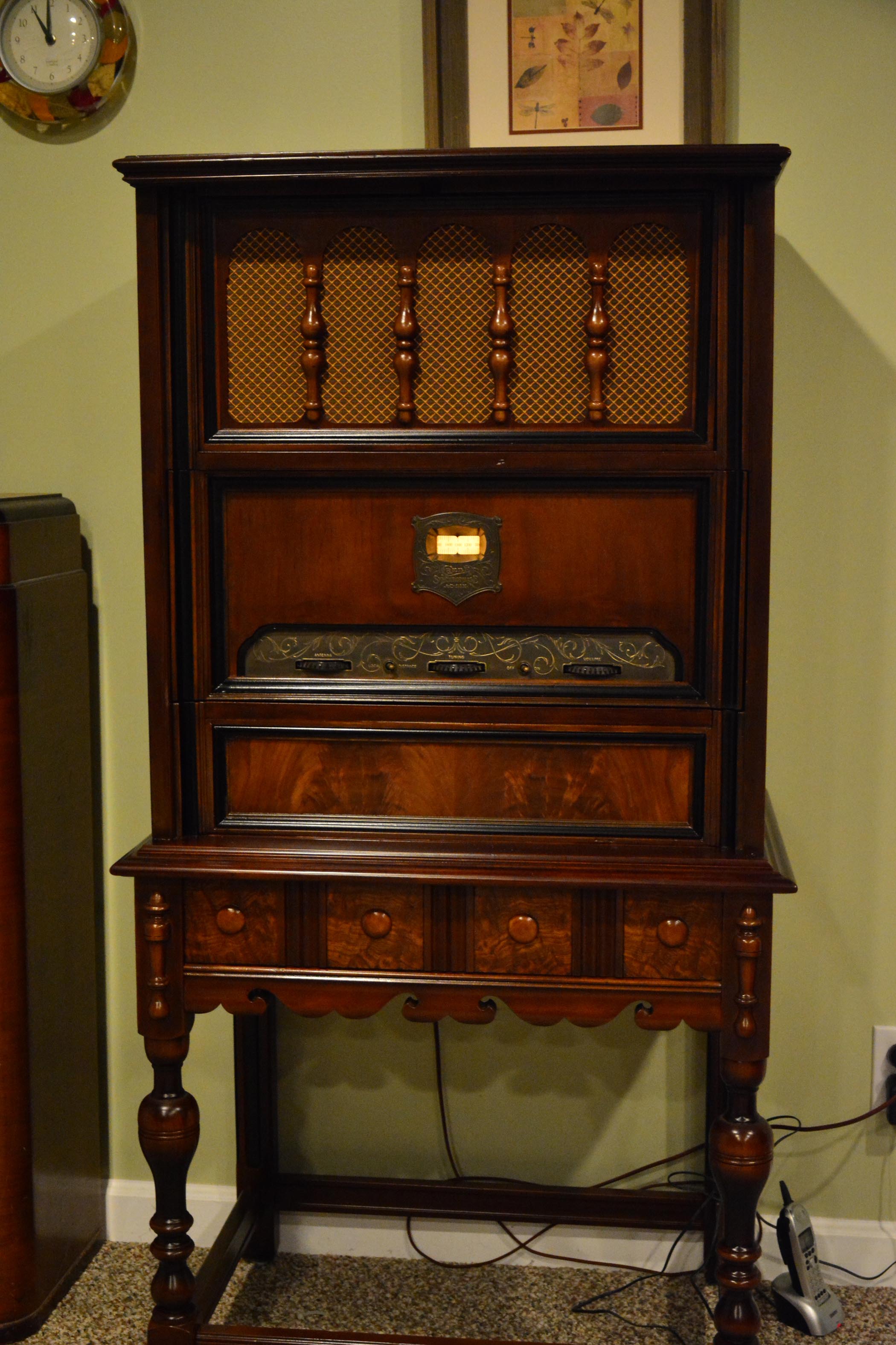

It lives again!  Got all globe tubes from FindATube - my tube tester rates them a bit below replacement levels, but they work.  Bob is great to work with.  One Cunningham CX326 drew enough grid current in the rf amps to pull the negative 4 v bias up to nearly 0 volts.  It must be a bit gassy.  It worked in the af driver position, but Bob is sending me another, no questions asked.
It certainly needs a bit of work yet as the hum level is a bit unacceptable.  I suspect the filament resistors to ground are unbalanced.  Only one is adjustable.  This radio certainly needs a long wire antenna as sensitivity is otherwise poor.  It's interesting that this radio has both a local/distant switch and an antenna adjustment.  It also seems to be more sensitive to noise from the line than the other radios I have.  Lack of AGC is annoying!  Getting all of the tuning caps to line up precisely is fun, and the very tiny bit of hysteresis in the linkage is noticeable when tuning.  I need to work on getting all 4 of the caps in the right position so that the hysteresis is not as noticeable.  Could be tricky.  While I'll probably rarely listen to this radio, it's kind of satisfying to take a fairly unique piece of history and make it work again.

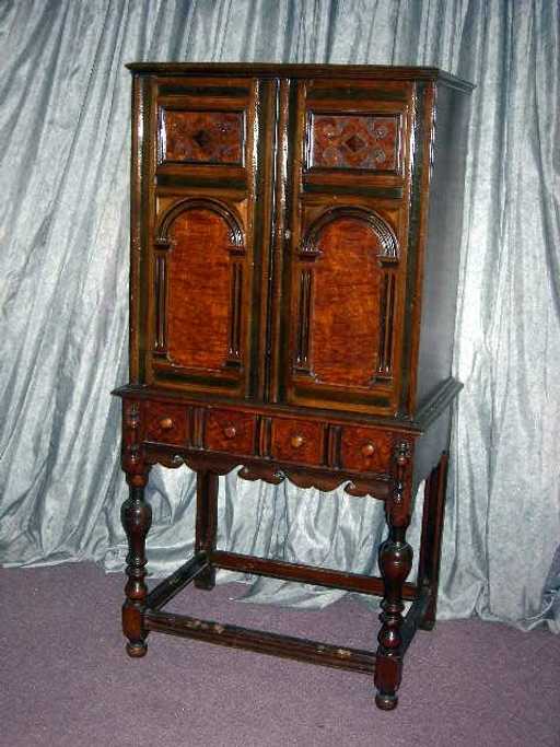

Wow! I just found a picture of this cabinet on line and I now know what the doors should look like.  I don't think I'll be duplicating them.  Turns out this cabinet is a Berkey and Gay made in Grand Rapids, MI. 20 miles from where I live.  I've been in the building!.  Berkey and Gay was one of the larger furniture manufacturers in GR back when GR was known as the Furniture City of the country.  They made various custom radio cabinets for various radio manufacturers.  This was not a typical cabinet for the Grebe but was a custom installation.  No wonder I couldn't find any pictures in any of the Grebe literature. Now I need to find another cabinet so I can get the doors.  This one sold w/o a radio a few years ago for $35.00.
