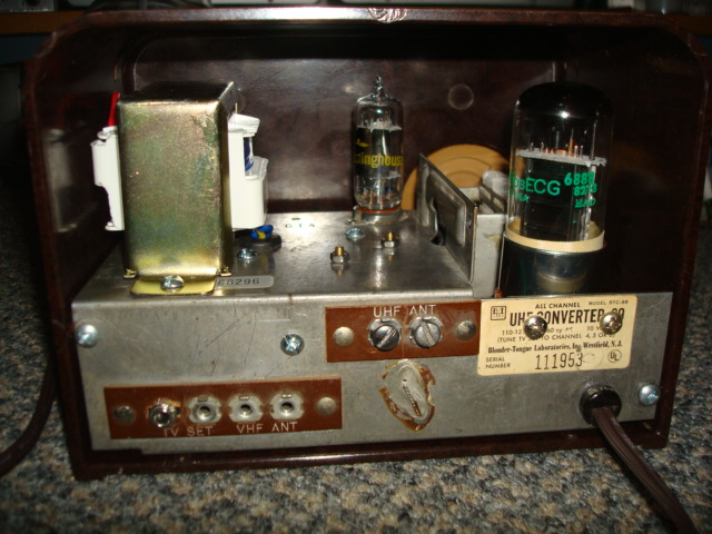

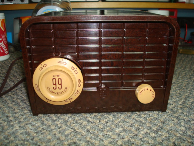

Here is the finished product. I still will do some refining, but it is working.
Tim
Posts: 2,574
Threads: 337
Joined: Jun 2013
City: lawrenceville nj
looks great tim
so when does production start
sam
