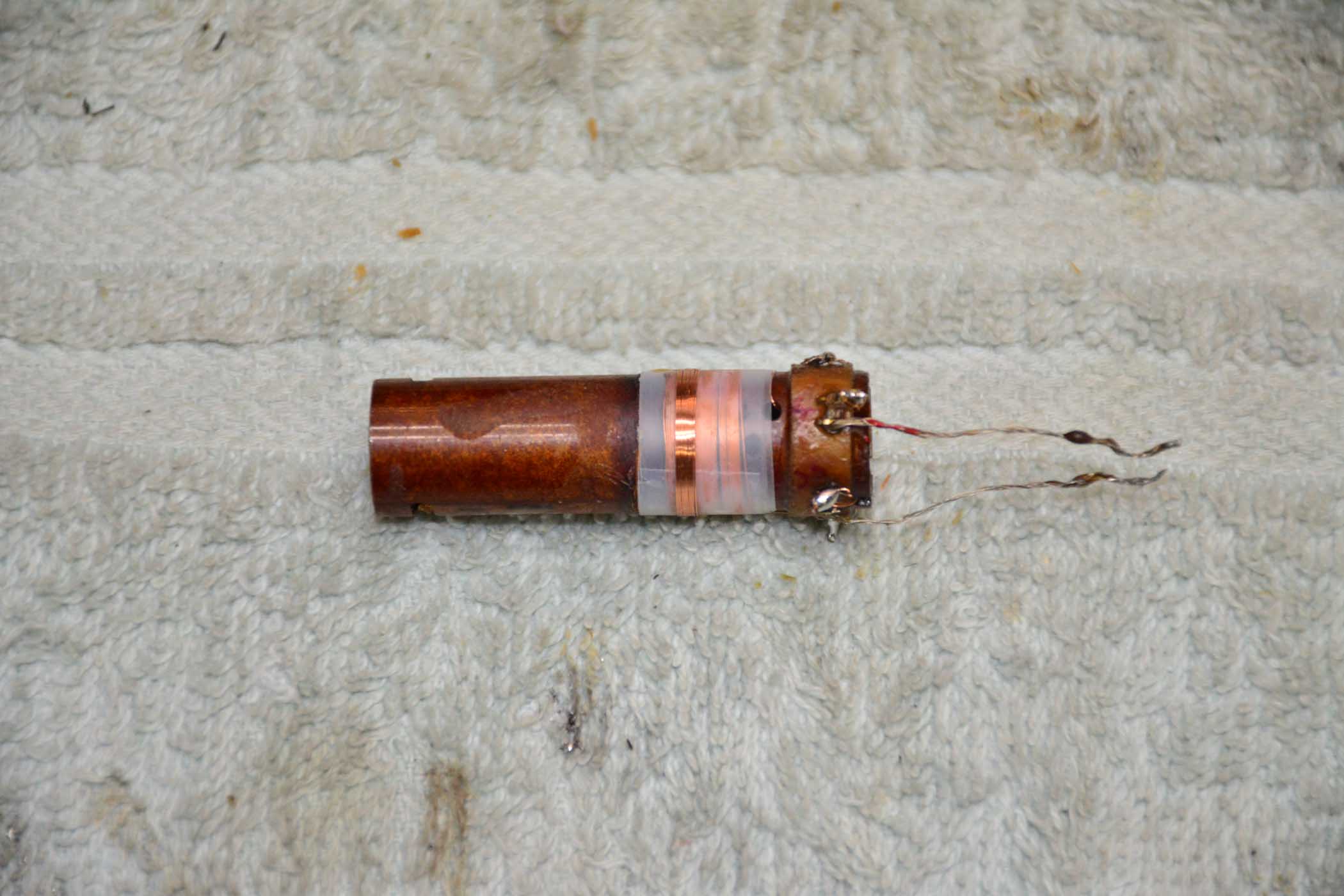

Excellent job on the coil! I have a question, on the 3 primary windings---is it one whole winding with taps soldered on or 3 separate windings wound side by side? I couldn't tell by looking at your repaired coil. Ken

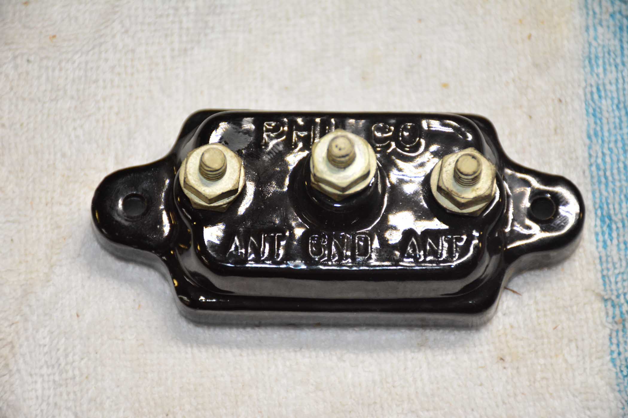

This was mounted in the cabinet. I presume it is a lightning arrestor?

Yes, it's a lightning arrestor. It has two antenna terminals and one ground terminal because it is the kind designed to be used with a dipole type antenna like the ones Philco sold rather than a single long wire, or monopole type.

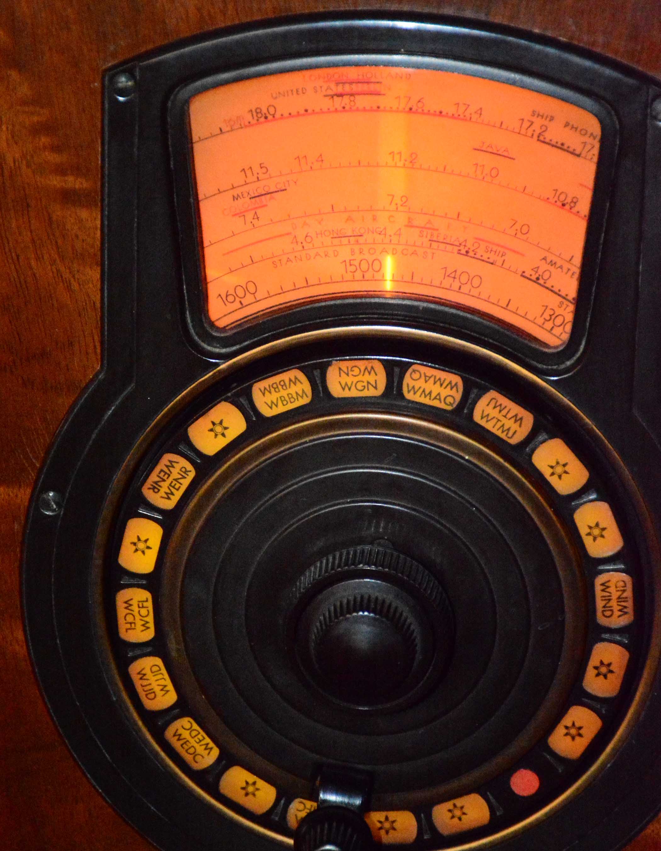

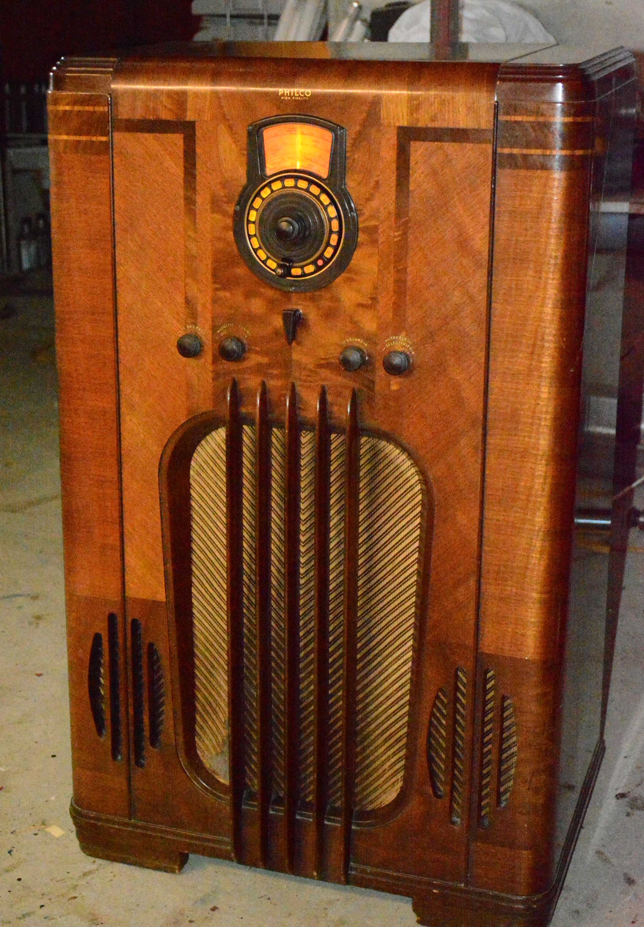

The radio is reinstalled in the cabinet. This is a good sounding radio. The bass and treble/selectivity controls seem to give a better balance than most of the other radios I've played with. Sensitivity is good and i can pick up a lot of stations on the SW bands.

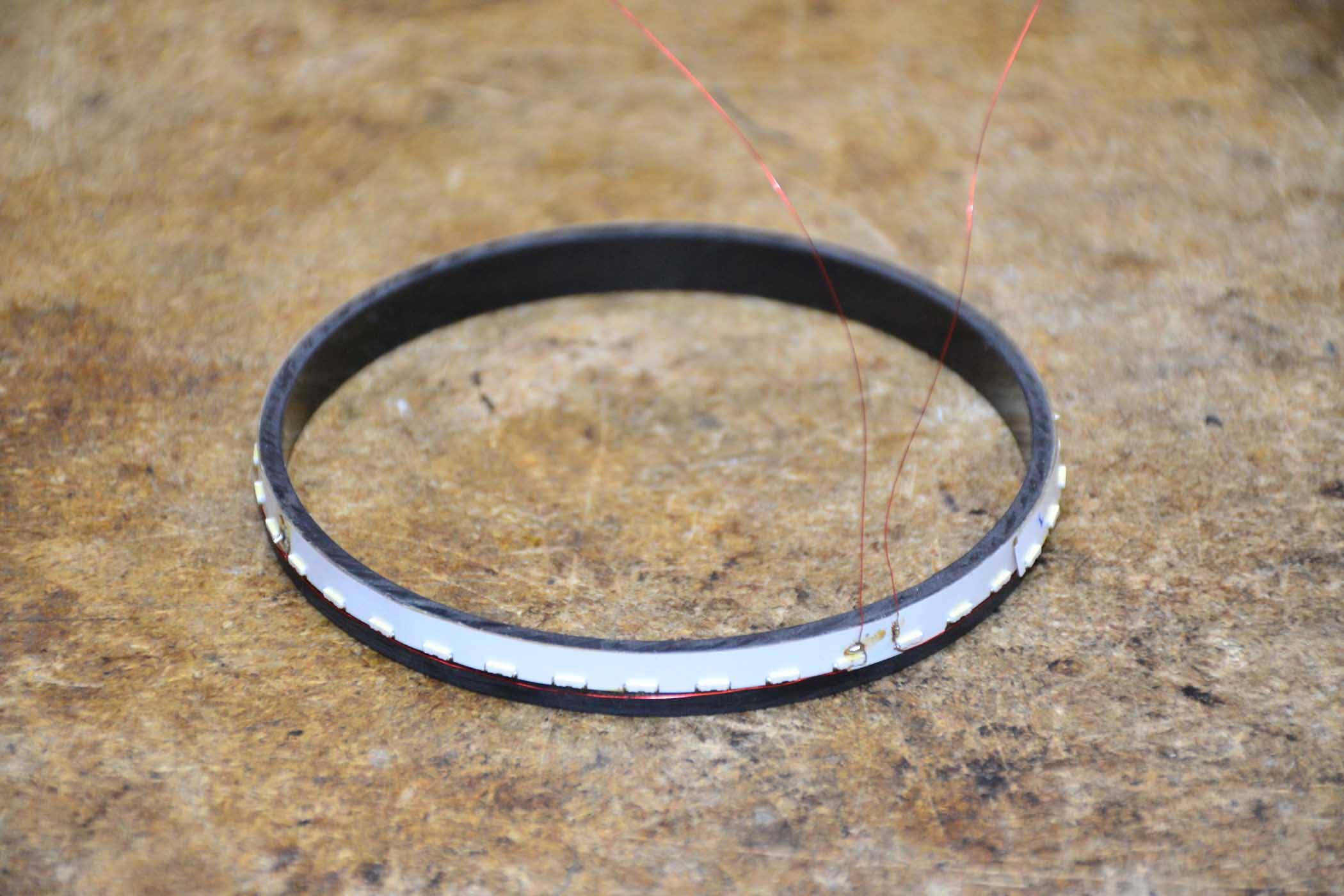

For grins and giggles I've been playing with the lighting of the dial. I'm using the LED strip from the back light of a laptop that I accidentally smashed behind my car seat. The LED strip consists of 40 LED's in 4 series sections. It lights through a 30K resistor from the -60 volt bias/field coil supply. Unfortunately, the color temperature looks to be about 5000K. Way too white so I need to put in an amber or red filter. Right now it is always on. I'll need to put a relay in there if I want it to switch with the magnetic tuning along with the flood lights. I'd rectify the 6.3 volts that feeds the floods but it would not be a high enough voltage to light the 10 LED strings. Brightness can be varied by changing the series resistor value. It'll light with a 75K resistor. The ring is between the shadow mask and the dial, shining through the gap in the dial and into the back side of the station selector ring. Not very original but I kind of like the effect. It's easily removable so I'm not too concerned about originality.
One final question for you finish gurus. This is a very nice cabinet but the finish is slightly checked and the grain is very slightly raised. Has anyone attempted to do a light sanding and then a coat of lacquer to fill in the crazing and cover the grain again? Or is there another way to get back to the smooth, glossy finish it originally had without a complete refinish job? Over the years the finish has lightened up a bit as the color is more brown under the bezel, but I'm not too concerned about that.
Aside from replacing the damaged grille cloth and maybe something with the finish, this project is almost done!

You can refinish any cabinet using the methods used for photo-finished cabinets, but you probably do not want to do so.

(02-12-2019, 04:26 PM)Kenradio Wrote: Excellent job on the coil! I have a question, on the 3 primary windings---is it one whole winding with taps soldered on or 3 separate windings wound side by side? I couldn't tell by looking at your repaired coil. Ken
I would like to know the answer to this question as well. If you could let us know that would be great. It is difficult to tell in the picture.

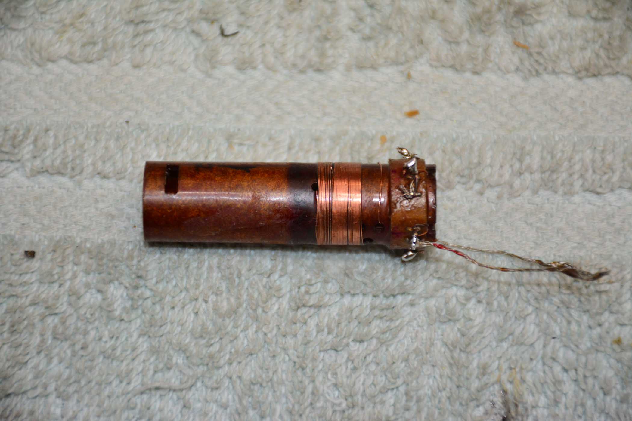

The primary winding is continuous with 2 taps. There is a hole in the form where the tap goes inside the form up to the terminal. The tap is not soldered on to the winding, instead the end of the first winding goes up to the terminal then back down to the hole and the second winding then continues. Same with the next tap. I guess you could say that is is 3 separate windings laid end to end or side by side. So, to confuse matters, there is a hole in the form for the 2 ends of the winding, and for the 2 taps. The secondary wires go to the terminals external as you can see on the photo. Hope that helps! (Sorry Kenradio, I missed your previous post!)
Rob

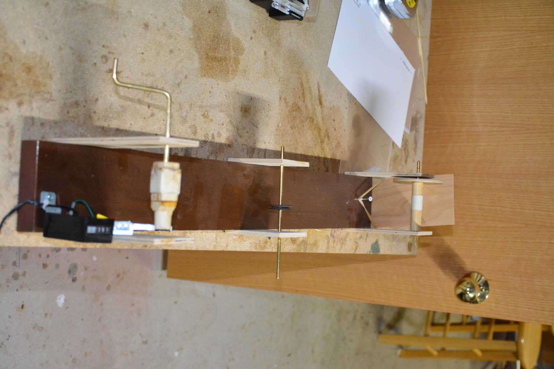

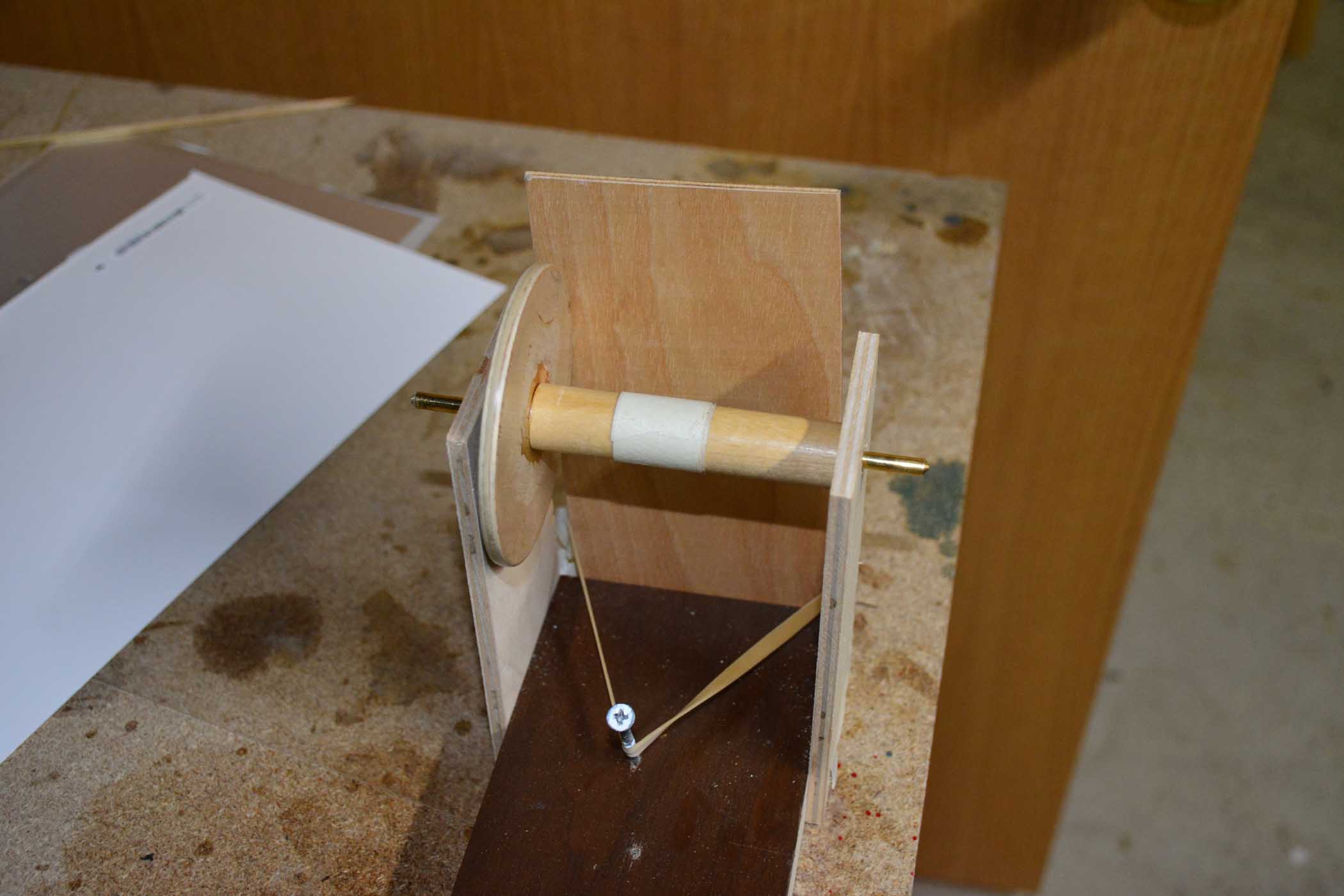

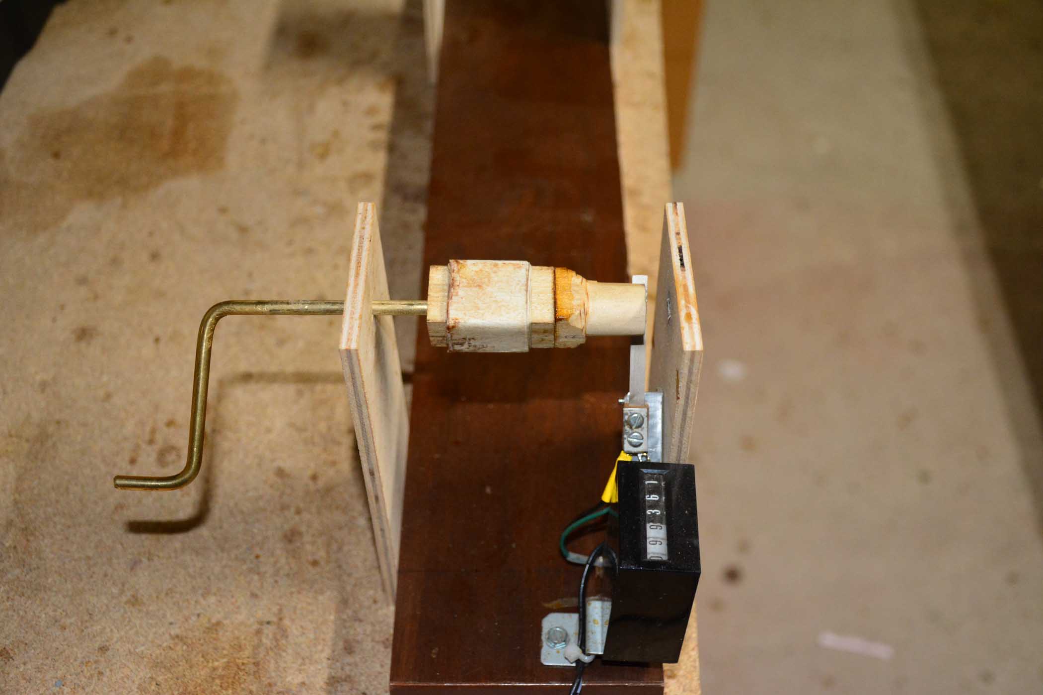

An addition: Here are a couple of photos of the coil in process. You will notice that the last section of the primary does not lay nicely. this is because I found a cross over in the wire and I had to unwind and then rewind by hand instead of on my coil winding setup. This may also account for the fact that I needed to add a bit of capacitance to the compensating capacitor.
(This post was last modified: 02-14-2019, 06:03 PM by rfeenstra.)

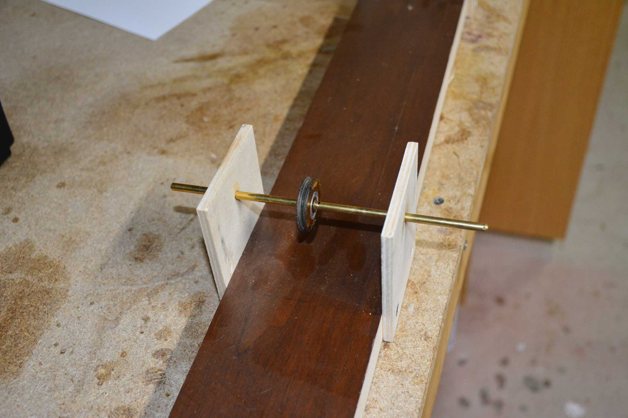

Very neat! What sort of coil winding setup do you have?

Maybe this is why my attempts at rewinding those band 2 coils from 1937-38 5-band Philcos never worked - I do my coil winding the hard way...by hand.

I did mine by hand. At only 36 turns, the coil winder takes too long to set up compared to winding by hand.
I also did not use the separator, rather winding right on top. Maybe that accounts for the decreased capacitance.
